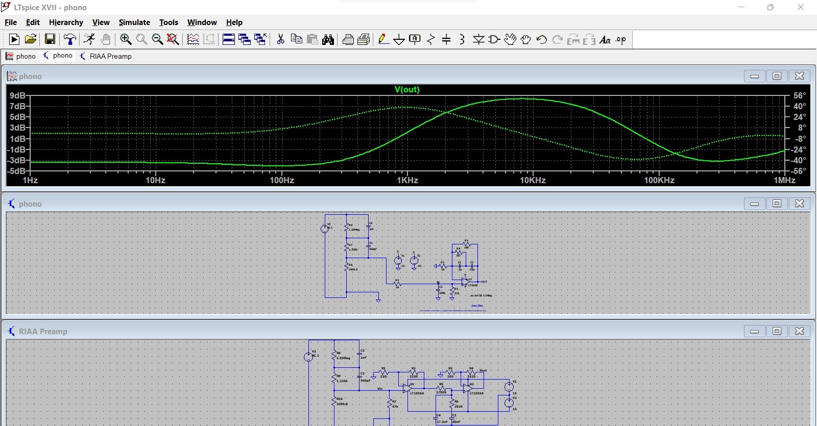

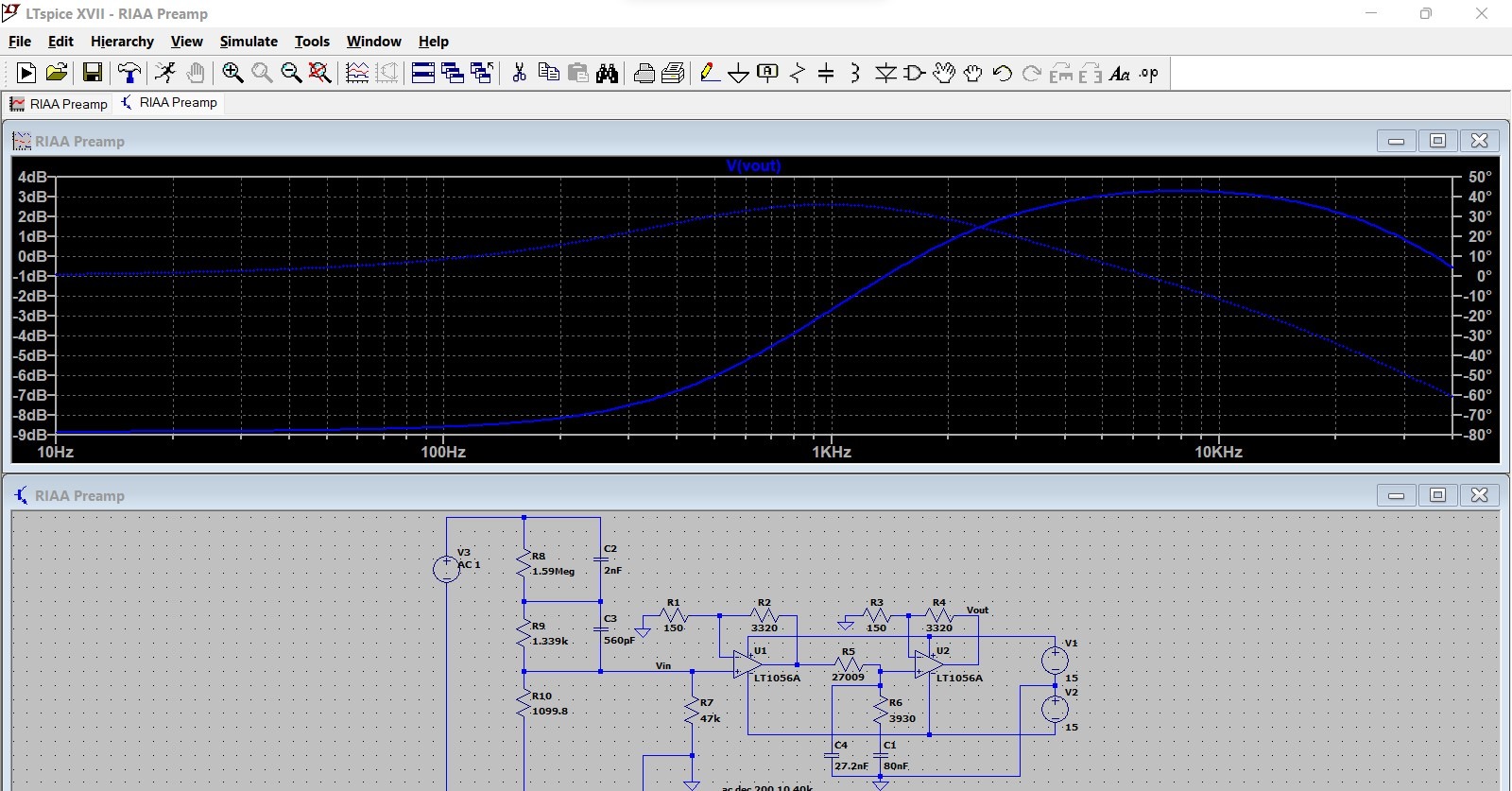

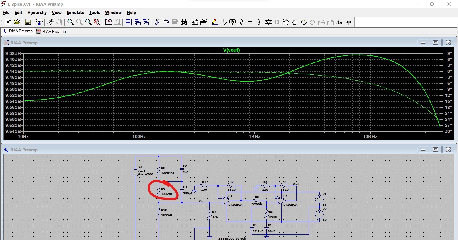

Hi All. I recently bought a Phono stage RIAA board from EBay. It does not work at all well. I then realised it was based on a published design by TEXAS Instruments of which I show the schematic. With a quick calculation you should see something very wrong with the overall gain apart from the response curve differing far too much because of rounded up component values. Who can spot the biggest mistake? View attachment 1029997
That circuit is too simple. The Oamp's feedback circuit is just two identical resistors, 3320 Ohms and 150 Ohms, on both levels, so it's natural that the sound isn't good.
That makes no sense at all. Low impedance feedback will keep noise down, and is inherently linear. The RIAA is all in the passive network between the stages.That circuit is too simple. The Oamp's feedback circuit is just two identical resistors, 3320 Ohms and 150 Ohms, on both levels, so it's natural that the sound isn't good.
