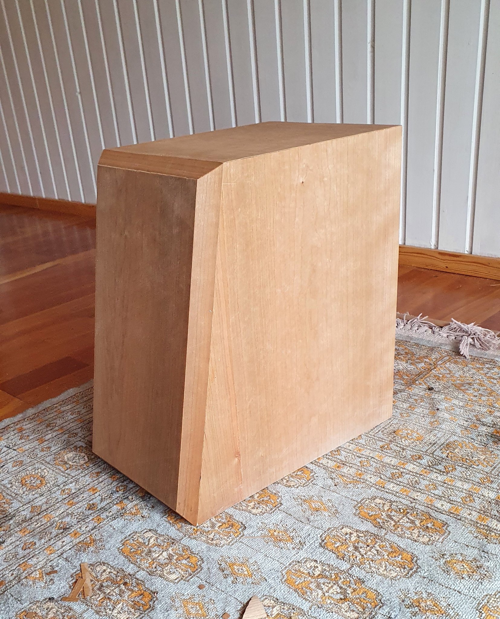

Im actually building spruce speakers right now, cherry veneer over it and not yet finished.

Spruce is a very good wood for loudspeakers. It’s light and strong, and when properly dried is very stable. You may want to make your box fronts and sides a little thicker, 1” or so, than you would with a hardwood like oak or maple. I like spruce, I think it’s underrated as a furniture wood. If quartersawn it will be exceptional in appearance and strength per weight. Having said that, you can make great loudspeakers from Home Depot studs if you have the time.

mmh wel if quartersawn, properly dry (les than 12% humidity) it is possible,
be aware that the wood moves in in orientation of the grain differently,
this is important for you cabinet design, and choice of grain direction depending of the position of the piece.
this shows the measurement differentes in % of the hohle piece per 1% humidity change
screrws or glue will not prevent the wood from moving, it will just crack the glue / wood or screw.

Wood | tangential | radial | longitudinal | |
spruce | 0,33 | 0,16 | 0,01 | |
pine | 0,29 | 0,17 | 0,01 | |
oak | 0,35 | 0,20 | 0,01 | |
beech | 0,45 | 0,22 | 0 |

So 1" thick should be safe?Hmm, spruce MOE = 550 ksi (0.789 m psi)
'Our' typical ~0.75" no void BB plywood MOE = 1.8 m
0.75*(1.8/0.789)^0.33 = ~0.9846" (~25 mm), so 1" thick works for me and* as long as the Maple is no void.
Or thicker is better?
I want to use this plywood in 3/4" thick for the front and rear.
https://userweb.117.ne.jp/y-s/base-12P-e.html
Then 1" thick spruce for the box
Any thoughts?
Any thoughts?
