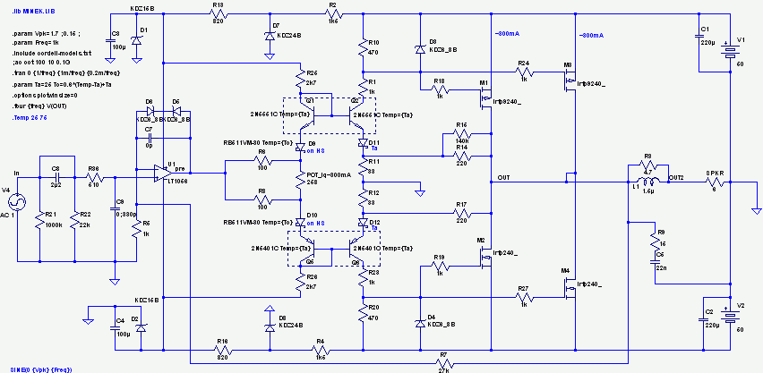

Ian, I have been interested in a power buffer and Nelson’s F4 meets my criteria. Can your square-law approach be implemented in such a simple open loop buffer topology ?
To mitigate the risks, I would overcompensate the thermal compensation.
I would redesign the base spreaders as Vbe multipliers, this allows overcompensation if required.
It is even more overcompensated, but it will probably be needed in reality
So in this method, how/where these transistors should be mounted
to track temperature?
Would this work better than 4 extra Schottky diodes?

So in this method, how/where these transistors should be mounted to track temperature? Would this work better than 4 extra Schottky diodes?
Hi minek123,
Since you mention Schottky diodes I assume you have seen the circuit attached in Post 18. For convenience of all I'll put it below:
My simulation shows two Schottky diodes give enough static thermal compensation for the 50V rails with two pair of HEXFETs.
I still need to do a dynamic thermal simulation to find a thermal rating suitable for a practical heatsink. Until this simulation is done we can't be know if this 50V amplifier is thermally stable (or not) without source resistors.
If all looks well I should do a 50V bench test with two pair of well matched N's and a pair of P's. But I don't know if I have such a pair on hand at the moment. I'll have a look soon. Then I can try different mounting spots for the Schottky diodes for you.

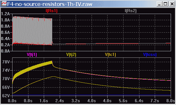

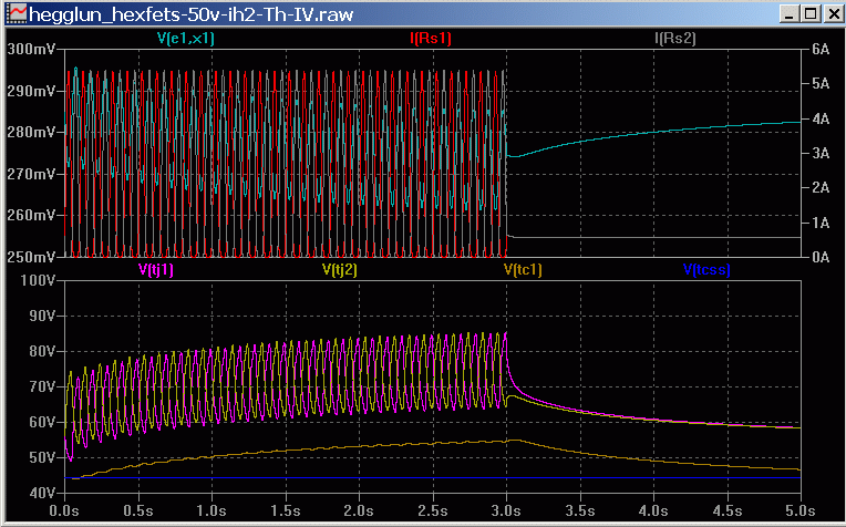

This first stage for a dynamic thermal simulation now working. Files attached. Circuit below and a plot. (Heatsink time constant accelerated from 1ks to 1 second).Hi All,
...I still need to do a dynamic thermal simulation to find a thermal rating suitable for a practical heatsink. Until this simulation is done we can't be know if this 50V amplifier is thermally stable (or not) without source resistors.
There are actually two pairs of IRFP240/9240 in parallel (using the 'm' area scaling factor). Idle current is as before 300mA per pair. The Schottky diodes sense the MOSFET case temperature and offsets the 25C diode voltage by -1mV/C. There are source resistors that are used if the simulation overheats and would need them. In the plots above the source resistors are disabled and you can see that it is stable both at startup (initial idle condition) and when running at high power for a while. When the signal stops you can see the diode voltage V(e1,X1) rises again but the idle currents I(Rs1) and I(Rs2) stay almost the same and at the same as the initial idle current at the start. if the heatsink rating is too high there is thermal runaway from the start by solving the steadystate operating point. If you change Rsa to more than 0.6 degC/W for two pair (eg enter as "1.2/prs") and it should crash on start with ridiculous Tj's and currents. That's as expected in real life. Then increase Rs to see if it can be made stable with source resistors.
In this simulation use Vtrim parameter to set the idle current. This is an offset voltage needed to make the thermal model start at the same as the standard model would at starting 25C. The Vtrim is not part of the build just a software tweak to get it to match the previous fixed temperature simulations.
The subcircuit is complicated and needs a tutorial paper to show how to use it and how it works. It was keantoken's idea and I helped develop it over the last 5 years; now updated to run with the new LT-XVII VDMOS model temp-cos. So far I have only run it on LT-IV but hopefully it should run as is on LT-XVII as well. So far I only have Exicon laterals and the IRFP240 in the attached thermal model file.
I see ngspice has a similar inbuild VDMOS model that can do this type of thermal simulation (without a subcircuit). I am still learning to use ngspice so I can't provide any thermal files for this circuit for ngspice at least for a while.
All the best with this simulation.

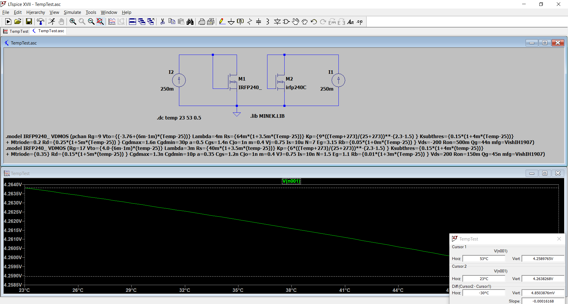

I have measured a real transistor, because the models looked unreliable.
The measurement confirms my suspicion: I swept the temp from 23°C to 53°C, using this test setup:
The sim for both models shows a variation of only 6mV, but in reality it was much higher: 115mV (from 3.920V to 3.805V).
That's an average tempco of -3.83mV/°C.
It is not possible to use a sim to determine the best strategy if the models are unable to reproduce this behaviour.

Elvee, please note that Ian is using different models - not the ones from my lib,
but models that he attached directly to the .asc file.
Not sure what is the difference, but I'm assuming Ian's models are better.
I do not know which models he uses in the files he provided, and more importantly, how he uses them.
If Ian himself could include his model (I only tested the N member) in the very simple test setup I gave, that would be the most reliable comparison method.
The models I used are different to Bob Cordell's and the inbuilt IRFP240 in LTspice. Neither of these two sources provide the required temperature effects on threshold voltage and Kp (transconductance) for these power MOSFET's.
My IRFP240 and IRFP9240 models are embedded in my sim files and include appropriate temp-cos, eg Post 5 here https://www.diyaudio.com/forums/attachments/solid-state/847501d1590462986-square-law-amp-hegglun_hexfets-35v-ih1-zip
Bordodynov now has all my latest VDMOS models and is integrating them into his library (his old version link here Installing and using LTspice IV (now including LTXVII). From beginner to advanced.). When he has posted the updated mosfet library I can post a note on this thread if you like.

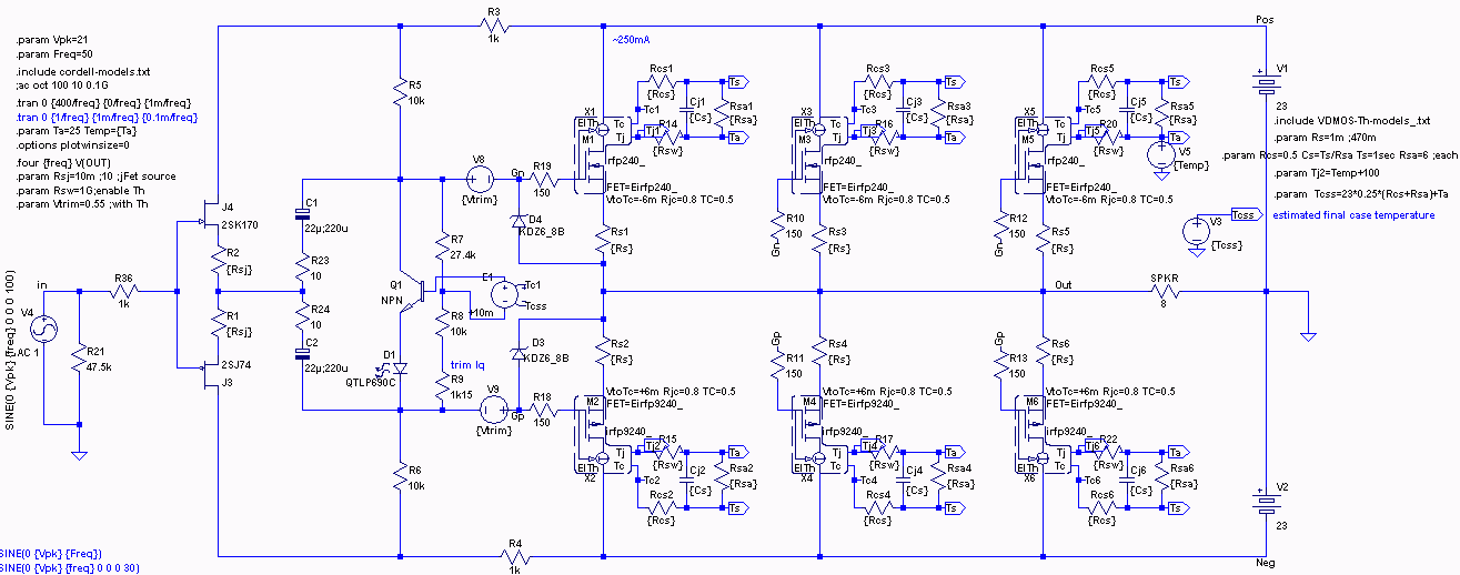

OK so to see what is possible the attached thermal simulation allows the source resistors to go to zero and the idle current reduced for square-law mode which is half the standard bias. The thermal simulation allows the heatsink temperature to be assessed as the heatsink size is changed. And whther the heatsink is too small to stop thermal runaway without source resistors.
This circuit doesn't have all the exact F4 parts but is close enough for now to simulate the thermal effects and likely distortion (including thermal memory distortion). I did not have the TL431 (adjustable zener) model so I have made my own using a BJT with a programmable temp-co. (for evaluation only not for a practical build).
I found the capacitors across the bias generator needs to be reduced and series resistors added to get the simulation to work. The plot below is with 250mA per pair, then a burst at full output swing, then no signal to see watch the transient decay. The bias temp-co hsa been chosen so 1) thermal runaway is prevented, and 2) the transient is not over-compensated too much.
BTW the heatsink is 'Rsa' which is the portion for one device. The overall heatsink rating will be Rsa divided by the number of devices or Rsa/6 in this circuit. The attached sim is set for Rsa=6 which means the overall rating is 1C/W for the amp -- maybe a bit small heatsink since the temperature gets close to 80C after running at full output for a while -- but still it does not appear to go to infinity (thermal runaway) - it flattens off so is safe with no source resistors with this temp comp and small heastsink. Obviously a reality check is needed (bench test) to see if the simulation is realistic😱.
A quick check on THD with square-laws showed lower distortion than the manual. In driver stage also can be set for no source resistors for reduced distortion as well.
This is mainly as a demo so you can try variations using thermal modelling. BTW the ngspice site has a tutorial on thermal modelling ngspice tutorial for electro-thermal simulation

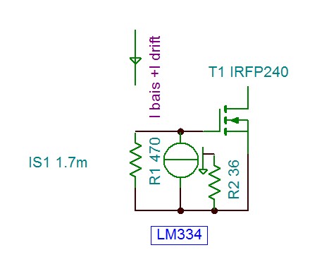

Hello Ian.
You are torturing yourself with complicated thermal stability , where as it is very simple. The LM334 is temperature dependent current generator . It's reference voltage drifts 0.23mv/°C. by this the current drifts in the 227ua÷R.
example, you have 470 ohm gate-source resistance and you want the voltage drifts by -3mv/°C. Than the LM334 must increase it's current by 3mv÷470=6.38ua/°C than the R=227÷6.38=35.5 ohms . The extra current the LM334 will draw is about 1.7 ma.
All you need is to install the LM 334 +R on a small pcb along the 470 ohms and the protect zener and screw it upon the MOSFET where the LM334 is inserted on either half circle groove , and the two terminals of the circuit are soldered on gate and source. By this you get a single element. To try it out , you need to bias the transistor in the air with a power supply and heat the transistor with a soldering iron on it' drain pin and fine adjust to keep the current constant while heating up.

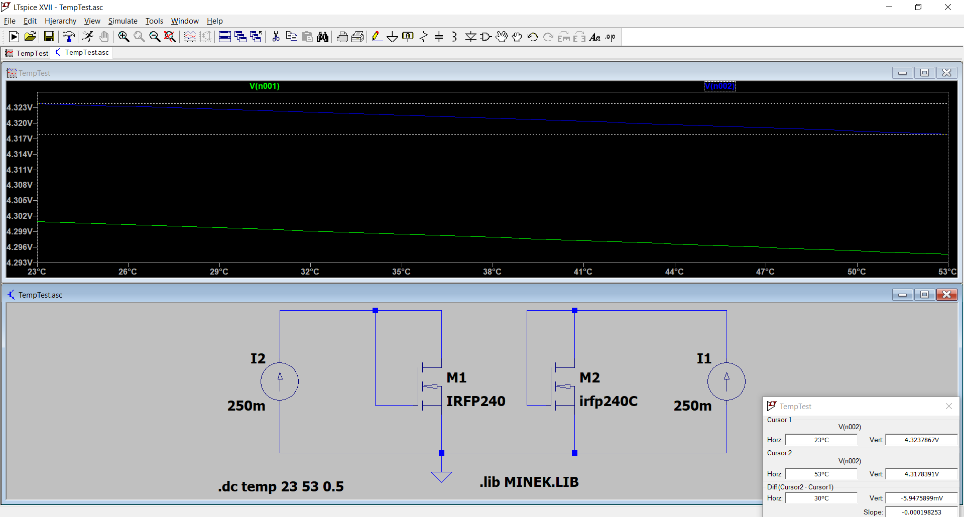

LTspice gave a warning, but the result is even worse: the total variation is now 4.8mV
Oops - updated circuits attached

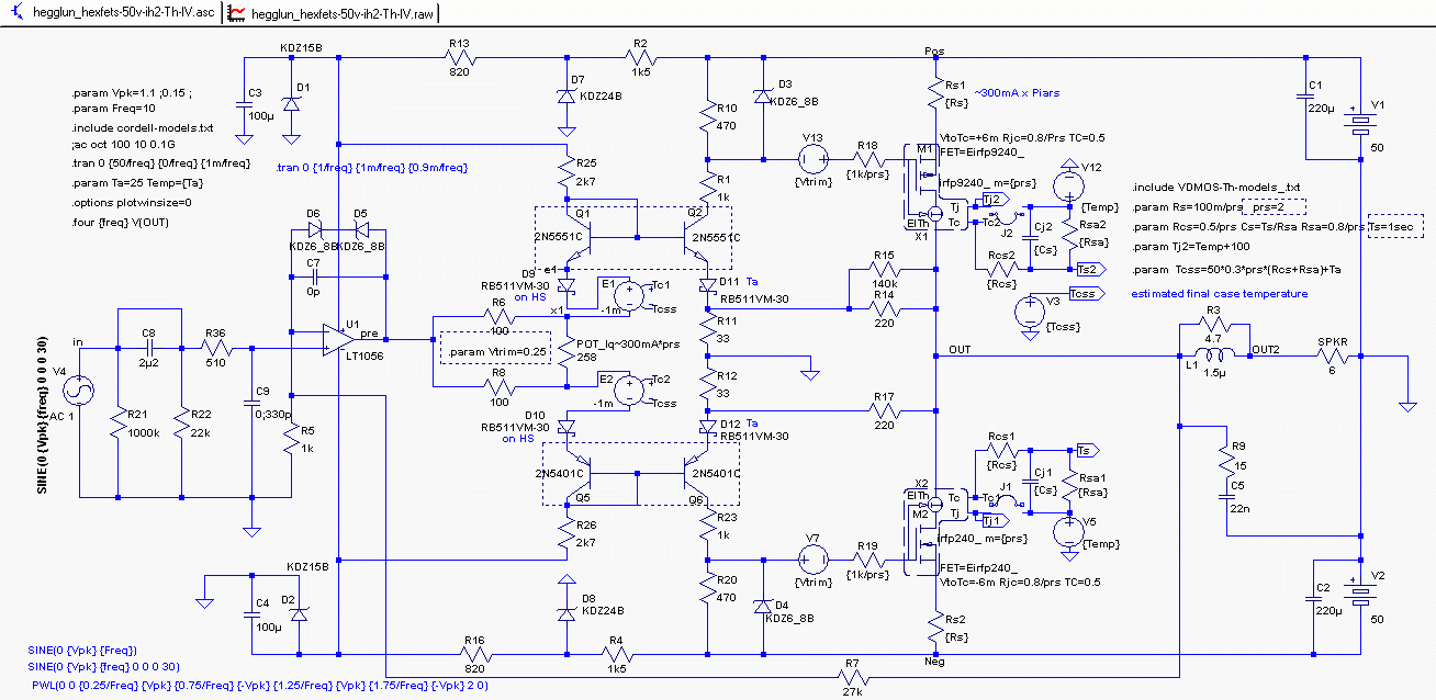

Oops, I found a few bugs😱. Sorry. The attached "F4-no-source-resistors" file has corrections. Delete the earlier file if you downloaded it. The Thermal model file is updated (with new name).
Changed: sense point for the bias sensor to the heatsink (was on the MOSFET case). It is still stable with no source resistance and 1 degC/W heatsink. Output still 25W into 8 ohms, bias 250mA per pair (750mA total), about the half original bias and heat, thanks to square-laws.
Yet to add the bootstrap parts and the TL431 (and a thermistor?). Anyone interested?

Well, a bug was in the models file, so this simulation was affected too😱.
Attached is the corrected "hegglun_hexfets-50v-ih2a-Th" file with the corrected model file. Delete the earlier file if you downloaded it. Sorry for that error.
Changed: sense point for the bias sensor to the heatsink (was on the MOSFET case). It is still stable with no source resistance and a 0.5 degC/W heatsink. Idle current is 300mA per pair (600mA total).
