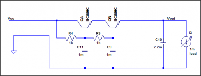

You can repeat another Cmult after the first in series. This thing makes 108dB kill @ 100HZ. After that mod whatever remains for hum is surely whatever it picks from cables, layout, & environment. Also whatever will remain for hiss it will be whatever the MC stage self produces, no doubt. Keep it nearest to the MC stage possible and use twisted pair cabling.
Add another 0.6V to the 317 output to compensate for the second cell loss. 1m and 2.2m mean 1000uF and 2200uF respectively. Vcc is the 317 output point.
P.S. Add 1k across the 317's output since it needs a minimum current to work well.
