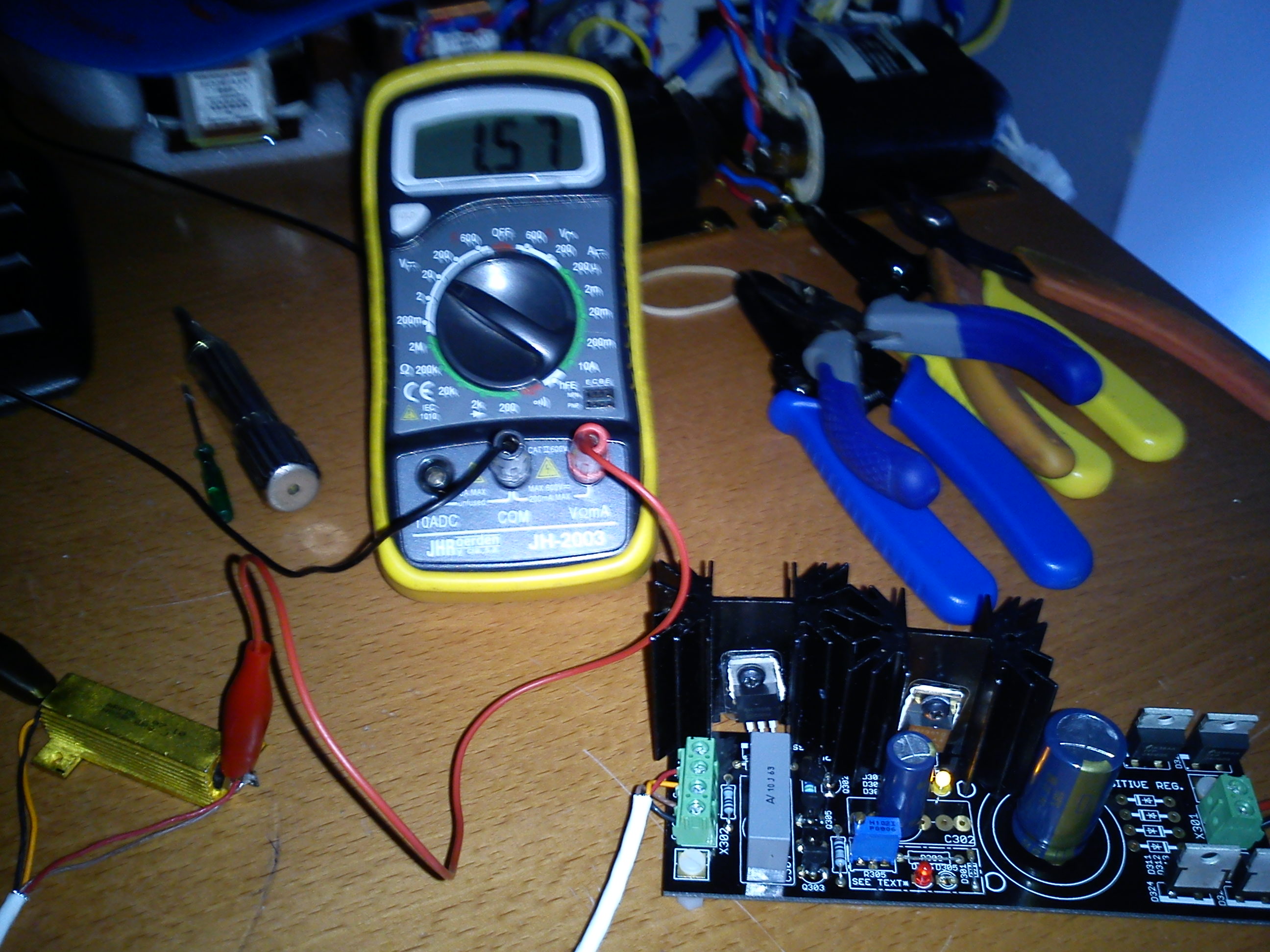

Thanks for the tweak, I have problems to get targeted Vout +3.3V
-Tx 9VAC 1A
-Vref 1red LED + 1K trimmer, rest jumpers
-R306 27R
-Smoothing cap 4700uF 16V
-R301 12R (Vout +0.696) trimmer don't adjust the Vout is fixed +0.696V) I tried with R310 3R9 (Vout +1.57) but still trimmer don't adjust the Vout is fixed 1.57V
-Dummy load 6R8
Pic show +1.57Vout with all LEDs lit but when changed R310 to 12R the red LED don't lit
