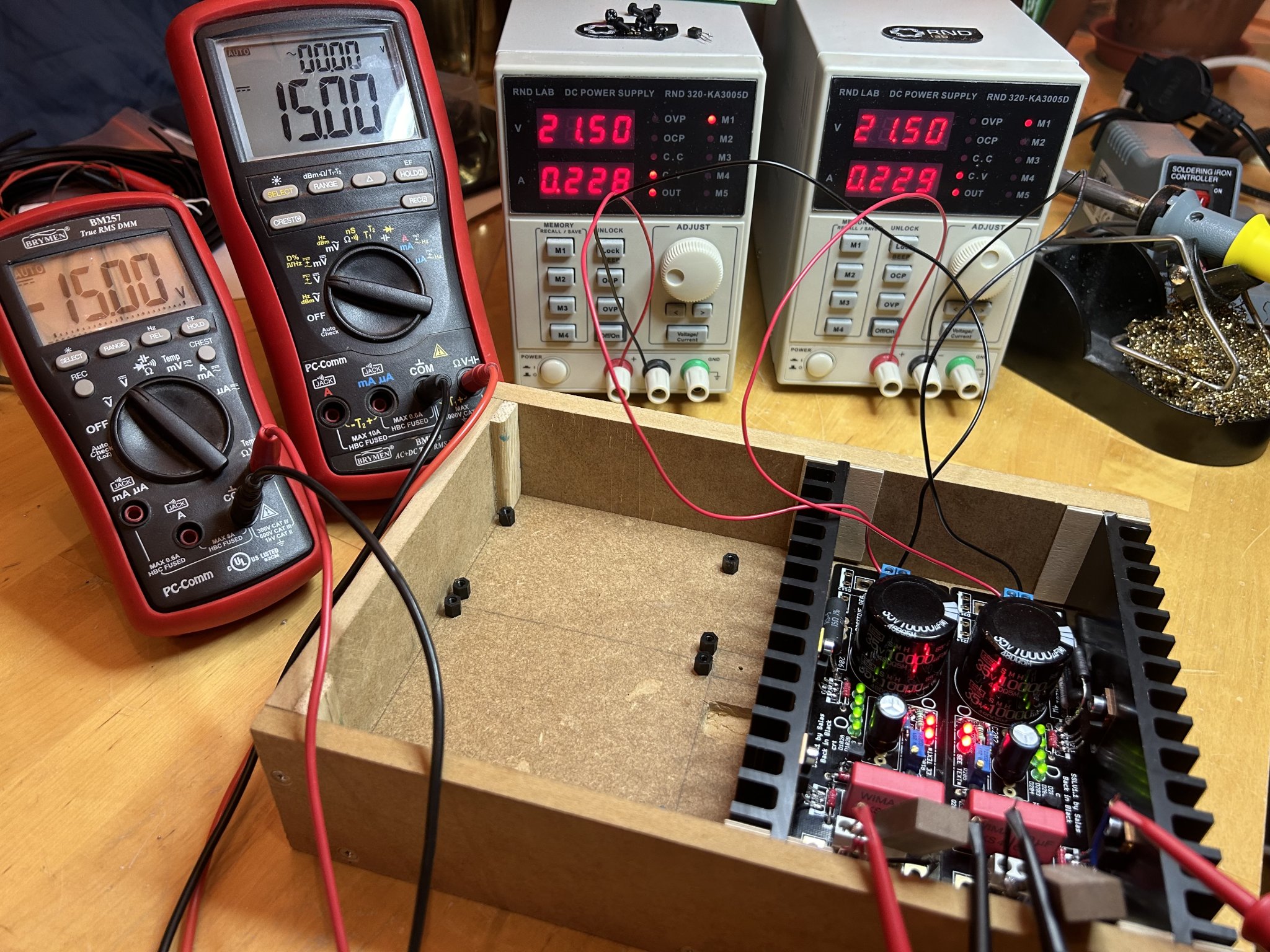

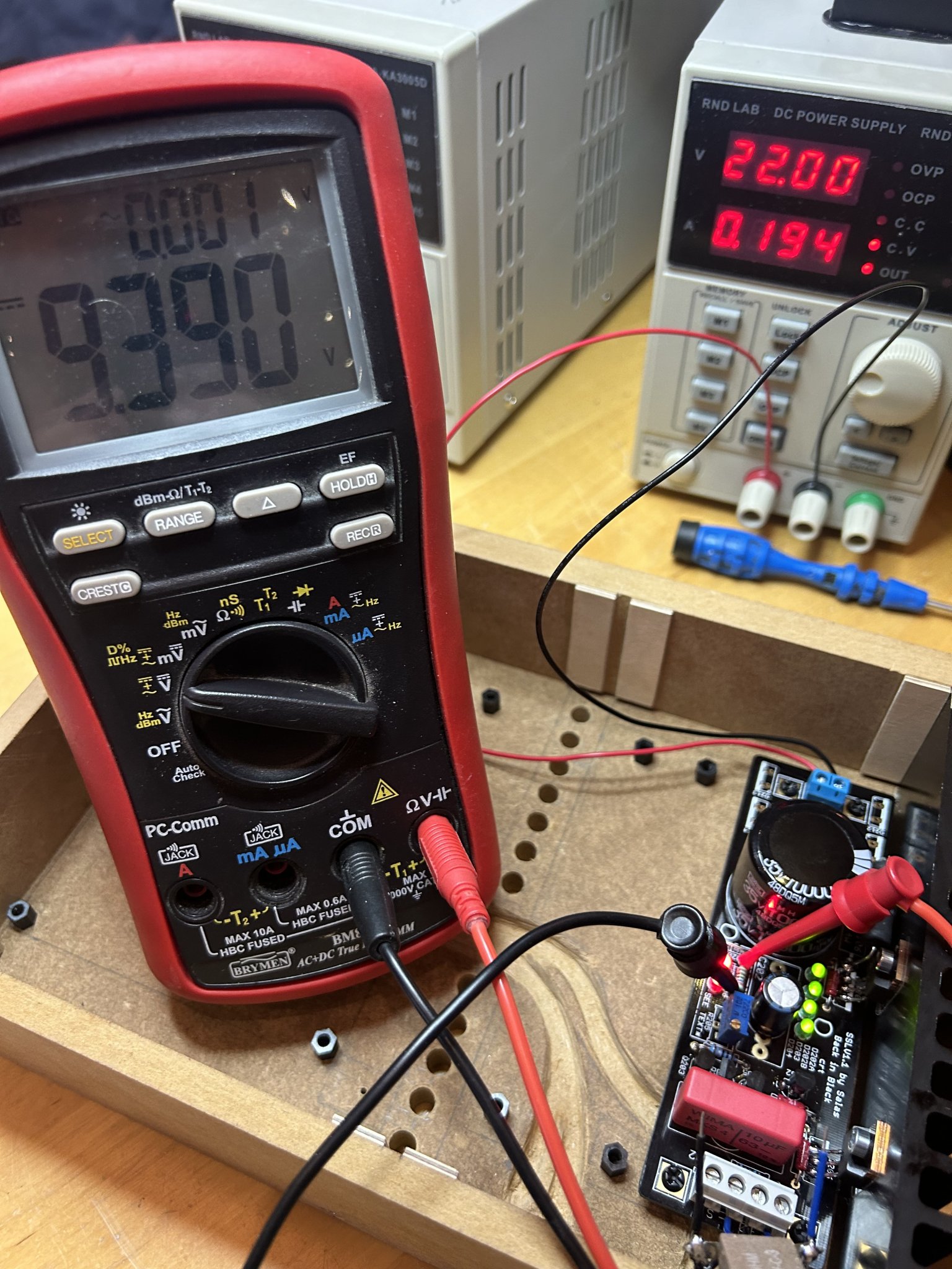

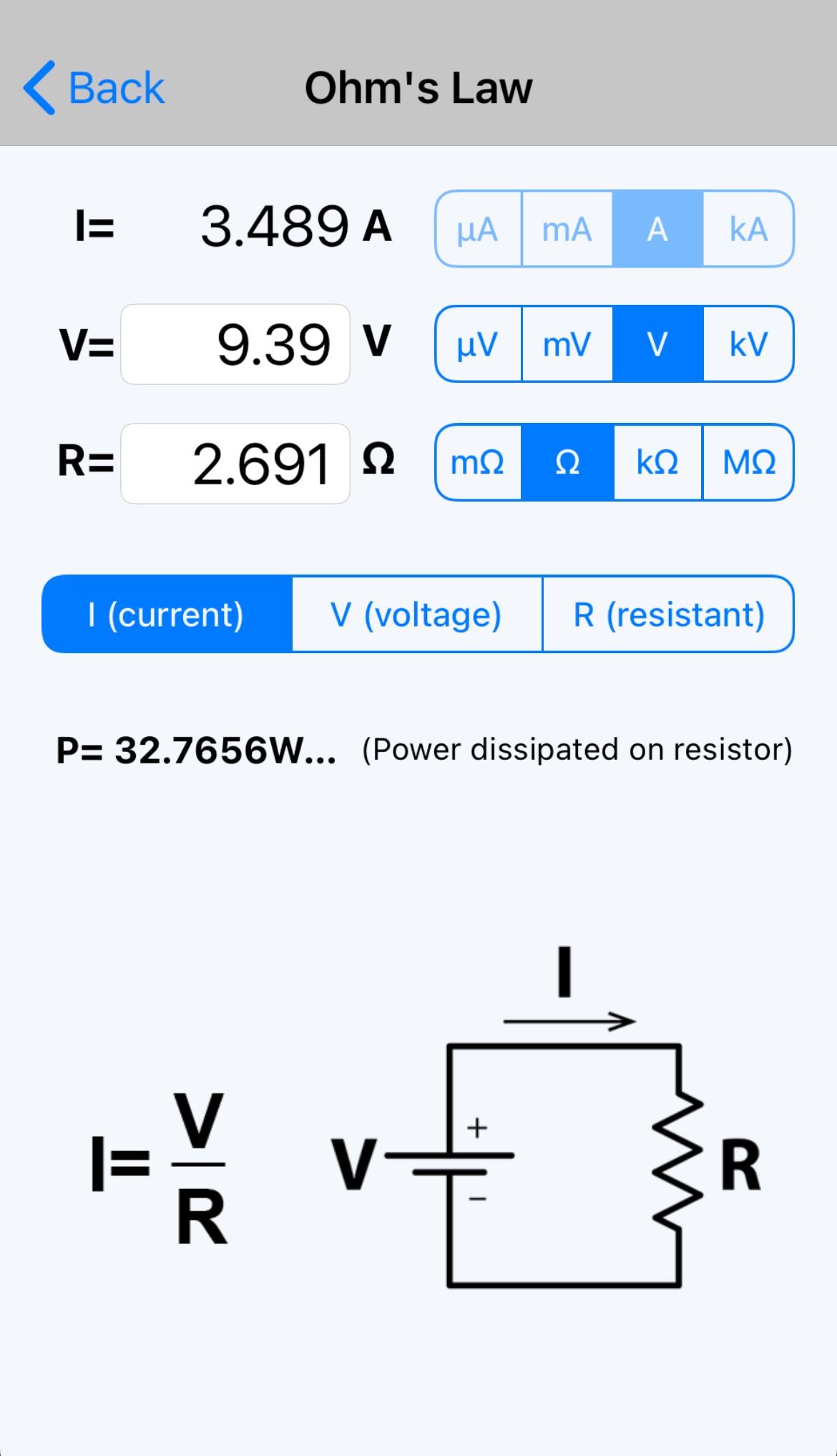

No, 9.390V/2691Ω=3.17mA
4.22mA Idss / 3.17mA in situ = 33% loss

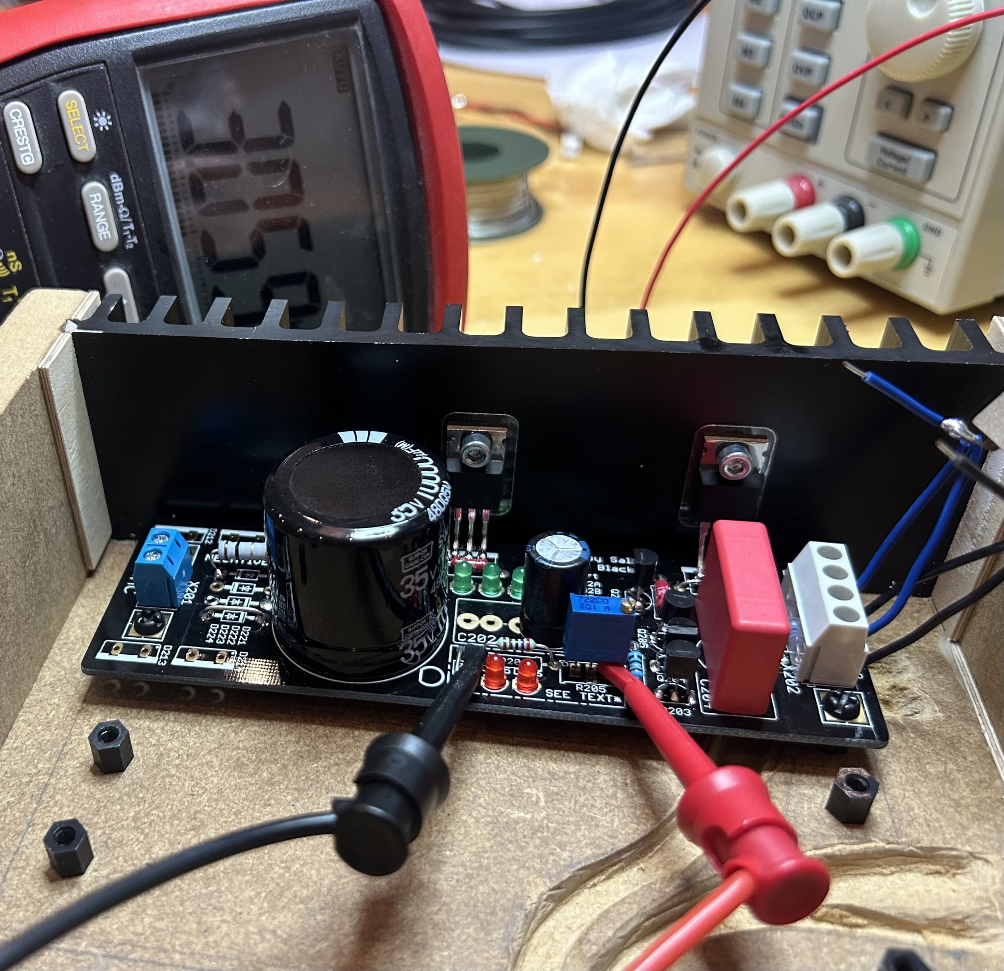

C202 or C201 Vref filteing uF must be charged and discharged. So how many mA in Vref vs what value C make the adjust response faster or slower.It might have been just a false impression but it felt like the negative reacted more sluggish than the positive. Both on startup and when turning the trim
You are forgiven my friend. Maybe you didnt have your pizza and beer? I, on the other hand, am strong as an oxe and sharp as a razor after a pizza speziale and two lager if you would like more measurments.
Otherwise lets talk current, R101/201, what do you think we should aim for?
