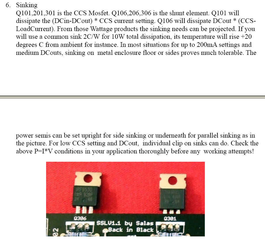

If we multiply by AC output of your transformer by 1.4 we get the approx voltage DC your regulator will have to deal with, which is 16.8V. So we need to convert 16.8 to 3.3 and 5v so depending on the regulator type that will cause heat generation as it brings down the voltage. It is quite possible but would be more efficient if you brought the transformer voltage down. You need to include some voltage off for the diode bridge and allow some voltage headroom to operate the voltage regulator.
Chris
Backbones is quite new to this and already he has identified an area that has not been considered in the brief.depending on the regulator type that will cause heat generation as it brings down the voltage.
How can anyone think that 12Vac and 5Vdc is sufficient to start a design analysis?
Is 200mA output current what he needs/wants?
Is he going to use a ventilated case or unventilated internal heatsinks or external heatsinks?
Both he and us need information from a brief to be able to start to answer the question
Is it too high ?
The guide can not be an essay on thermal sinking, its already too big and complex for many to follow. Gives caution about need for proper sinking, power dissipation calculation for the reg's Mosfets, also an example. For those needing more on the subject, this one link seems simple enough to follow Heat sinks for transistors

Backbones did already about the voltage. Can work, but why not smaller VAC trafo? You don't need useless headroom, its just heat, is the resume to answering his original VAC question. What is more is he needs state current. About trafos, sinking, and ventilation, you know very well, have seen you calculating in power amps threads to the last iota of power and thermal detail, I will have nothing more to add that I know better my self. If he will tell you his power needs and sinking config you can answer.
