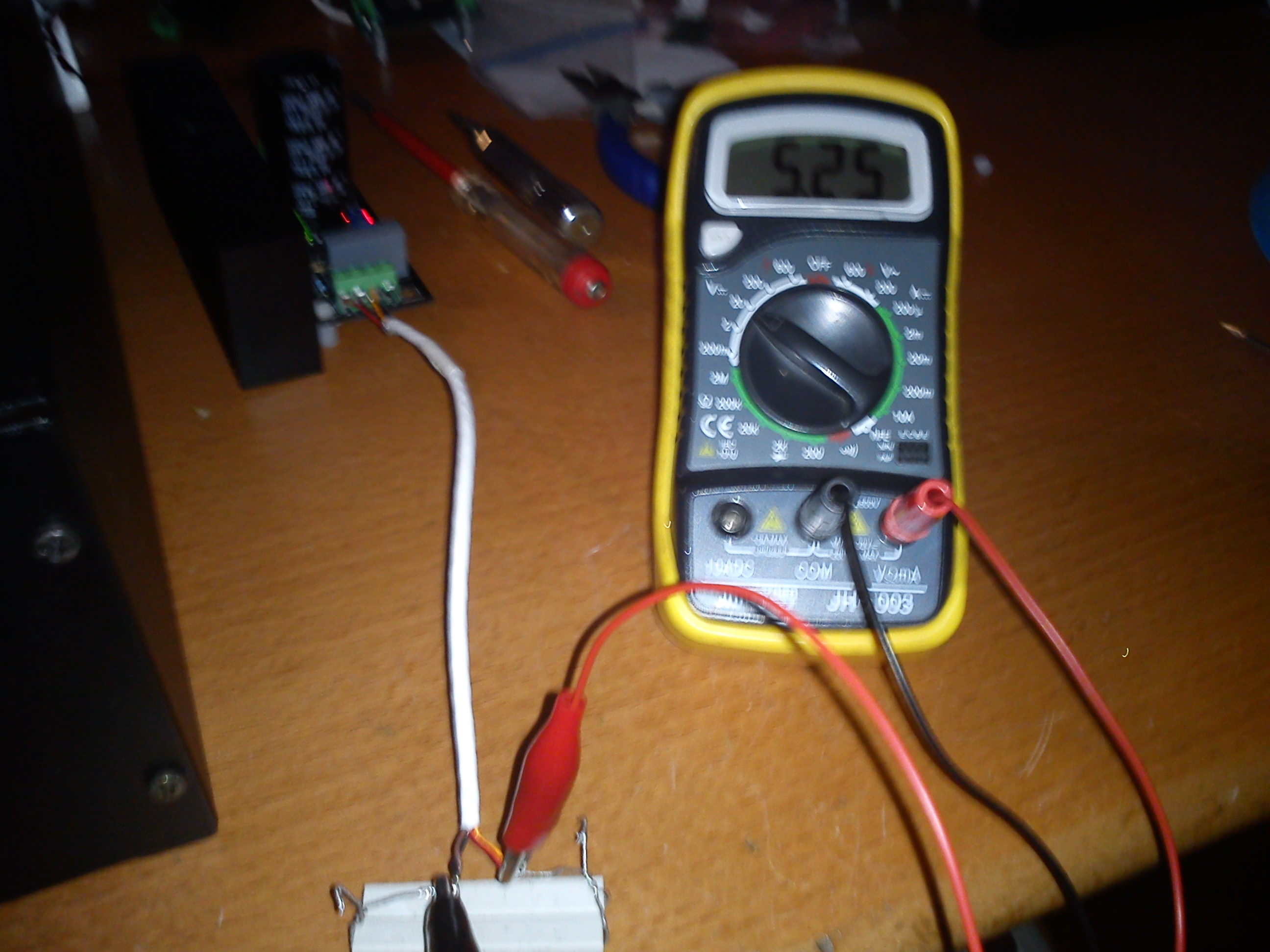

With a dummy load 11 ohms (two 22R in parallel) reg gets 5.25Vout so 0.5A :confused:

Voltage across R301:
6.3Vac trans = 1.31V
9Vac trans = 1.36V
R301 is 10ohm
The output is the same 3.3V, the different will be CCS current of 50mA.
