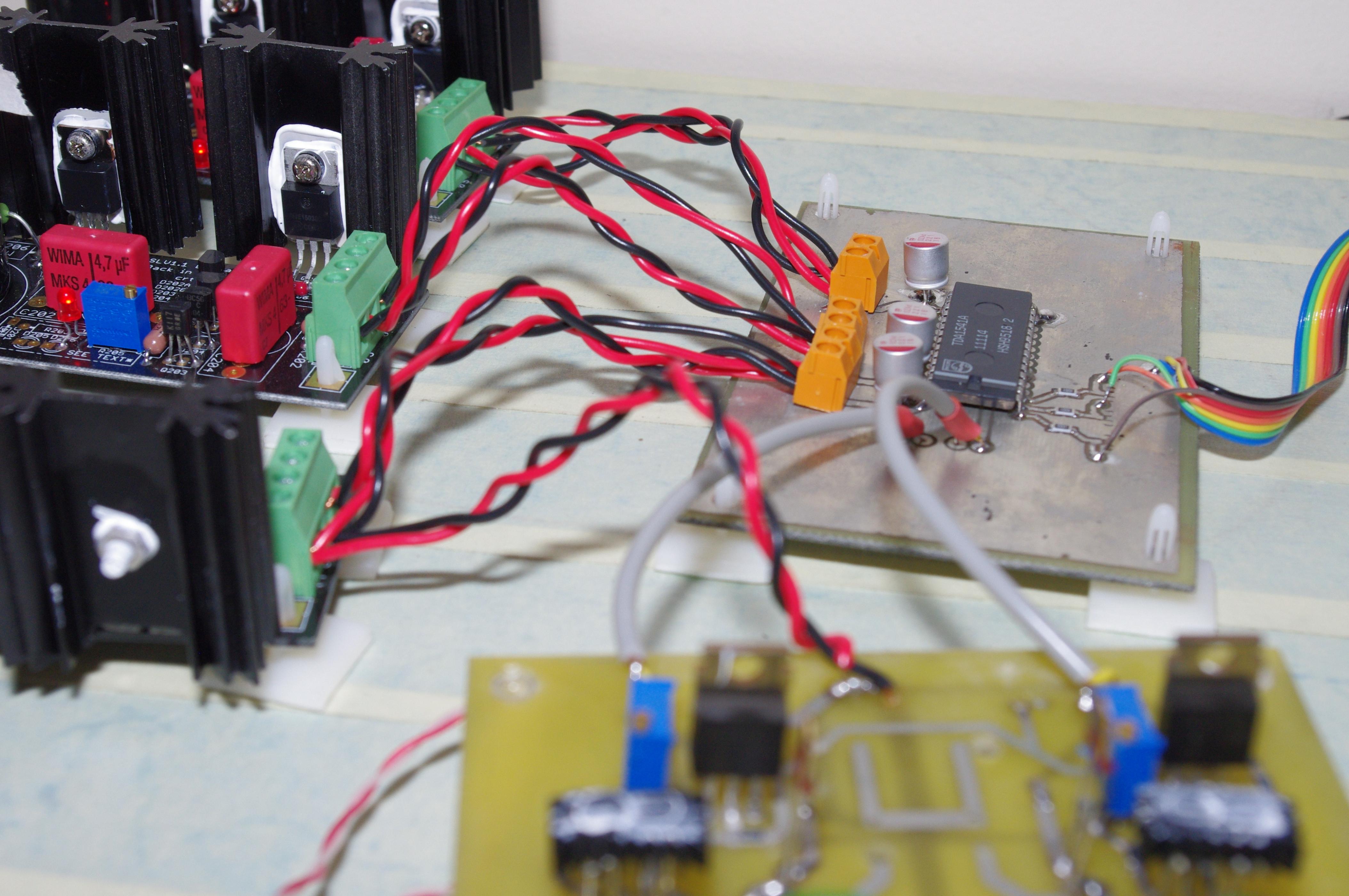

SSLV1.1 powering TDA1541A
Improvement in sound with these regs is quite a step up. Happy with the stability so far; DC coupling to my power amp has been quite a juggling act but ive enjoyed the challenge. Hi-res picture attached.

Nice. What is the config you supply exactly?
Thanks.
The 3 regs are supplying -15V, -5V, and +5V to a TDA1541A running at 44.1/16. The +5V reg is also supplying 2mA of current to bring the voltage on the analog output of the DAC to 0V (so far stable to about +-2mV).
The output stage is the CEN current conveyer circuit published by EUVL. The DAC sees about 6-7 ohm impedance keeping it roughly under the Philips' spec of +-25mV.

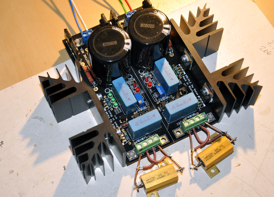

Question: I've built a pair of Salas shunts to supply +- 30V for a headphone amplifier project (that got seriously sidetracked by too many other things to be built first). Both are working flawlessly into their dummy loads but exhibit very different voltage ramp up behaviour (in need of a better way to describe this...).
Both are built exactly the same way BUT the colour of the 3-LED string and the make of the 5K trimmer. When I switch them on one will start at about 27V and then slowly creep up to about 30V (my desired voltage), the other starts at 29,7V and finally hits 30V. I am suspecting the trimmers, both being 64W types from Vishay...(?), but one side sports the creme housing and the other side blue (see pic).
Is this of any concern... is it the different trimmers... since in the end (after about 5 min. my voltage is at +- 30V as desired. ? 😱

the smoothing before the regs use very wide tolerance caps.
That would be part of any difference in start up speed.
The CCS then charges the regulator and any capacitance in the load.
That CCS into capacitance is a ramp up. IT is NOT instant.
The speed of the ramp up depends on CCS current and capacitance This would be the second contributor to difference in start up speed.
I suspect the 27V & 29V7 are simply you not being able to "see" the ramp slope differences.
Working with no ramp ups in dummy and then not, makes me suspicious of oscillation also. Check with a scope. Also make sure that the real loads consumptions are not far more than with the dummies challenging the CCS margin to load current.
