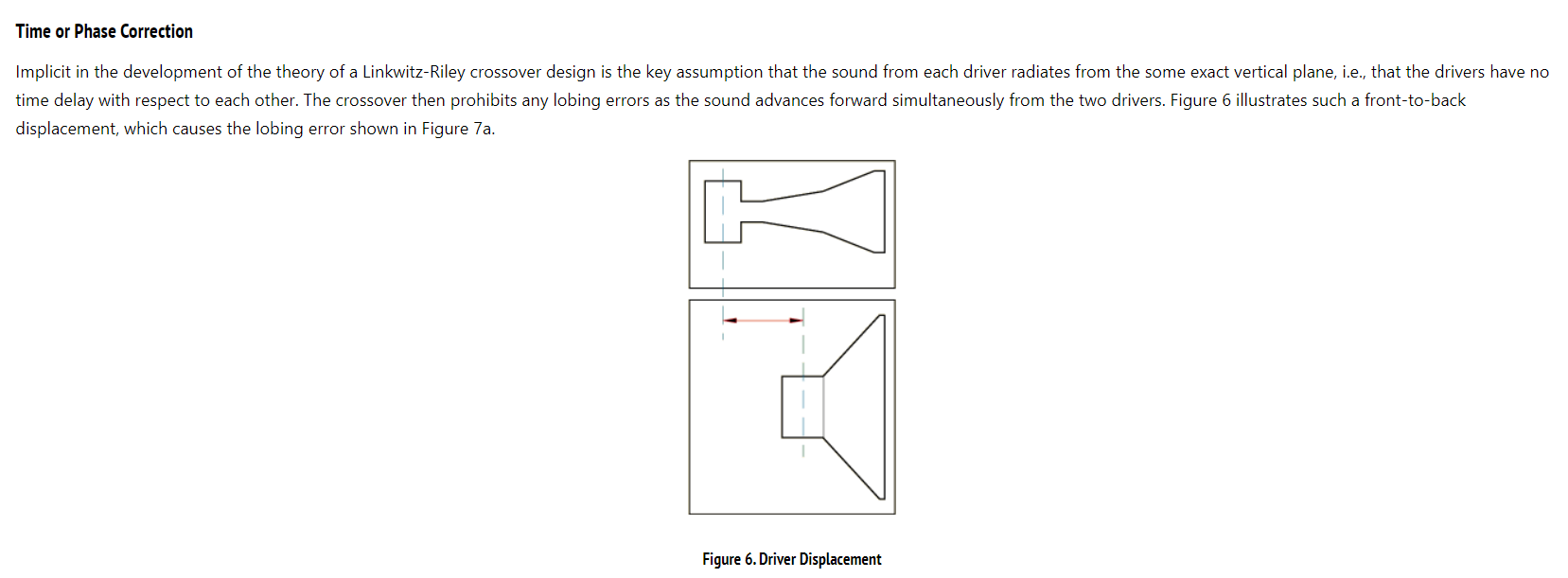

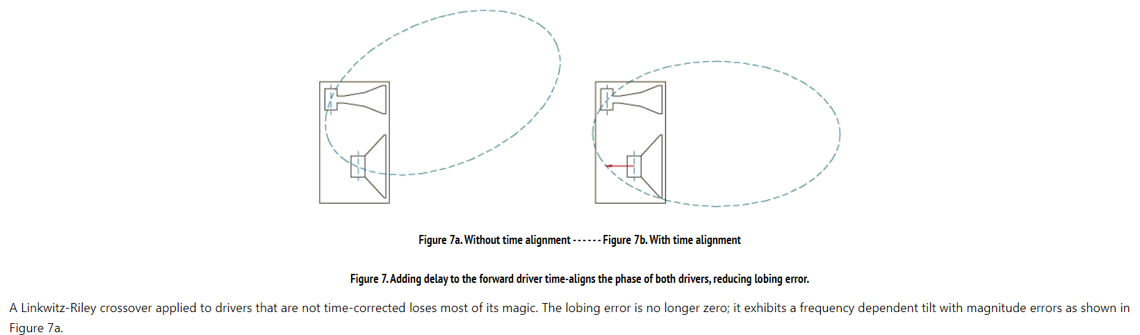

Kirchner Elektronik measuring experts show how to time align with a white noise signal
https://kirchner-elektronik.de/en/photo-story/
Link still works, look page 20
https://www.diyaudio.com/community/threads/physical-time-alignment-of-drivers.400794/post-7389815
I do all of the above (use my feet instead of friend) and the result/effect is consistent at any distance and (surprisingly) different frequency bands (doublebass/cello/violin for example -- suggesting what is relied on is "air"). Provided that adequate, common sense testing conditions and procedures are satisfied/followed as outlined below.Hi, how did you do the tuning!? sliding tweeter live from arms length distance? or did you have a friend/robot to move it while you listen bit further away? Or AB testing with different speakers? How is your xo?
I'm mostly interested audibility of it and I believe you there is a difference, at least close listening. I should do more listening tests on this.
Ideally one should first align drivers' acoustic centers (via manufacturer info or eyeball-then-tweak). Then design XO (by tweaking values if necessary) such that at the XO frequency, phase is also aligned. This latter is verifiable by ear using a test tone, the combined loudness should be maximum over varying offsets (periodicity being XO wavelength). Then, when music is played (just one channel), a floating image or sense of air is present. (If the offset is now changed the effect vanishes.) Now play both channels, any distance, each tweeter axially aimed at one ear, but must be from L/R-front (not directly front nor directly from the side), where hearing is most sensitive, and a holographic soundstage should materialize. (This speaker placement and listening position combination can be assured by playing a test tone at the hearing upper limit frequency.) If the acoustic centers aren't aligned but phase is aligned at (ONLY) the XO frequency, the imaging will be far less holographic -- IN MY EXPERIENCE.
