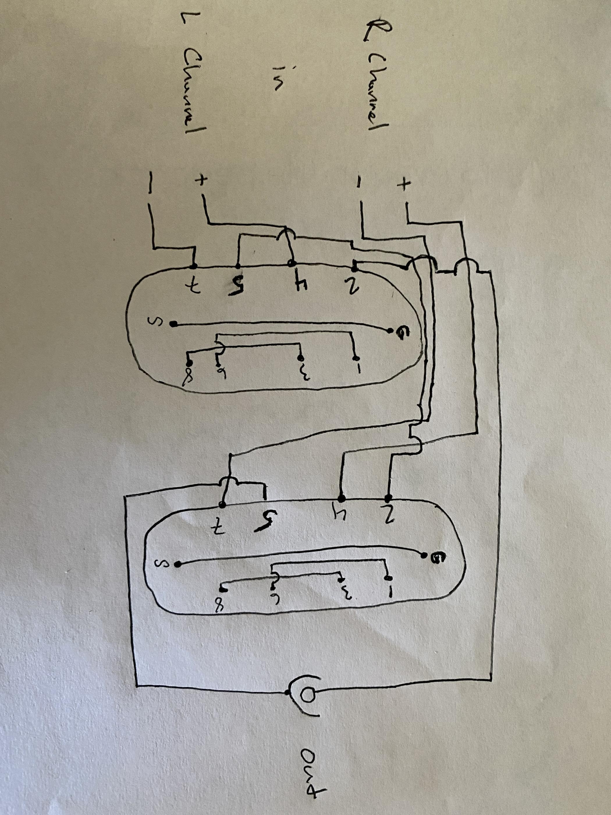

Since they are 1:1 for line level transmission I was hoping to wire them in a way that they'd take a stereo analogue out from DAC and convert to mono signal for preamp input. Here's a diagram I've found where someone did this with triad transformers (TY-146P) and here's the diagram that was used.
It looks pretty straight forward but just not clear enough for my lack of knowledge to understand where to put the wires for my application. Thanks again!

That "diagram I've found" may be part of your puzzlement. It's got 4 wires out of a 3-connection plug. Draw it out correctly then drop the W.E. artwork in.
The output is floating and nominal 1,200 ohms; it probably needs one side grounded for sanitation but probably does not need a terminating impedance.

Thank you so much for organizing that properly! Gives me much more clarity. I’ve attached a sketch where I’ve drawn the transformers as the numbers are stamped on physically on the top. Believe I’ve got this correct from your drawing above. Only change is that I’m using regular analog jacks instead of headphone jack in.
