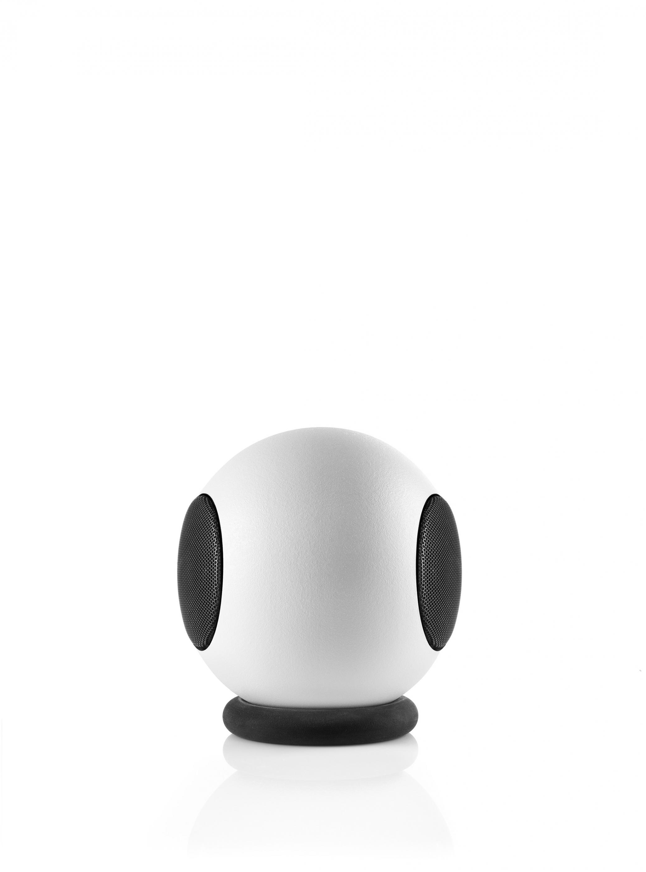

Devialet. Ingénierie Acoustique de France.
In cooperation with the stereolith founder Walter Schüpbach or did they just snitch/copy his idea? Visually very similar to stereolith.
The SAM Processing is quite a declaration. Anyone?
so basically it's a digital phase alignment, sort of, right?
Well, if so, then where is the promised "speaker matching"? DSP stereo speaker matching - this would be real something, yes, but this Devialet...? What is it, really?
Hard to say. What I can say is that:
the ADH Intelligence regulates Phantom’s entire mechanical functioning with absolute precision. This technology - exclusive to Devialet - is a powerful microprocessor hybridizing digital and analog technologies, which purifies and magnifies the audio signal.
...sounds really awful. Of the worst kind of pure marketing balderdash.
The marketing is there to speak to lay audience.
Do not underestimate Devialet technology. These guys know what they're doing.
I am not sure how they will allow SAM together with native DSD when it is later incorporated in Phantom because it is basically DSP to better match around 70 speaker parameters in a model so that it works efficiently (and also protects the driver). SAM corrects the bass response below 150Hz.
Nope, those have nothing to do with stereolith!Devialet. Ingénierie Acoustique de France.
They are just "regular"(*) speakers: what you see in the pictures is just one speaker for one channel.
You'll need two of them for stereo, or more for multichannel.
http://images.computeraudiophile.com/graphics/2014/1216/Devialet-PHANTOM-White%20Paper.pdf
(*) ...if you can call "regular" a 6 liters ~spherical speaker which can deliver up to 103dB SPL from 16 Hz to 25 KHz!
Not to mention that each of them is a complete system including a network server, DAC, DSP and a quite powerful and really very interesting amplification...
