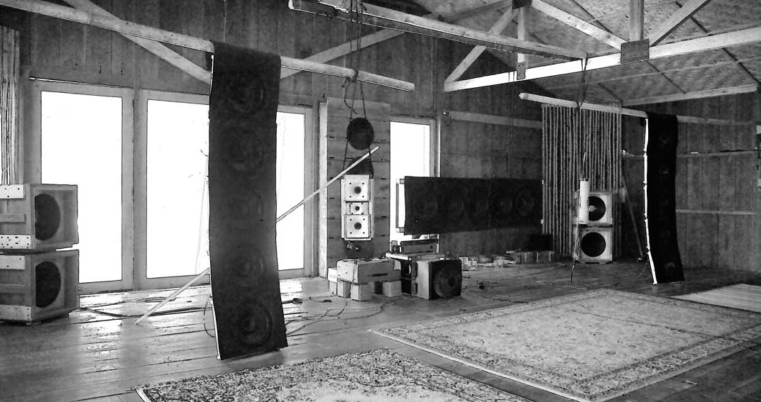

After the first test, here is a normal and fearless evolution of the "SSS applied on a multi speaker group". Now the central speaker is also a five 12" array, curved baffle, same wiring, same drivers, but horizontal.
I will not enter in the details of the probable finger like lobes, but there is an happy consequence. In despite of the center element and of the matrix that for the common sense would reduce the stereo extension, there is a great increase of the maximal width. For the connoisseurs, this is not because the tweeters excite the reflections during some sharp transients. This comes only from the low mid bass. On some records, a double bass or a male choir can be projected at 60 degs on a side ( the base of the listening triangle is 5 meters and the listener is at 6 meters, it's not because of being the nose on the speakers). In some synthetic productions, this localization can even reach the 90 degs but this time with the help of the high frequencies.
Without the SSS, these extremes are each reduced of 30 degs.
Too wide is not realistic, I know, but this extra width happens for instance on some Haendel oratorios where it is said that the massive choirs are in the sides chapels of the cathedral, then it's not a fantasy but a better restitution.

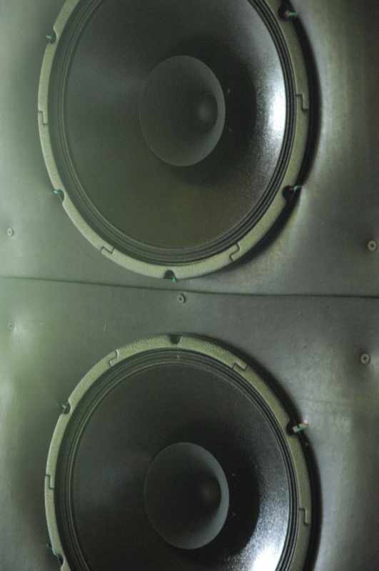

I think see something there (unrelated to SSS) I've tried too: Are those mass-loaded vinyl baffles? The curved feature of your arrays is as much happy accident as design . . . I too have done MLV baffles because I have access to a lot of it, and because it gives OB speakers a lot of design flexibility (pun intended
I've never posted about it for fear of a debate about a flexible baffle being 'wrong' (the answer: Baffle stiffness is completely moot if all resonance(s) fall below Fs of the system. With all those drivers on there, the system is inherently plenty heavy and well-damped).
I'm also going to try some baffles with recycled rubber mat, as it is more elastic and possibly better damped than MLV.
. . . It also smells good, like a new car.

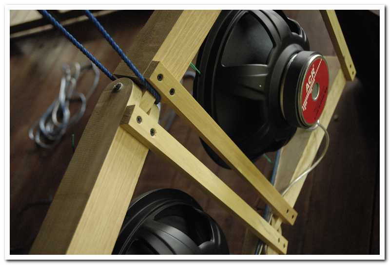

By the smell anecdote, I see that you are experienced. I use truck rear wheels mud guards, very soft rubber with a degree of elasticity, easy to make the holes, 4$ for a 75 x 50 cm plate (in Indonesia). It's also easy to secure them with some screws.
The thickness can be a matter of concern : too much it becomes rigid, too little it becomes almost acoustically transparent. I suppose that 5mm is a good compromise.
The hard structure is just an articulated ladder, I wanted to see what's the influence of concave vs convex (a waste of time and too wide driver inter spacing). Better to go directly to concave. BTW for a specific distance there is a shape that gives the best impulse and Hf extension.
The drivers are not secured hardly to the rubber plates, and not even to the ladder. They are suspended by nylon wires and the rubber dampens very nicely the drivers frames because it's really in forced contact, like a tyre on a wheel. The pictures can help to understand.
It can be considered as ugly and invading, as the ensemble is also suspended, but it's a very easy and fast way to make temporary experiments without hesitating to scrap everything in case of a new luminous idea .
