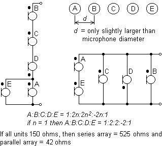

However, x = 0.5 can be done passively !
This schematic allows comparison between x = 0 (Stereolith) and x = 0.5 (vector steering) by a single switch ! (x = 0 means switch is closed)
Using the switch while listening is enlightening !
- Elias
strictly speaking even when x=0 it is hardly Stereolith because in Stereolith the front speaker is high passed at 2.8 kHz
anyway - can you describe the spatial presentation of "X0.5" - nice name BTW, isn't it?

Yes x = 0 is not exactly the Stereolith product, but the stereo part of it should be based on the same configuration, that is the two sideways aimed L and R signals.
