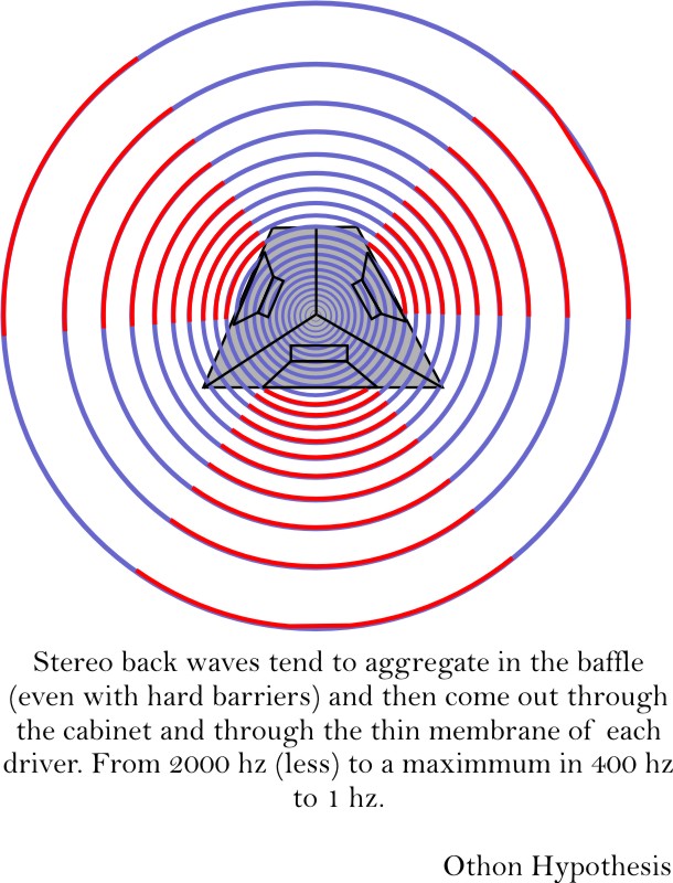

The evil bachwave
wow, thanks, a lot of valued information! Just in time!
My crazy mind says: Everything is perfect until the baffle mixes both channels due their backwaves. EVEN with separate baffles....
Front waves not shown
sorry for my terrible English.
