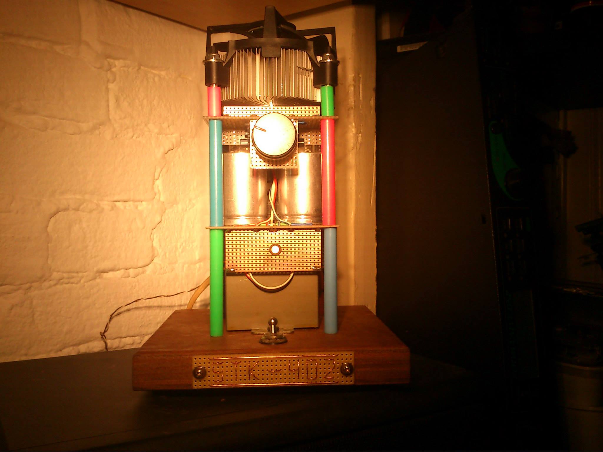

My first tryout for a cpu cooler based stk amplifier. I think the stk modules are perfect for being cooled by cpu heatsinks as they are very similar to cpu's in both form and heat dissipation requirements. This is an intel stock cooler, the fan is just for mounting the heatsink and is not operational. It is not needed because it's a low power amp and the heatsink barely gets warm when playing at neighbour-friendly sound levels.

Got it! I can confirm this is a 100% genuine Sanyo stk chip, not a fake. They have lots and lots of them in stock and by the looks of it On-Semiconductor is planning to release more STK series. Maybe they can bring some order in the chaos that is the STK family? My main focus will be on the 402-xxx series as they are symmetrical, small and powerfull. I'm designing a custom pcb for it with short-as-possible routing and optimal component placement for use in a series of amplifiers I'm planning to build. New life for the unique hybrid amplifier that is the STK chip.
Correct. The bad reputation these hybrids have is largely because of terrible design of these entry and midlevel consumer electronics. The kenwood unit I pulled a 402-040 out of suffered from horrible pcb design, lots of wirebridges, flatcables and too small heatsink. Also it had numerous opamps, dsp's and unnecessary filtering caps all across the board. No way that can produce good clean sound. Must have sounded dull, bland and wooly. Now that it's freed of that surrounding and built on a gainclone like pcb with ultra short signal paths and no additional filtering or long cables it is a most revealing little amp. Very accurate reproduction, no hiss or hum and excellent clarity. Everything you would expect from a well designed class AB amp. Also, by cooling it properly with a cpu cooler it barely gets warm so there's no risk of frying it when put under stress. I suspect a lot of the premature failures are due to bad cooling designs and mismatched speakers. These hybrids really don't like low impedance loads, 6 ohms is the lowest they can do without burning up but they are at their best with 8 ohm high eff speakers. I really can advocate experimentation with them, for instance: most brands like sony, kenwood, yamaha etc simply use the application note schematic. I'm sure that with some experimentation the results could be much better. My research into STK's is ongoing and so far I like what I'm seeing (and hearing) so expect more updates from me on this topic.
