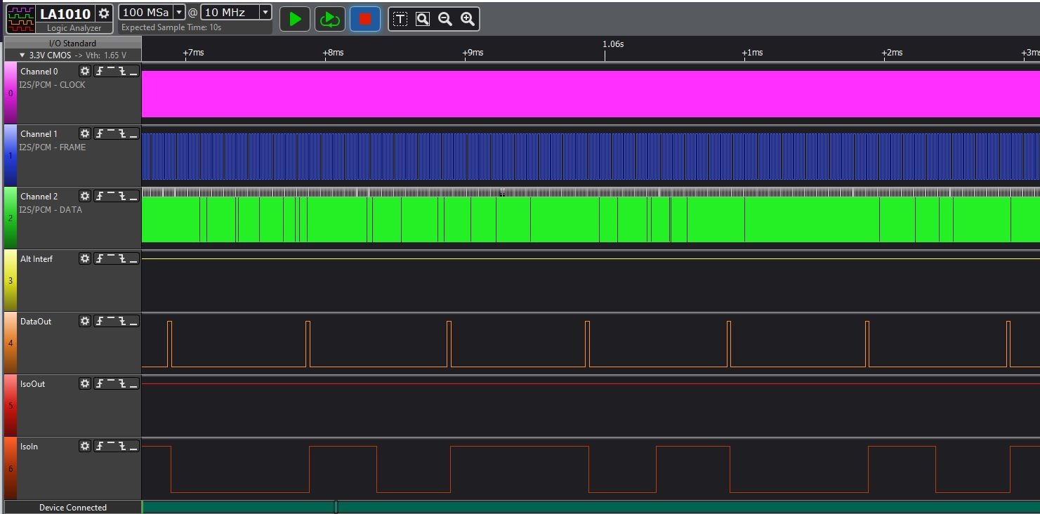

Using the logic analyser, I checked some behaviour in 3.1 mode:
Is that normal?
I would like to better understand the load on my stm32F4, however most of the code is run from interrupts:
- Alt Interface 0 or Alt Interface 1 => switch to 1 when playing, then revert to 0 => good
- 1 DataOut call ebvery 1ms ; good for USB_FS. Time in dataOut short (On on entry, Off on exit)
- No IsoOutIncomplete => Good (toggles when happen)
- Many IsoInIncomplete ???? (toggles when happens) => alternance 1ms, 0.5ms, 0.5ms, 1ms...
Is that normal?
- from USB (part of it in USB stack lower layers I would be happy not to touch,
- from DMA/I2S.

Looking at time spent in DataOut, I doubt that it is a CPU load issue
