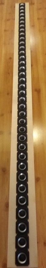

Information is starting to pile up so I've made the decision to wire it 6p/6s, keeping the 6 drivers in a sealed volume running in parallel.

I also pushed the C-C spacing on my TC9 build too close (I literally mounted them frame to frame with no tolerance) and I ended up having to lightly sand the touching ends of each driver's plastic frame to get everything to fit.
Hehe I was afraid of that when made the 65mm decision. Hand drilling with 1mm error is out of my mechanical tolerance zone. I can't believe you had to sand down the frames, that must have been not fun. At least they were sandable

Partially foamed. Always more work than than estimated. Did not calculate the correct area of foam, need to order more

While I have all the quick connects, its quite hard to get the terminals on with out breaking the drivers. Even with holding the terminals with pliers I managed to break 1. Lucky I have a few extra as I've destroyed 1 in the process.
That said I solder a LOT so soldering the tabs it is. Looks like if you are quick, the frames don't melt. Will have to pay more attention when wiring but........
