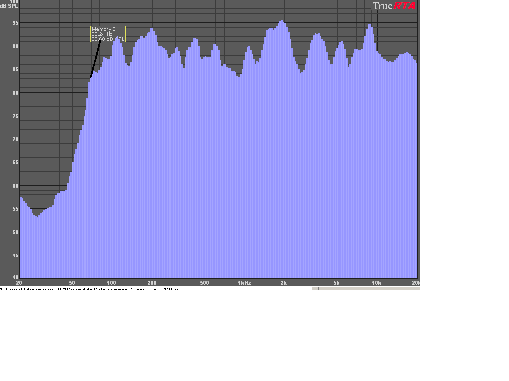

I have broken in this speaker for 8 hours now so I'm still searching for the cause of this difference.
Concerning your Fe164 MLTQWT, do you REALLY obtain this amazingly low 35Hz, and a so similar FR compared to the simulation ?
I suspect room interactions to modify the FR but these differences seem quite big
It looks like you are using pink noise. Is there any particular reason? Are you doing far field measurements or near field?
Yes, I use pink noise in order to have a flat FR signal.
The measurements are made at 1.2 meters (aprox.) from the speakers.
I use the "average" function to cumulate measurements during ~ 1 minute so I'm sure I get the true FR.

The comparison between the simulation and the measurements were done in the near field and shown in the ML TQWT article. I have described how I did the measurements and how I post-processed the results. The correlation was very good as can be seen in the plots.
In the baffle step correction article, the measurements were done at 1 m in my large basement. Again, I tried to describe how the measurements were performed and the LAUD settings are included in the screen capture. The FE-164 driver in the ML TQWT enclosure with a BSC circuit produced a reasonably flat response to about 40 Hz where it rolled off at 24 dB/octave.
The deep base can be clearly heard when listening to them upstairs in my audio room. The bass is not chest thumping like a large 15" sub but the low end is definitely present down to 40 Hz. The 6 1/2" driver in the ML TQWT can only move so much air. My 8" full range drivers do a better job at the very bottom but are still not like a dedicated woofer.
Is there something in the plots that troubles you? Those plots are screen captures and I tried to include raw data and also the octave smoothed data.

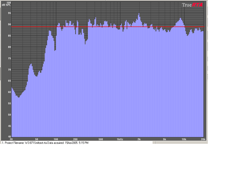

I was thinking about your results and have some questions.
Have you tried to change the scales on your two measurements so they are the same and lay one over the other?
Do they have the same low frequency roll-off?
What is the low frequency content of your source signal?
Does the signal go low enough to give you meaningful low bass measurements?
One nice thing LAUD that does is divid the response by the input to give a normalized SPL result. If your input signal is not completely flat down to say 20 Hz, then the absolute SPL response at a given frequency will be determined by the magnitude of the input signal and not by how linear your speaker behaves.

I wonder whether it's possible to get good data if you are not in a really large room. Even with MLS signal it's necessary to have a 5M+ by 4M+ to get good data down to 200Hz you probably need 100 times the area to go down to 20Hz. Most people do outdoor testing.
I agree. But what is funny about the measurements is the lack of bass. What I have found is that the very bottom end is over predicted by room effects and backgound noise not under predicted. Any noise, like a furnace running inside or an airplane in the distance outside, causes a huge amount of low frequency problems in my measurements. If you look at my curves they start to roll off at 40 Hz and decrease at 24 dB/octave. But not far below the knee the curves get all messed up by low frequency outside noise. Since his curves were rolling off so high I am beginning to wonder if the source is filtered so as not to send huge amounts of deep bass that would ruin a speaker under test.

One other thing is that the W3 is a 3 inch driver, I don't think you will get much low end out of that.
Also, since pink noise is used, pink noise is a weighted noise spectrum, I'm not used to doing it that way, but I gave it a try and got high roll-off in frequency response.
I made the measurements in the widest room of my house : it's 4m*10 and the ceiling is made of two parts : one under the 1st floor and the 2d under the roof so there are not so many parallel surfaces. It makes a good auditorium anyway 🙂
I choosed RTA3 because the pink noise it delivers is perfectly linear from 5 to 44000Hz. Anyway, it detects well my subwoofer low frequencies.
On the measurements, the very low part is a bit stronger, there was probably something generating ultralow frequencies, like a plane or simply the fan of the computer ?
Moreover, the measurements cannot be wrong as my hears really feel there is not enough bass !
I tried a simulation with the TQWT of a friend that I measured with the same mic and the same soft and there is a good results correlation so your mathcad sheets seem to work great.

I made measurements again but the difference is not so high, so I suppose I cannot make the suspension softer, though the sound quality of the driver, that cannot be measured, is still improving. There is a strange dip between 92 and 100Hz, I don't know the cause of it because when generating the same frequencies with the sinus wave generator, no dip can be heard and the SPL is exactly the same.
The last thing I should do is finalize the cabinet, put more screws, glue all the edges and, mainly, make a connector so as the driver's wires don't go out through the port 😀
Cyburgs : I had already seen your cabinet on the Internet, and I'm sure it performs very well, as you obtain 60hz at -6dB
Unfortunately, my parents would'nt like to see an enclosure that they would consider 'enormous" in their living room : I promised to make small cabinets and the one I built is almost too big, but it was easy to convince them it was a good thing because they find the sound great 😉
In fact even if my speakers don't go lower than 75hz -3dB, it's enough because then the awful subwoofer of the home theater does the bass job, but without polluting the 80Hz and more with bass reflex resonances.
If I have time I'll do another simulation to get something better but otherwise, the bass response is theorically enough for this purpose. Anyway, this enclosure makes a great center speaker !

I finalized the cabinet, with glue, screws, internal damping... 4 weeks ago and made measurements this afternoon. Th bass extends down to 70Hz -3dB which approximately correlates with the simulation. ( http://youyoung21147.site.voila.fr/W3_871S_centrale.PNG )
I tried it on the Home theater installation and it makes a nice center speaker !
Because I need more bass for the future front speakers (left + right), I ran again some simulations which led me to this ( http://youyoung21147.site.voila.fr/data_satW3_871S.PNG ). Though the frequency response seems not good at all, it compensates the losses I observed when comparing my center speaker FR and the simulation, so it should give an approximatley flat FR and compensate baffle step issues.
My problem is : after having ran the ML-TQWT sheet to get the parameters of the TL, I ran the ported box sheet to get the port height and improve smoothly the geometry.
But when I saw the frequency response, I was surprised to see it looked really different from the ML-TQWT simulation ! (see picture)
I ran other simulations like that, including the center speaker's, but never obtained such amazing differences
Could anyone tell me which worksheet should I rather believe concerning the expected FR ?
