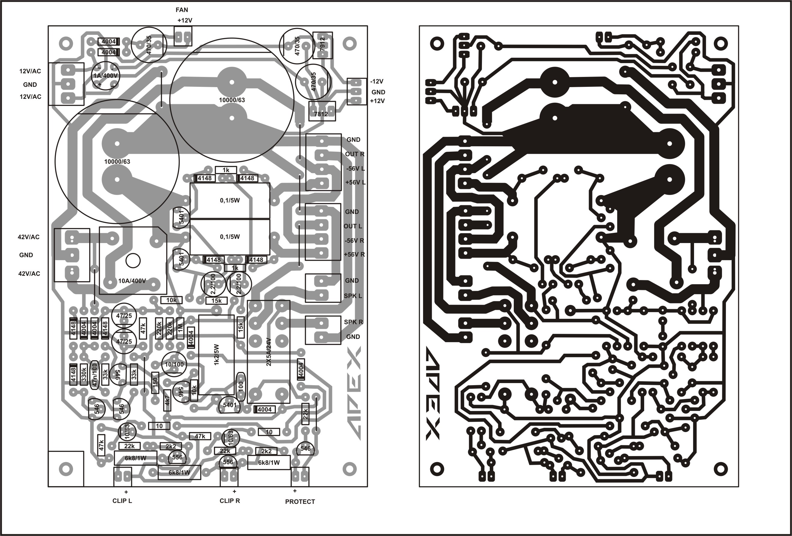

Hello Sir Apex,
I have just completed my first channel of your SR200 design. I must admit, this is one good amplifier.....the sound is one of the best that I have heard in a long time. Bass is good, mids and high very clear. I connected input straight from CD player, no preamp, and I must say, this is one excellent amp. Here is some pictures of my first channel. Planning to build second channel today. 😀😀😀
Thank you Alexx mm for a wonderful PCB design. It is easy to build and work first time. Thank you very much. 😀😀😀 Just one small request, as you can see from my pictures I only have two power transistors populated. I cannot fit a third one in this PCB. Space is a bit to small for 3 outputs. Can you modify this PCB by increasing the spacing between the power transistors, as I would like to populate 3 power transistors. 😉😉😉
One Question Sir Apex. What is the maximum voltage for 2 power transistors in output?
Once again, thank you very much Apex and Alex mm for a wonderful design.😀😀😀
Regards
MACD🙂🙂🙂
Nice work, I suggest to use SanKen 2SA1294/2SC3263 and you can fit 3 pairs on this pcb, use transformer with 2x50-55v AC voltage.

I used this PCB from Alex mm....
MACD
C1 is 10uF/50V, and you use 1uF/250V, try to increase value of C1 (2,2uF 3,3uF 4,7uF 6,8uF... is available)
Regards
macd nice built amplifier , yes it's my mistake regarding size of output transistors . I hoppe now will be the correct one .It was designed for MJL 1302 and MJL 3281 with TO3P case (I have 20 pices ON SEMI) 😉 🙂 😀
Alex mm not Alexx mm !
L.E. Sorry , value for emiter resistor 0.33 ohm not 0.68 , please correct .

Hello Apex,
Yes I know, I tried to get 10uF/63V but supplier was out of stock. I will get the correct value and replace C1. I will even try to increase value as you suggested and will give feedback on my listening experience. I listen to your amp yesterday for about a hour, and I must confess, it is excellent. 😀😀😀 Almost complete with second channel. Will post some pics when completed.

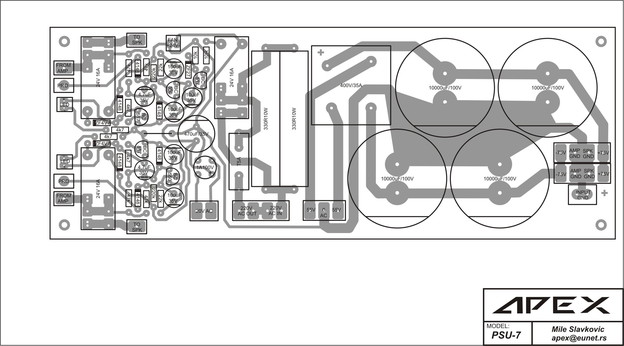

Can I use this PSU with ±65V supply? If yes, what changes do I need to make? 😛😛😛

RE PCB...
Hello Alex mm,
Sorry for my wrong spelling. Thank you very much for this updated PCB. I tried to get MJL transistors but local supplies does not stock them. I will use this new version PCB in future builds.

You can use PSU from 'DC Servo Mosfet Amp' with 10000uF/80V and 1k5/5W instead 1k2/5W.

Can I use this PSU for SR200 amp. I know there is no PRO pin on SR200, but will soft start, switch on delay and DC cutout still work? If yes, what changes do I have to make to work of ±65V?

You can use this PSU without changes, protect circuit use separate 20V AC suply, and amp PSU voltage can be change to +/-65V. I suggest to add overload protect circuit from HV350, and you have 'pro' from SR200.
