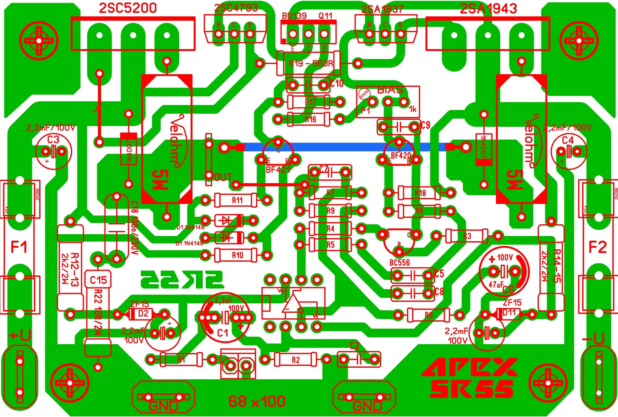

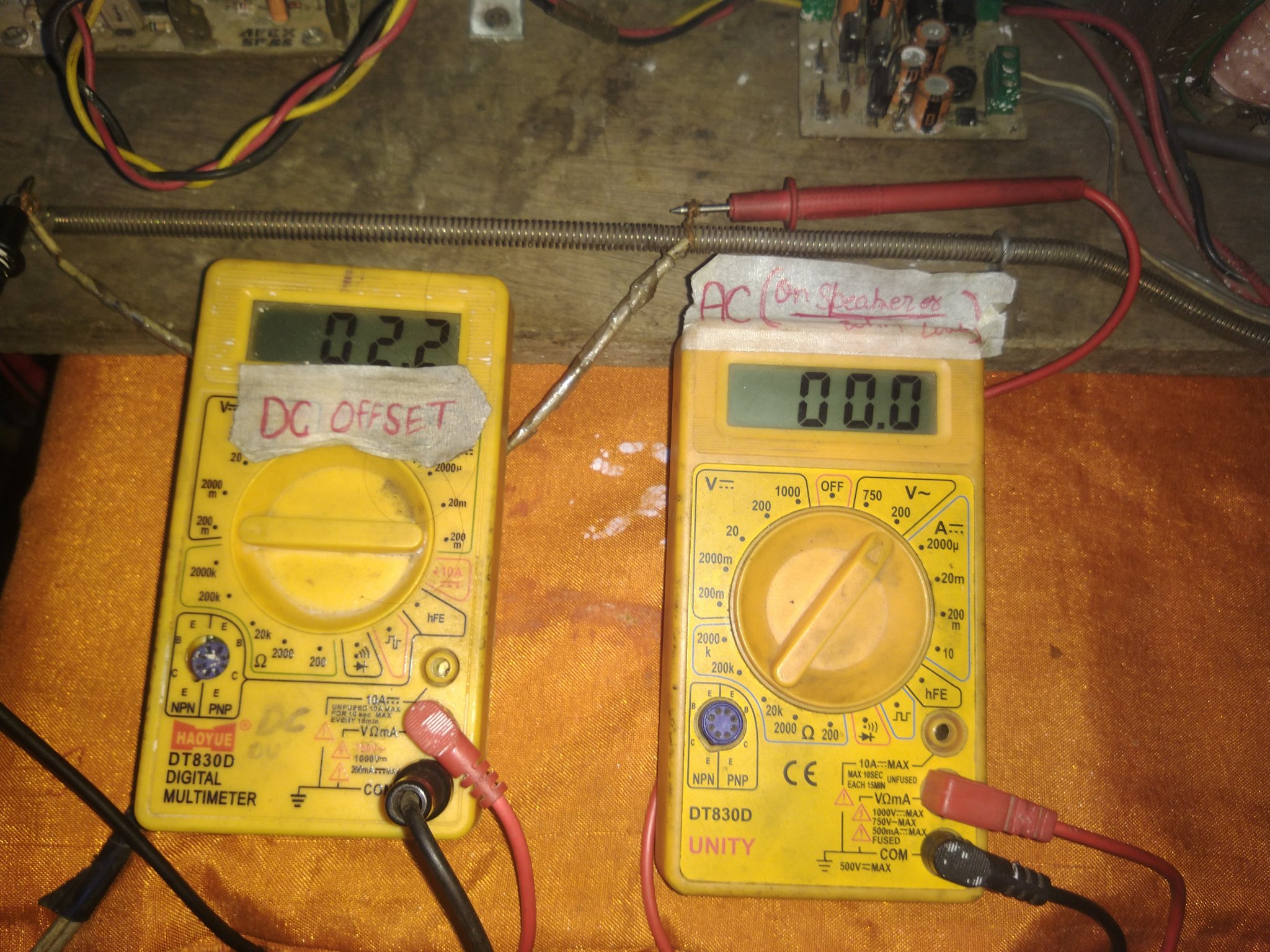

Hello Mr.Miles and other diy members, after long time i play SR55 amplifier, i face a problem with my DC offset. When I Power on SR55 then DC offset between 70-150mv, after sometime (2-3) it's settled on +/-1 mv. How to solve this problem please suggest.

Replace R4 use 56k instead 120k...Hello Mr.Miles and other diy members, after long time i play SR55 amplifier, i face a problem with my DC offset. When I Power on SR55 then DC offset between 70-150mv, after sometime (2-3) it's settled on +/-1 mv. How to solve this problem please suggest.

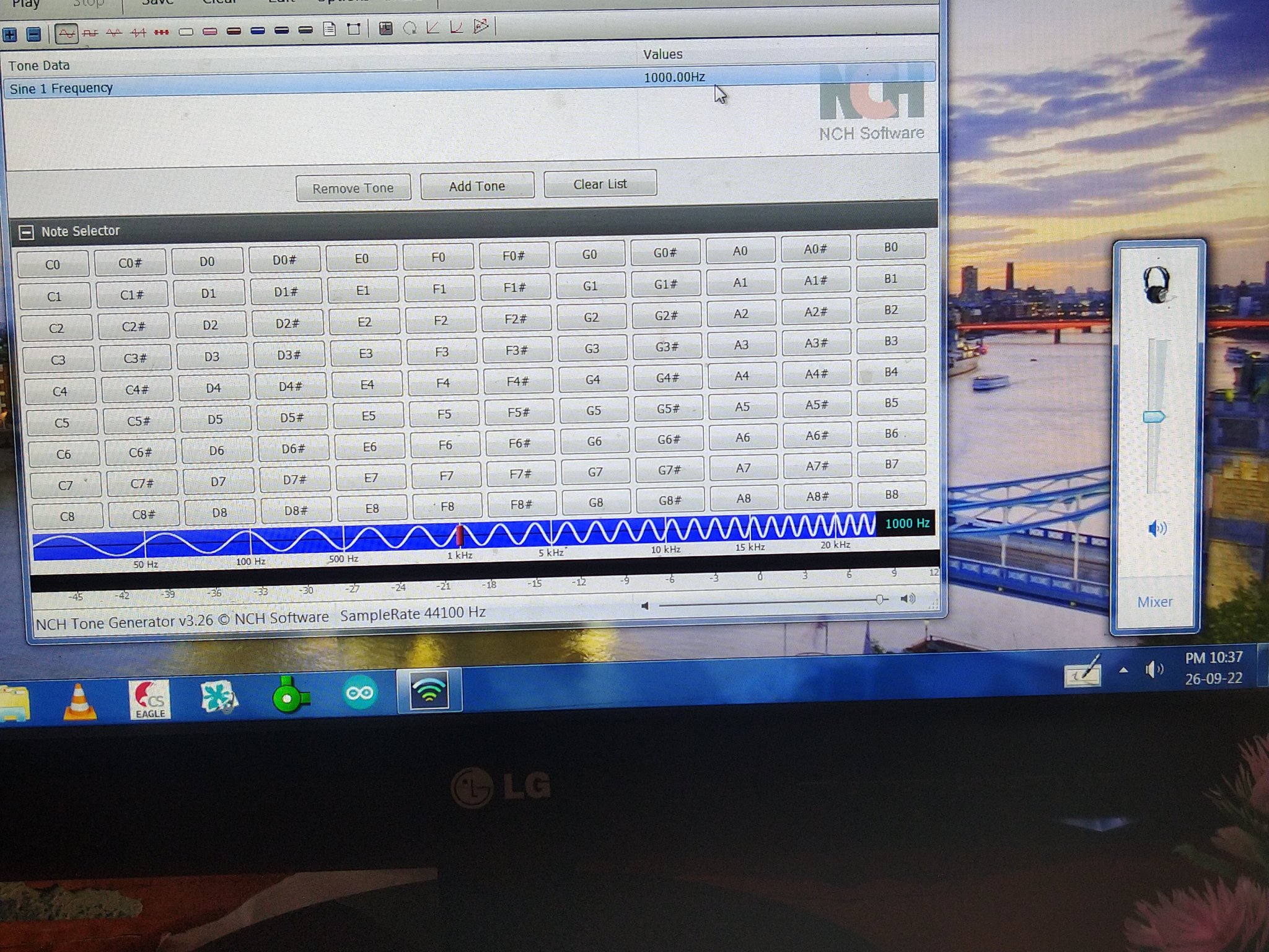

Thanks Mr.Miles for help on DC offset issue.Your suggestion 56k in instead 120k but I use 68k and problem solved.

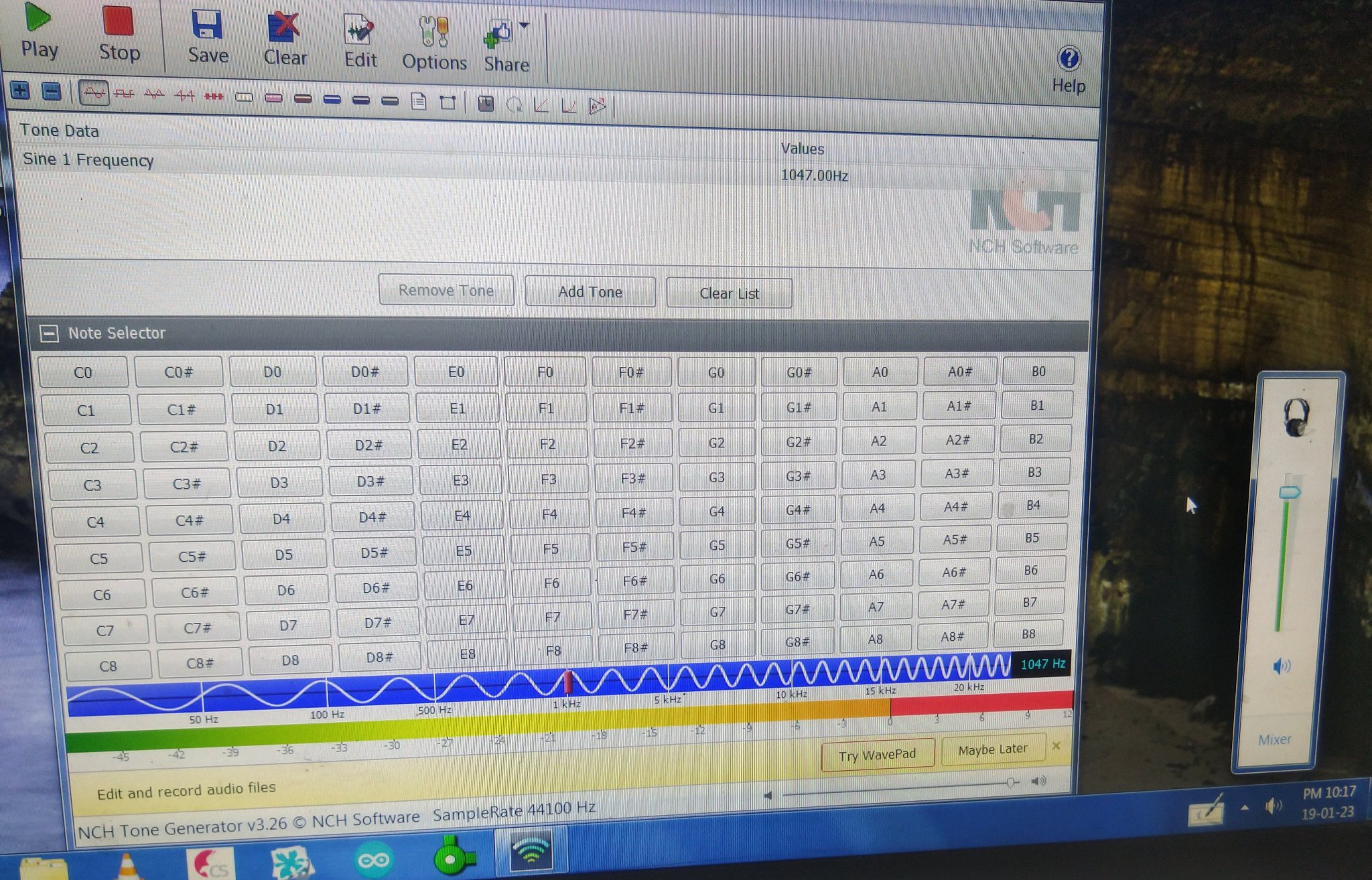

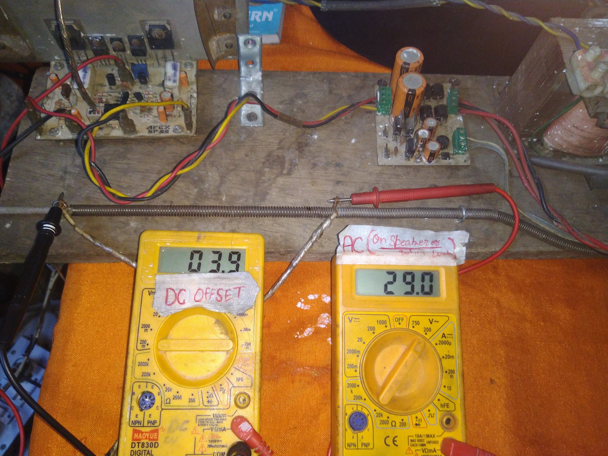

Second, now about Peak wattage
I gave 1khz signal from pc and got 28-29 volt(ac) with 8ohm load. Is that okay?
Here i forget one thing, BF420-421 on available in my area so I use C2383 A1013. These changes gave any advantage or disadvantage.

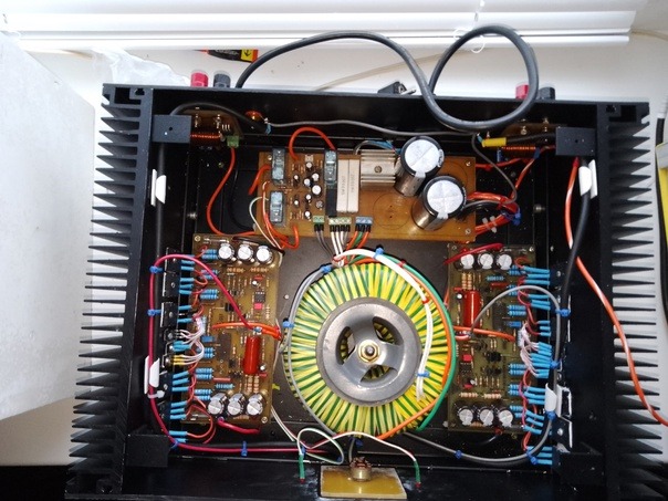

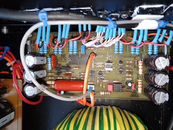

I post some pics also
1 pic without signal
2 pic with signal and in
3 pic 1khz with pc volume level ( i don't know who much mil volts or volt on signal)
Whats your opinion.....
Regards
Assuming a sine wave then you have ~ 100 watts rms into 8 ohm.I gave 1khz signal from pc and got 28-29 volt(ac) with 8ohm load.
I remember using those BF devices video output transistors back in the day. You need to see what Apex says as to the suitability of the 2SC/2SA's as I haven't studied the design in detail.Here i forget one thing, BF420-421 on available in my area so I use C2383 A1013. These changes gave any advantage or disadvantage.

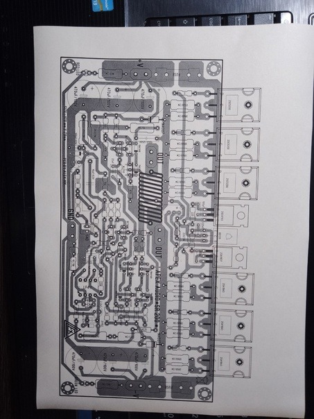

I'm currently pre-finishing a Q17 with mosfets, but if the gerber files were available I'd definitely go for it, ...SR200

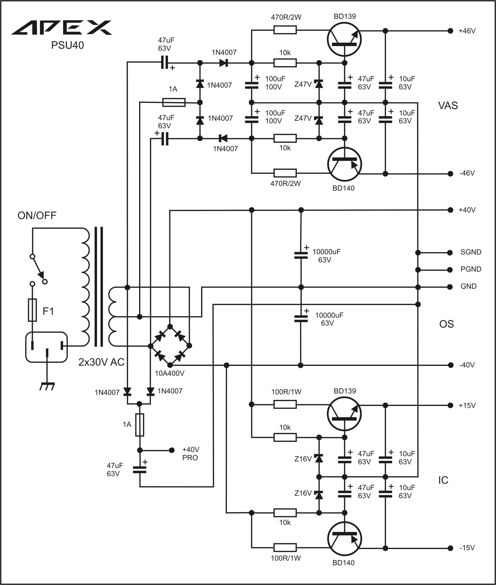

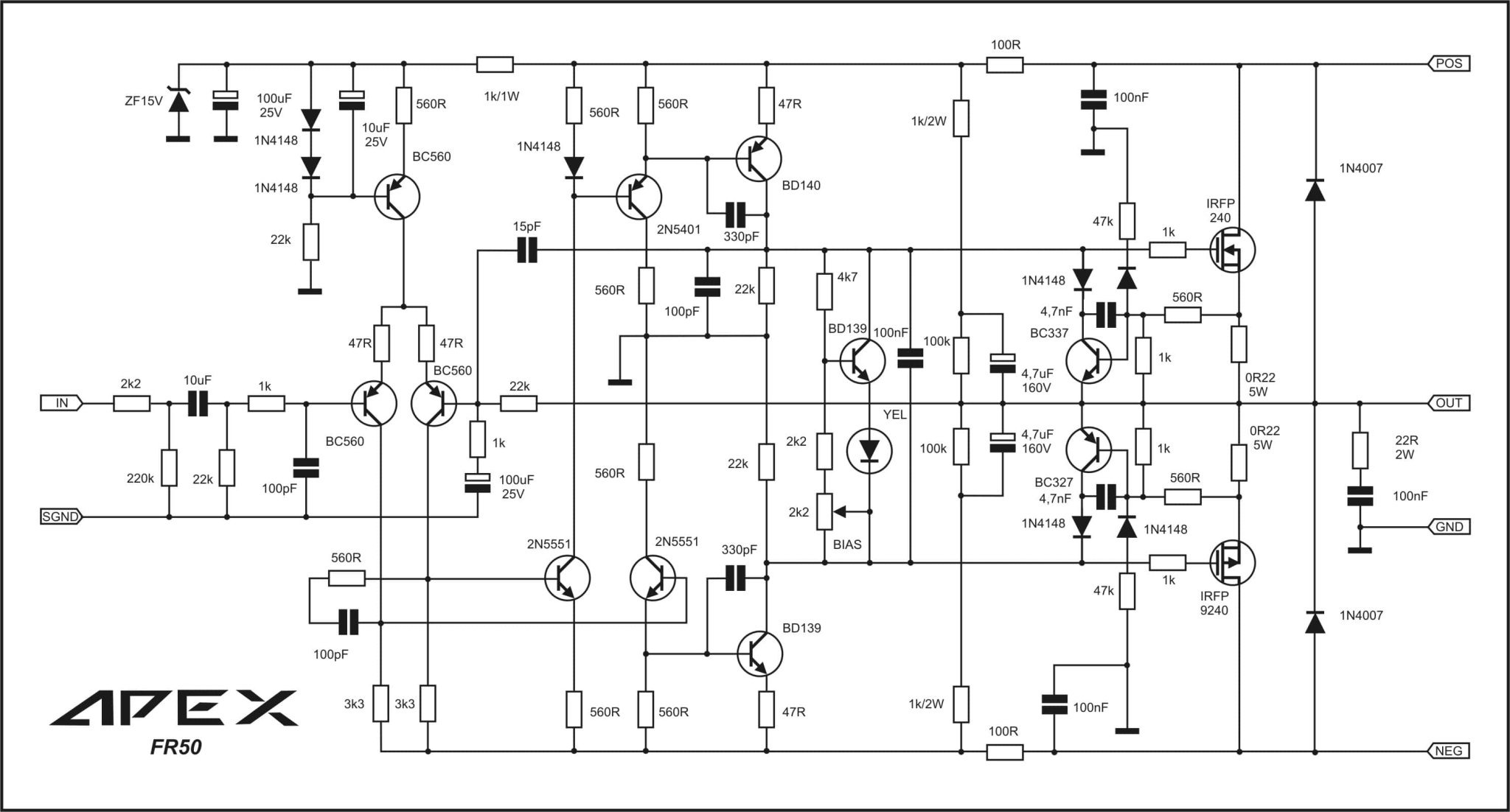

I would build an FR50 and as far as I can see hardly anyone makes amps with a separate regulated power supply for VAS. I would ask Mr. Mile or another expert is there any change on the schematic to use it with the PSU40 or just remove the 100R resistors. Thanks in advance
Has anyone else built FR50? Only OLAFK shared his impressions if I'm not mistaken...

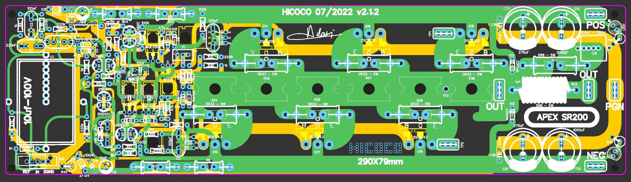

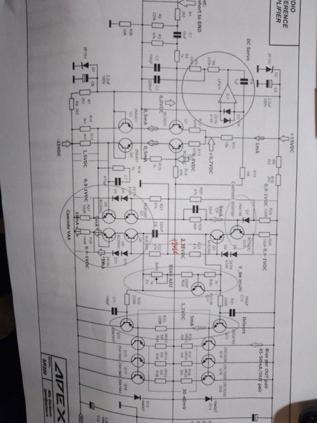

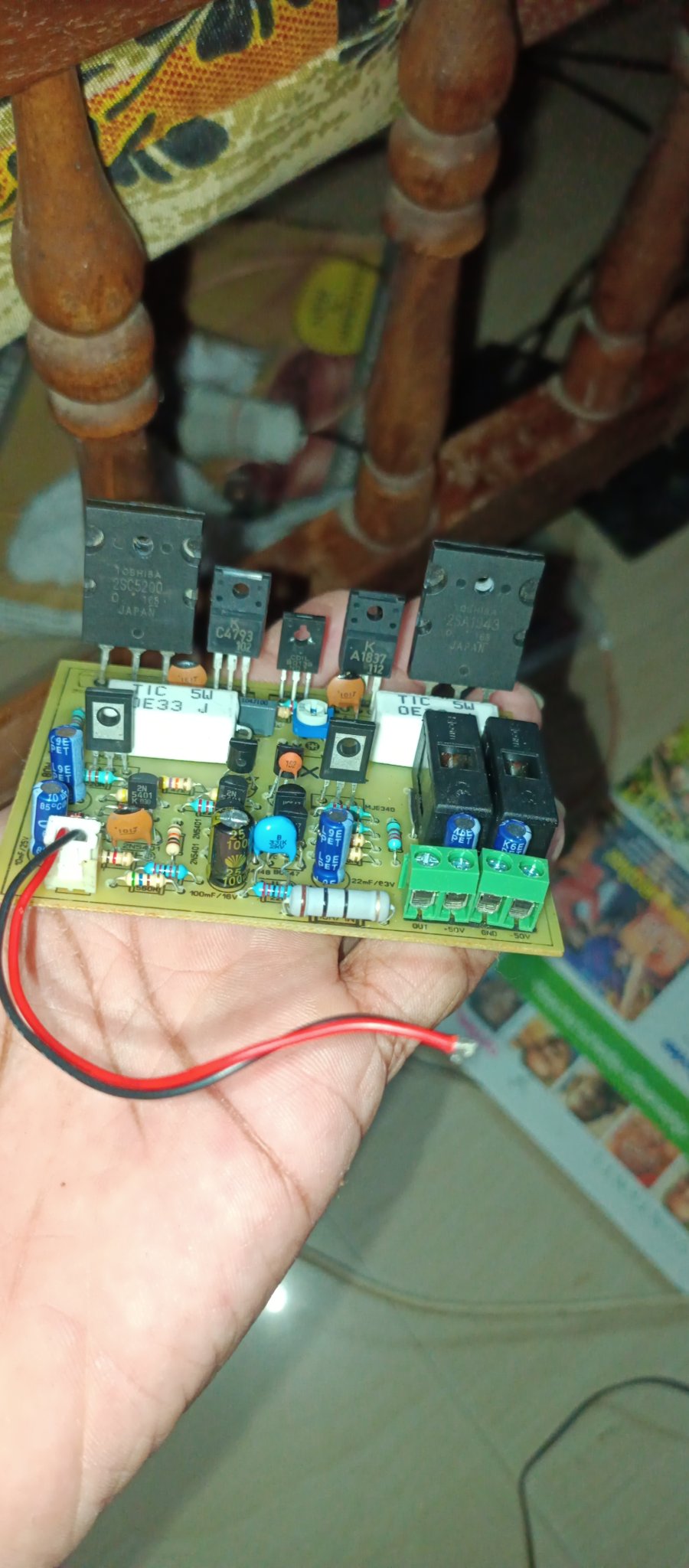

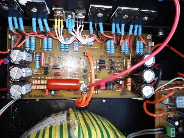

Greetings to everyone, especially Mr. Mile for his wonderful projects. The other day I assembled an SR200 amplifier, but I could not set the quiescent current, please tell what could be the matter?
Thank you in advance. (Sorry for my English.)
pictures or your actual build will be the first place to start. Did you make any changes to the schematics, make any replacements to the suggested transistors?
I ask, because the schematic is known to work, with numerous people having posted their working builds. So something is incorrect (either a part, or installed incorrectly) on your specific build.
I did not make any changes to the printed circuit board. All components are installed according to the diagram. But there is no 2.3VDC voltage between the MJE350 collector and the MJE340 collector, measurements at these points show 1.2VDC.( sorry for my English )
