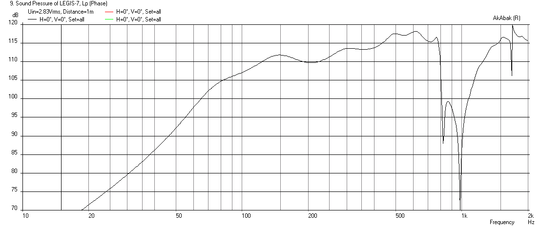

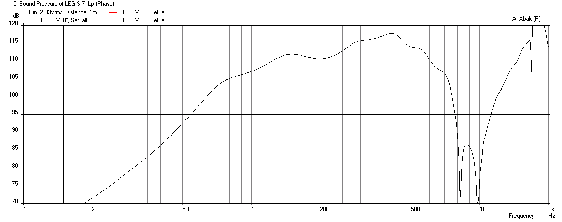

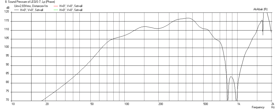

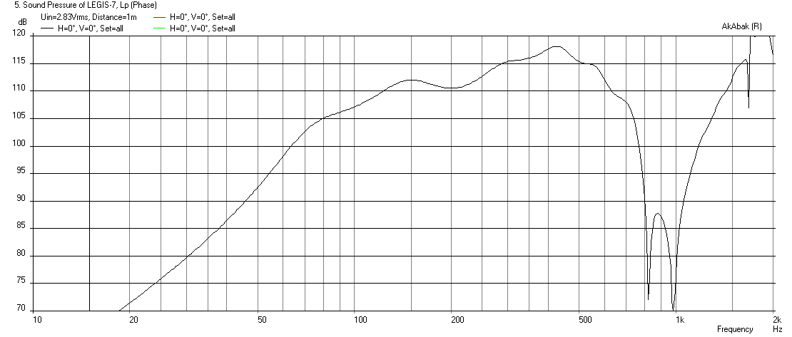

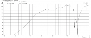

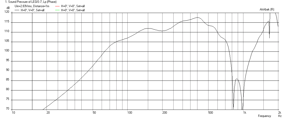

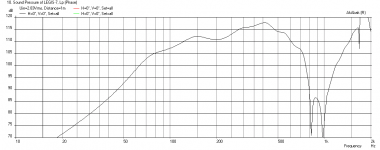

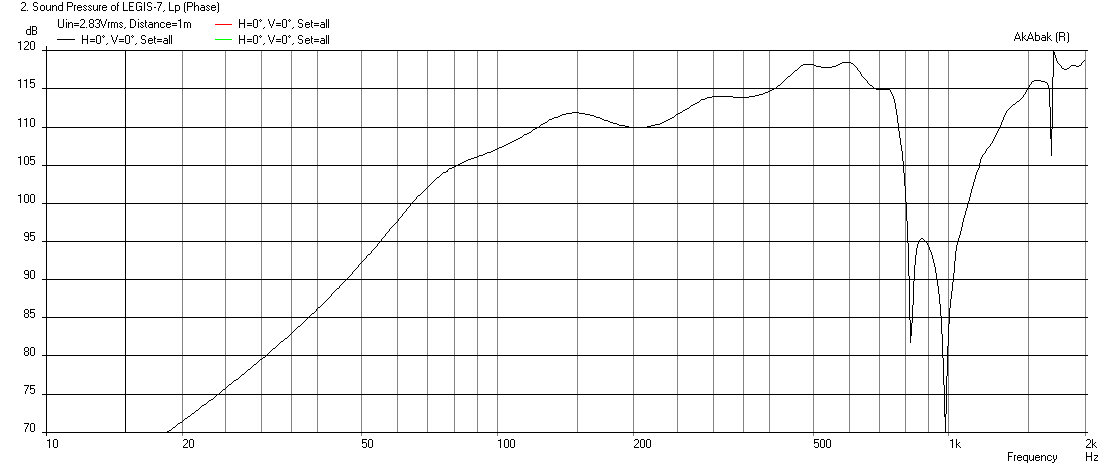

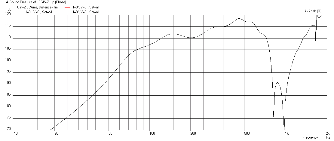

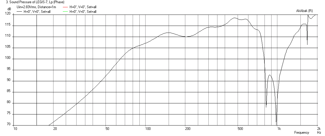

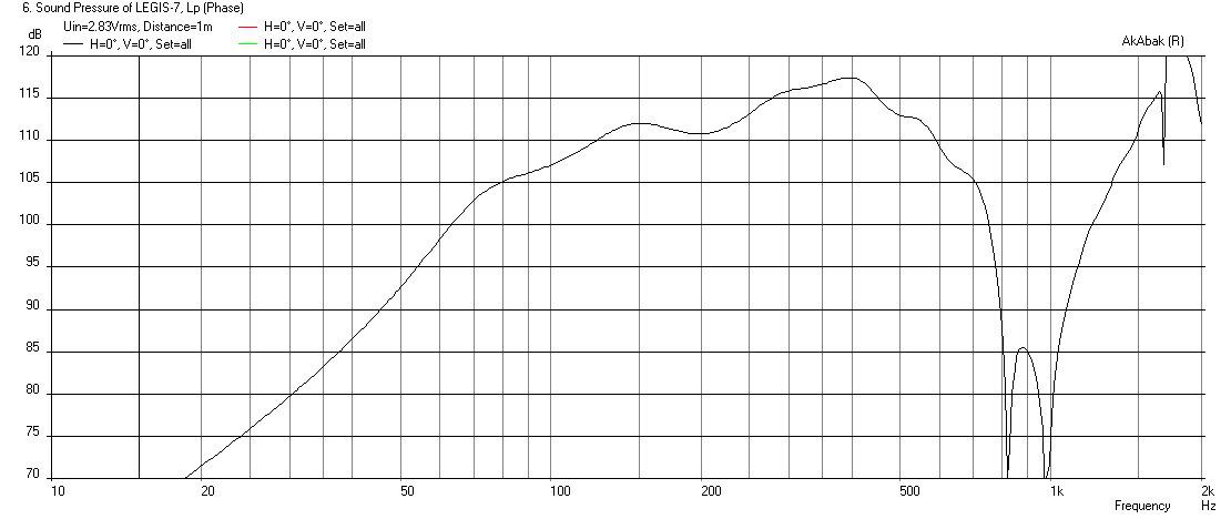

I forgot all about that - but now remember how you used rice. The last sim I ran for you I think I used 3.75 liters for the volume which includes the spacer. Here are the sims for the driver front chamber volume ranging from 0.5 liters to 5 liters:

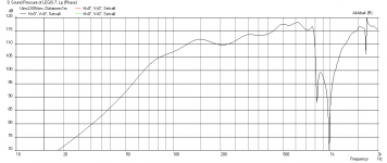

0.5 liters:
1.0 liters:
1.5 liters (this gets my vote as a nice option for higher freq extension to 700Hz if you build a volume filler insert):
2.0 liters:
3.0 liters:
3.5 liters:
3.75 liters (actual volume as-built):
4.0 liters:
5.0 liters:
Going from 3.75 liters to 1.5 liters is do-able I think as you are looking at about cutting the volume by about 2/3rds. Discs of foam core glued together would work, as well as discs of XPS (extruded polystyrene) home insulation pink foam sheathing,

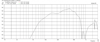

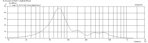

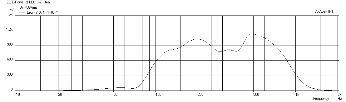

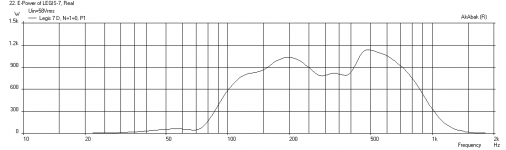

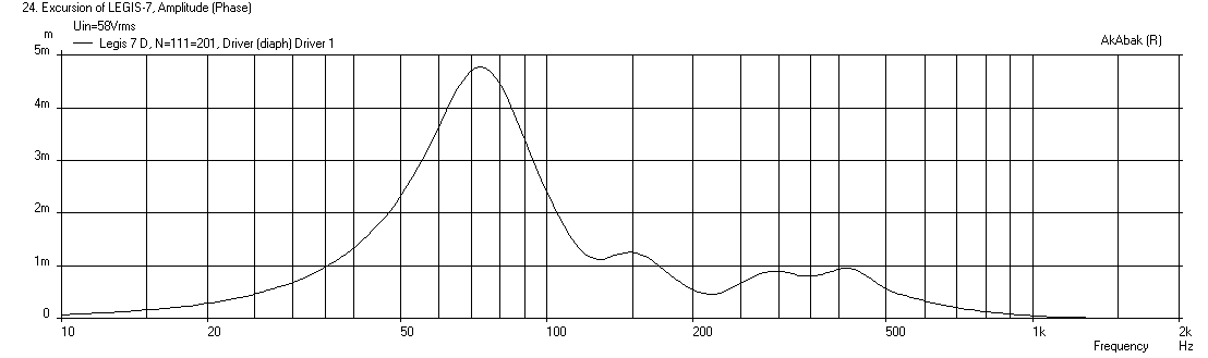

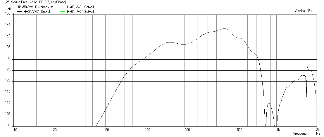

In case you ever wondered what your horn can do if pushed to max voltages, using a -12dB/oct HPF at 95Hz and a -24dB/oct LPF at 950Hz, it takes 58V to hit 4.8mm xmax.
Cone displacement at 58 volts:
Electrical power input:
SPL at xmax:
That is pretty loud, I mean like, stadium loud. 😀

I can use them now without any electrical filtering with good reults but it seems that it could/would be better with ~1-1.5 litres smaller front chamber. That reduction in chamber volume does not seem to steepen the xo slope too much/at all but extends the response somewhat higher what I'm looking for. Propably could be used with current settings, but the xo point (500Hz) could behave somewhat better.

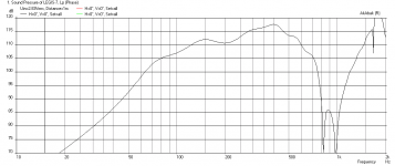

X, I noticed that the first null appear to be at ~730Hz in my measurements instead of ~800Hz at your sims. The second null is on the contrary somewhat higher than you simulation predicts (~1170Hz vs. 1000Hz).
I understand that the ~1khz null comes from the injection port's distance from the apex, but what causes the ~800hz null and makes the reality differ from simulation?
I actually never accounted for the inner horn part of the 2446J driver itself to calculation how far away the injection port is from the "apex" of the horn, but it seems that the null is still higher. Odd.😀 The center of the injection port is actually around ~21cm away from the "real apex" and the furthest part of the port is around ~26,5cm. Maybe the inner horn of the driver itself is too "tight" and the big radiating area of the Deltalites see it as very resisitive path and the waves don't travel there much at all so it's "invisible".
Legis,
I will have to look at it more carefully to see what the first null is sensitive to. It doesn't seem to move with chamber volume so I suspect it is tied to horn and injection port location geometry.

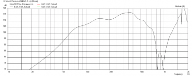

Quick test does not impress. I simply put 3 wooden "pucks" (total reduction around 0,5 litres per chamber) to front chambers with 2-sided tape. They are placed there from th injection holes, so the placing is not optimal. For some reason sensitivity went down a notch, initial low pass filtering increased slightly (also phase turns more at xo freq and the filtering of HF got worse). 😀 So exactly the opposite I'm looking for!
Red is the original, blue is the slightly filled front chambers.

That is strange - I wonder if it may have something to do with how smooth the airflow is inside the cavity. Did your pucks create some weird airflow pattern?
I would know, propably. But they were not that far of where I would put them. Since I have the injection port located at the perimeter of the cone, I'm afraid the filler pieces are always somewhat "in the way".
