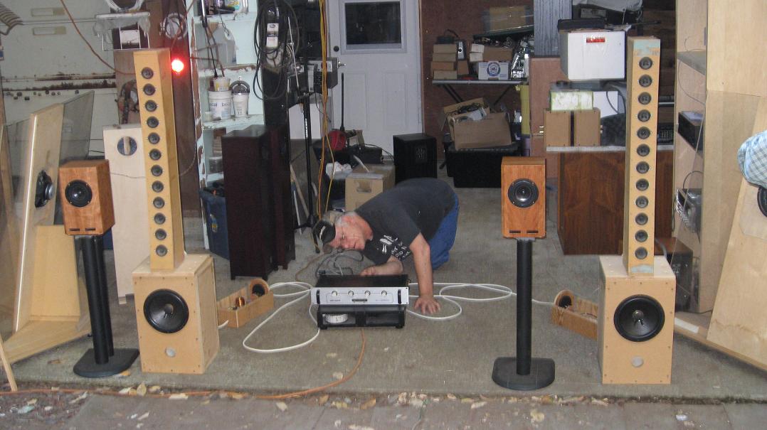

I simply avoided, like the coward that I am, all comb filtering, phase (timing) issues and other problems that I didn't want to deal with. That included tweeters, C2C issues and crossover difficulties were some of the difficulties that I avoided.
The array consists of twelve 1.5 inch (nominal) diameter drivers with some old Adire Audio AV 8 inch woofers crossed over (using a series crossover) at 450 Hz. The Bass unit is tuned to 33 Hz.
Voted "Best Midrange" at the RAW Fest (Canada), Kow Tow award at VSAC and 1st place in the 2-way class at "The Puget Sound! DIY Speaker Contest" (2010).
Total cost is right around $81.00.

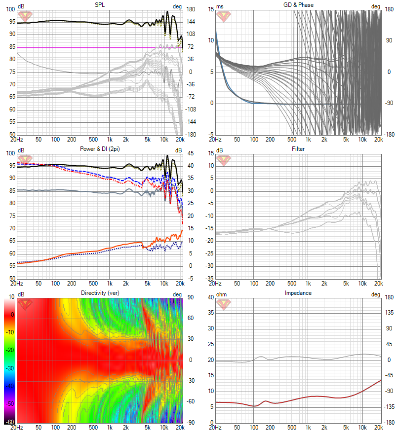

An array of TC9's has the most output around 250 Hz, at 2 meter it would show combing starting from ~8500 Hz and up. At larger distances this frequency will move up higher.
attachment.php
Note: the above sim was made for a listening distance of 2.7 meter. I just adjusted it to 2.0 meter to watch the effects.
One could make a frequency dependent shaded array to get rid of most combing problems, or at least move them up even further. I have added these type of filters to my array and I published the sims and schematics on my thread.

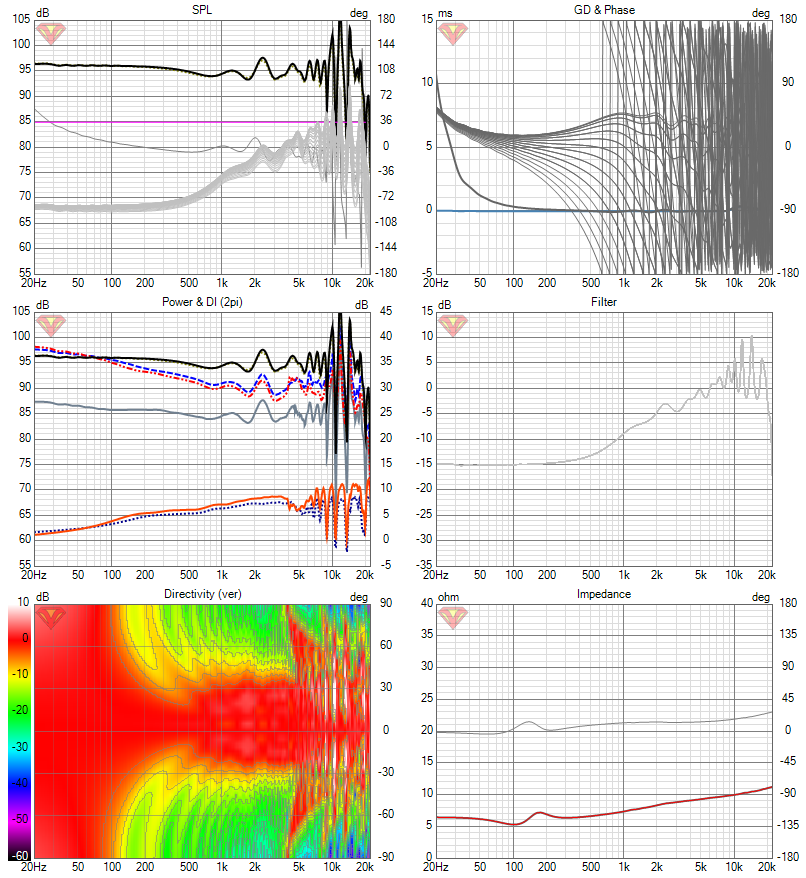

Here's how that filtered array looks at 2.0 meter:
attachment.php
Easy to see it has better vertical pattern control and combing moves up to 10.000 Hz+. Again, this sim was originally created for a listening distance of 2.7 m.
