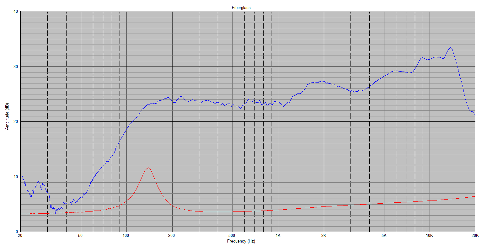

Out of the eight you tested, I own the Tang Band W3-1053SC which I use for surround sound. You are correct, they sound good but the bass is quite weak. The 2-way array allowed use of 5 inch woofers for SPL, bass capability and more Xmax. The 15-year old playing guitar drop D tuned guitar with his tongue should be OK. I would not pay the $16 each MSRP but bought in bulk at close out, the $60 for 24 of them eased the pain.
The Mark Audio CHR 70 Generation 3 has great specs, 85.5 dB, Fo of 65.4 Hz, 4.3mm Xmax and is a full range. Alas, it has a giant plastic frame which is 5.3 inches across. Maybe Mark will make a version with a cast aluminum frame cut across one axis to squeeze them in tightly? At least I know that those specs are possible and at $36 each for the CHR-70, they won't cost $500 to get something along those lines.
The tweeter line will start to beam at exactly 9,600 Hz or at the 1.41" center to center distance between them. I'm counting on the ear's reduced sensitivity to 10KHz and up frequencies to make this a moot point for non-critical listening. The Audax tweeters show 90dB at 4 Khz then it starts to rise to 93dB at 8Khz then taper down to 90dB again at 11 KHz. I set up the crossovers to be even at 4 KHz so the expected increase at 5 to 11 KHz will stay in place. After that, I'll have to EQ for beaming which is not much of a problem.
If I ever upgrade the things to twenty 3" driver lines, I'll then ponder the 10KHz+ beaming issues of the tweeter line. If running 3.5" full-ranges beaming at 4 KHz and up does not bother the ear--I don't see myself getting offended if the tweeter line beams at 10KHz.

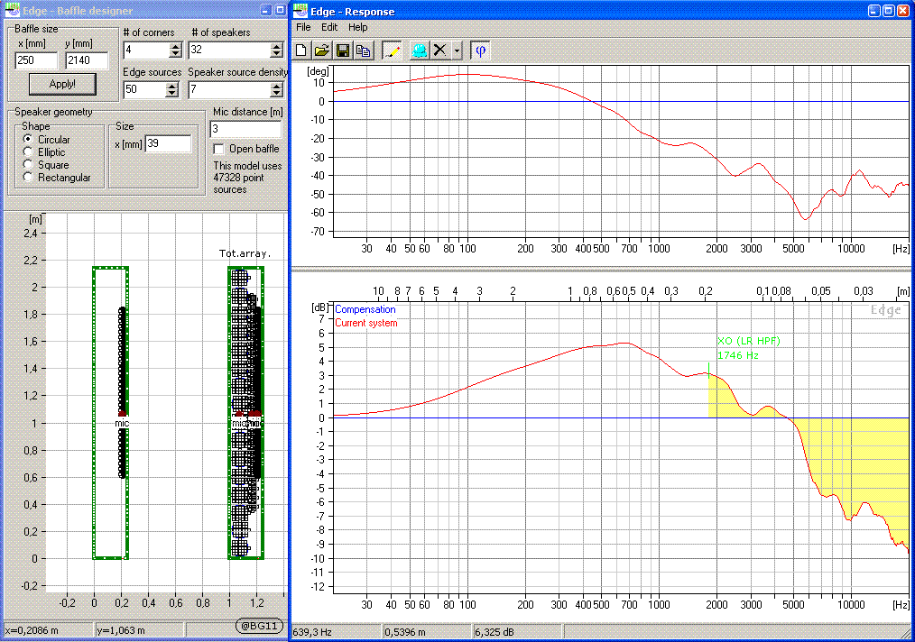

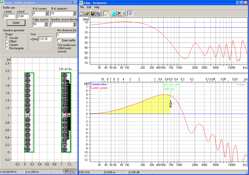

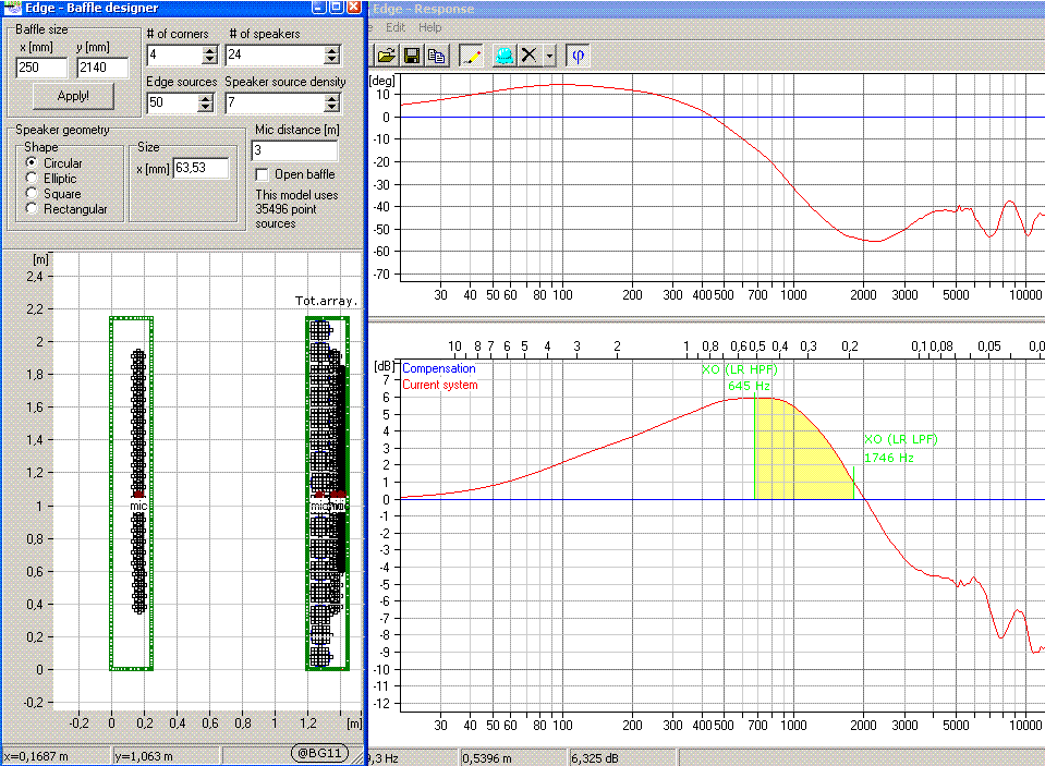

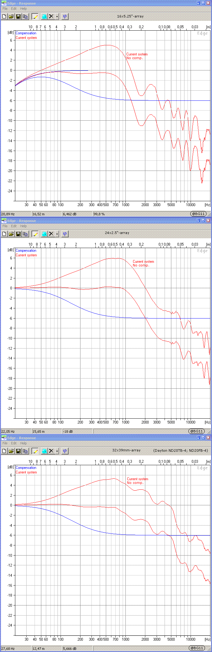

Agree...Myof hints:
http://www.diyaudio.com/forums/multi-way/193015-stupid-cheap-line-array-2.html#post2646635
b![]()
FYI: Supplement simulations(3-way near-field array) to the picture here-above by using Svante's Edge program:
b
b![]()

Went with a 4,300 Hz XO Linkwitz-Riley point at 18dB/Oct for the tweets and 12dB/Oct for the twelve 5" woofers.
There are a few downsides though--with basic tone controls I can't get the midrange smooth, it needs EQ.
The treble comes in and is a bit higher than the 5" woofers, EQ and padding will take care of that.
My C to C distance is 5.625 inches for the woofers or a wavelength of 2,400 Hz. I figure beaming issues from 2.4 KHz to 4.3 KHz give me some of my EQ requirements but it is not the end of the world. It is less than an octave and if I lose sleep or go OCD, those HiVi 3" speakers have a 78mm C to C for 4,400 Hz wavelength so.... there is a solution.
Initially, I was a bit nervous about crossing a 10mm dome tweeter with an Fs of 3K at 4,300 Hz. The LR -6dB slope at the crossover frequency coupled with the 18 dB filter cured my paranoia. There are 48 tweeters in the line so distortion or destruction is not an issue.
My mods are to get some EQ in there to smooth the mids, bring up the bottom end with a subwoofer and pad in some resistance to the tweet line to finish it up. The sub build is next since a party is scheduled in the garage on 11/11/11 complete with BBQ, brew and music. They are garage/party/PA speakers after all.
Normally, they are operating at around 1 to 3 watt peaks in the garage. Since I'm walking around, standing up, sitting down or getting on the floor--the line sound works well for my uses. If I quickly stand up I can hear a little beaming in the mids so jumping around on a pogo stick while listening critically is not suggested.
All in all, the line arrays make a unique speaker with a big sound that works in the acoustical nightmare garage. Although not perfect, they have a unique sound stage that puts a grin on my face. My point source HT system in the house need not worry--yet.

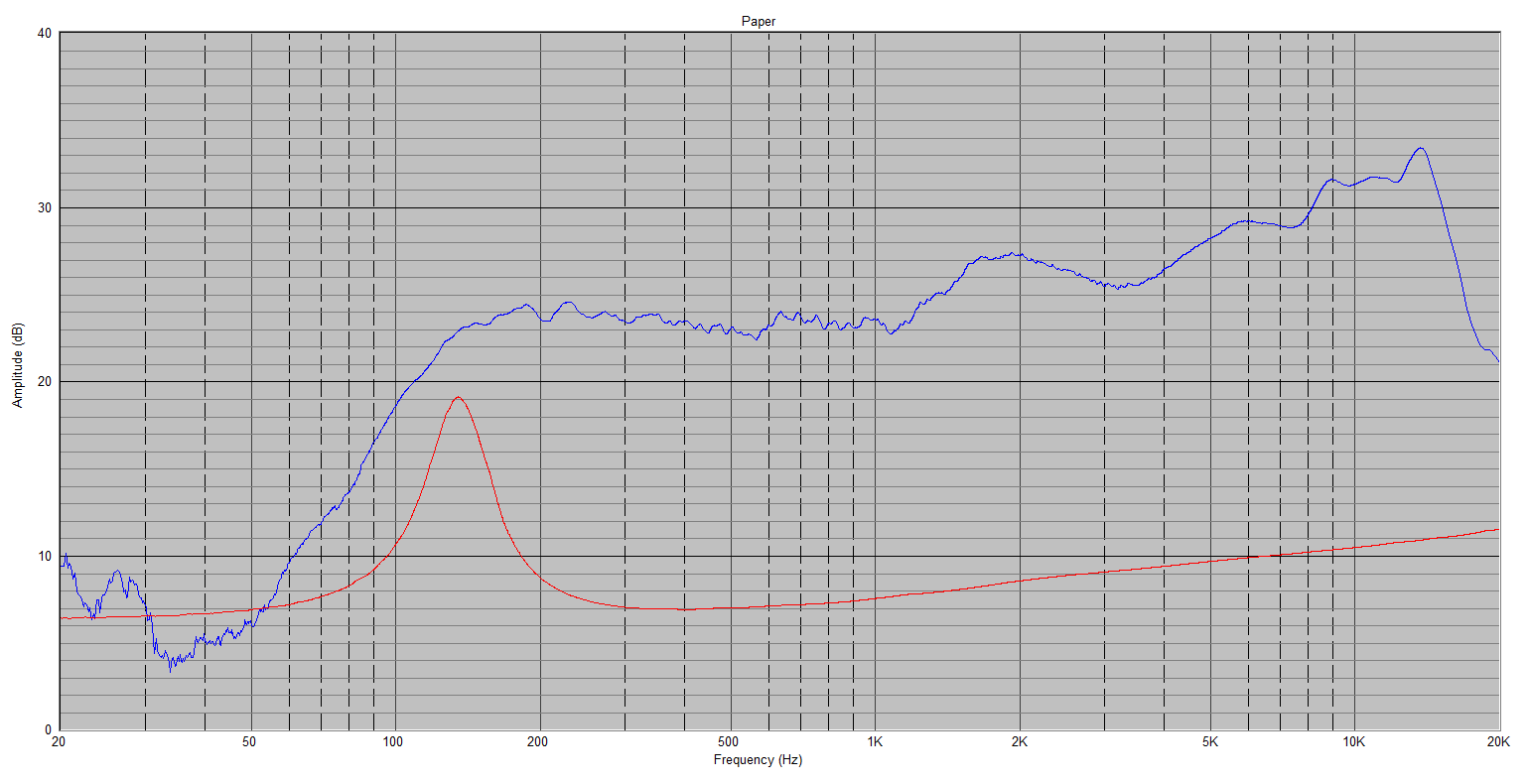

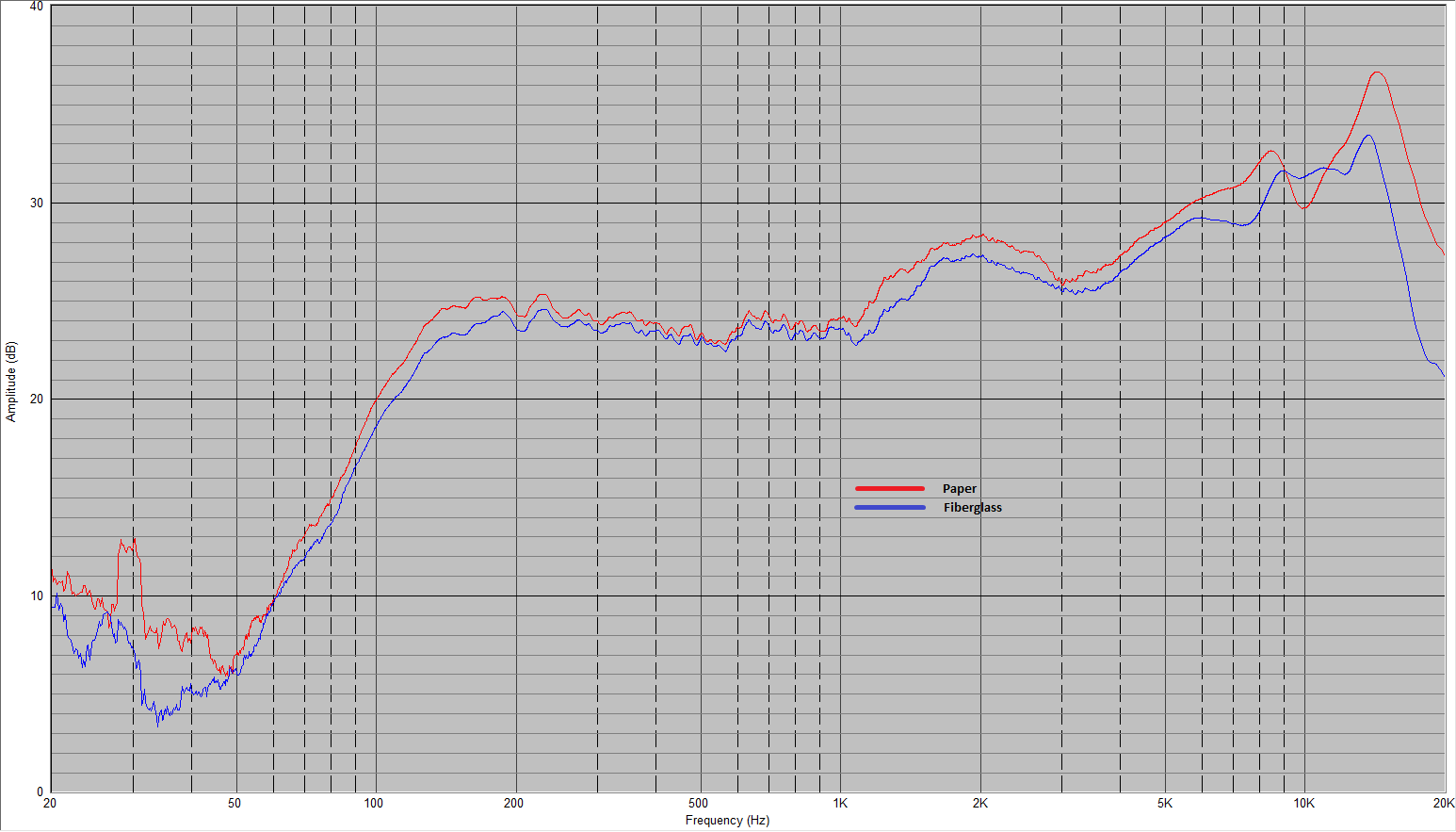

wesayso:
Sorry for not getting back to you sooner... I stopped getting notifications on this thread for some reason! hopefully I'll catch you in time.
I find the spec sheet fiasco with those drivers to be a huge disappointment from DST. Usually Vifa and Peerless are pretty good with datasheets, but with the 3" versions it's a real nightmare. I basically didn't bother with the datasheets (after reading 4 different conflicting sheets for what appeared to be the same driver) and I just bought them and measured them.
I can verify that the fibreglass driver (the one I think Roger Russell uses) is exactly the same in terms of acoustic response and resonance as the paper cone drivers I used. I've attached some measurements I made of both drivers in the exact same enclosure for reference. The only difference is that one is 4 ohms, and the other is 8 ohms. Both measurement were done at 1W and amplitude is not absolute, but is correct in relative terms.
The drivers in these measurements are these:
Vifa TC9FD-18-08 3-1/2" Full Range Paper Cone Woofer 264-1062
Vifa TG9FD-10-04 3-1/2" Glass Fiber Cone Full Range 264-1064
I can't vouch for any other driver from any other source, as they may indeed be different.
For what it's worth, I really do like my arrays, and fully endorse them if you're thinking of building a pair!
