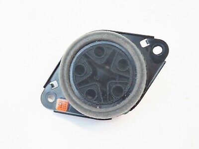

This is what the paper tweeter in the car looks like:
And this is the "high-end" harmon kardon version. The version I have looks pretty much the same with no star shape or dots.
It does look like car tweeters try to limit the off-axis a little but this observation is based on a sample of 2 extreme car tweeters. The foam ring is used to seal the tweeter to the dash. The woofers do the same.

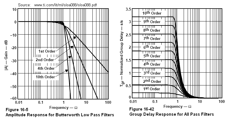

I am curious about introducing delay with a passive network. I know it is not ideal but wonder what a sim will say. My guts says "DSP!DSP!DSP!".
My last dsp XO used a LR8 on a woofer and a LR4 on a tweeter to make a GD hump inside the XO. This caused the XO to fill in. But I never thought to use it to delay this way.
