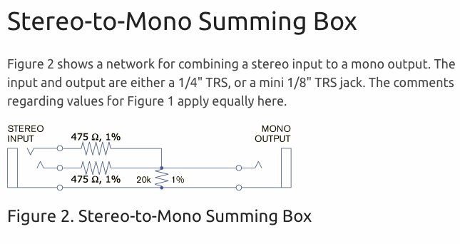

That said, since plenty of bass is not mono, the two voice coils will not see the same waveform, and the difference will largely turn to heat rather than sound output.
https://www.diyaudio.com/community/threads/is-there-in-bass-no-stereo.412211/page-3#post-7679141
Simple solution to that problem is to mono the sub input:
https://www.ranecommercial.com/kb_article.php?article=2106
RCA connectors can of course be substituted for the TRS, and the resistors can be heat shrunk or taped in the cord set rather than put in a box.

I can indeed use resistors to make the low pass output of the crossover mono.

What I might do is just get that amp when its available and try it with the Sony driver. I can sum the output of the crossover to mono inside the crossover itself.
