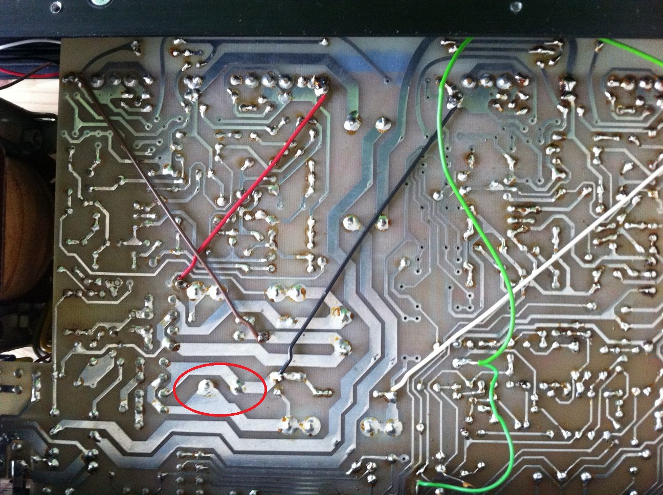

I've done some investigations and finally found a faulty cap, the one within red circle.
When I touch it while playing the hum appears, so I think it needs to be replaced.
I haven't check his solder pads, but replacing after more than 30 years seems to be a good idea.
Do you have some refs to suggest me ?

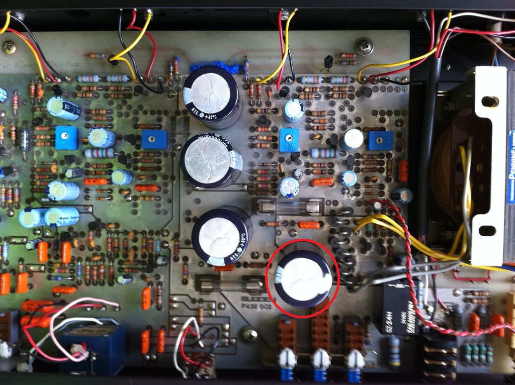

The original value is 4700uF/80V & the other upper pair is 10000uF/35V rated.

Phil,
I find it highly doubtful a capacitor of this type could create the problem you are describing. A bad solder joint is more likely to be the cause.
Replacing the capacitors would definitely be a good idea since it looks like none of them have ever been replaced. I usually use ECO-S2AP472DA and ECO-SH1A103DA for the large ones. Do not forget the small ones as they need attention too. Look at the capacitor between the two right side blue trimmers. The external jacket shrunk because it has been exposed to too much heat. I am pretty sure the other capacitor beside the relay is compromised too has they usually are the first one's to die. Be sure to verify the one just between the twisted brown and red wire, my memory tells me this one too should be replaced. All the other ones should not be in too bad a shape but if you have the time and patience, you should verify them all. If you have a constant low level hum, it is a sign that some of them lost much of their capacity.

Hi Michel & DennyG
Your'e absolutely right Michel : bad solder join confirmed, trouble solved, no more hum.
As shown on first pic, one 4700uF/80V was concerned, checked the others big cans : Ok.
Then checked DC output and noticed it to be low enough to fire the amp.
Works fine BUT only on Left chanel, Right one is mute or plays at very very very low level.
More to investigate... but where to start from ?

Second pic shows the relay cap to be replaced.
This one is 10uF/100V rated. Unusual value to me.

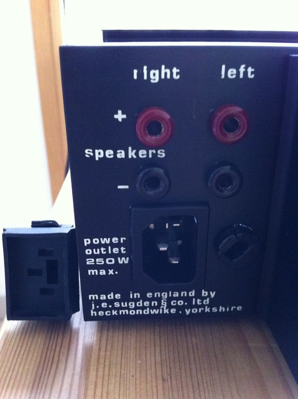

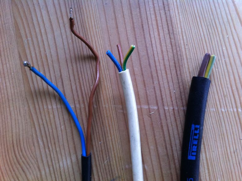

I've replaced the guenuine "poor" power cord and added an IEC socket.
First pic : left/middle = old wires - right = new copper wire 😉
Second : IEC replaced, fits fine.

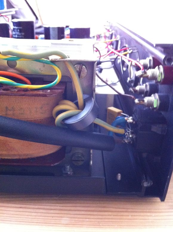

Third : detail of IEC with X2/Y2 caps and Earth coil.
