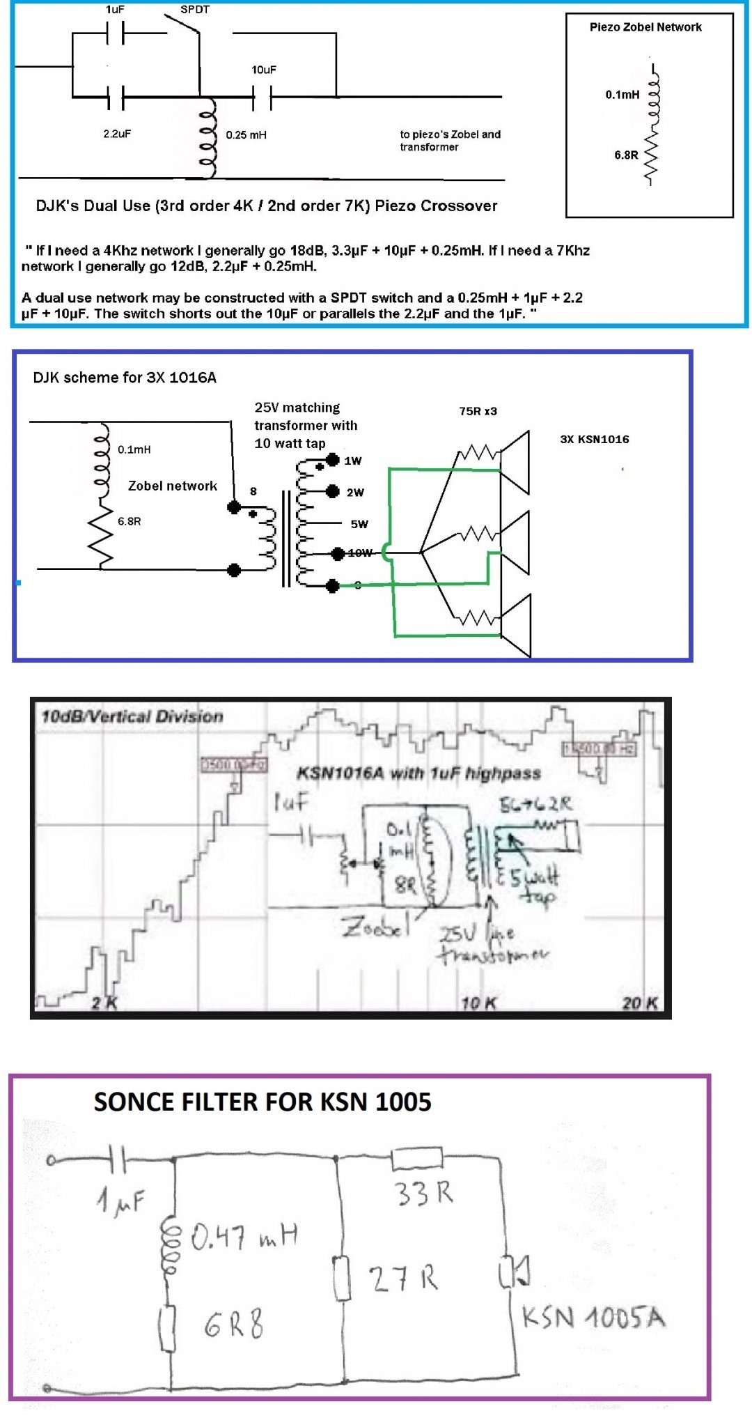

good quality piezo tweeters can work well and due to their characteristic, can achieve voltage sensitivity of around 103dB for 2.83v input when driven with a step-up transformer.

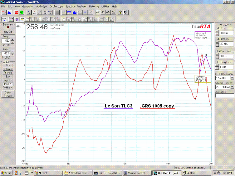

LeSon piezo tweeters have a built in stepup coil and are usually smoother than generic copies of CTS/Motorola.
The late Dennis Kleitsch / "DJK" gave suggestions on using piezo with stepup transformers. MMJ has covered that too in a thread with Brian Steele's "Frankenpiezo".
Diyaudio member Sonce posted a good filter for a lone KSN 1005

In parallel and at VHF the capacitor nature of the piezo will look like a dead short so you could have a resistor of 30-56 ohm per piezo or if they are tied in parallel banks, one resistor per bank

Thanks for the circuitry recommendations and that's certainly an interesting story! I hope the UPS driver wasn't too frightened by the faraway noise!
