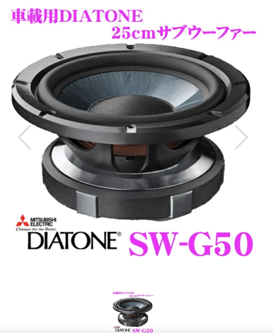

I was think 2 x subs probably 15-18 inches, with their own amplification not sure of brands, because outside of Diatone (I have their outstanding SW-G50 car sub) I’m not sure which prosounds subs are recommended. I can source various subs here in Australia via store or internet.

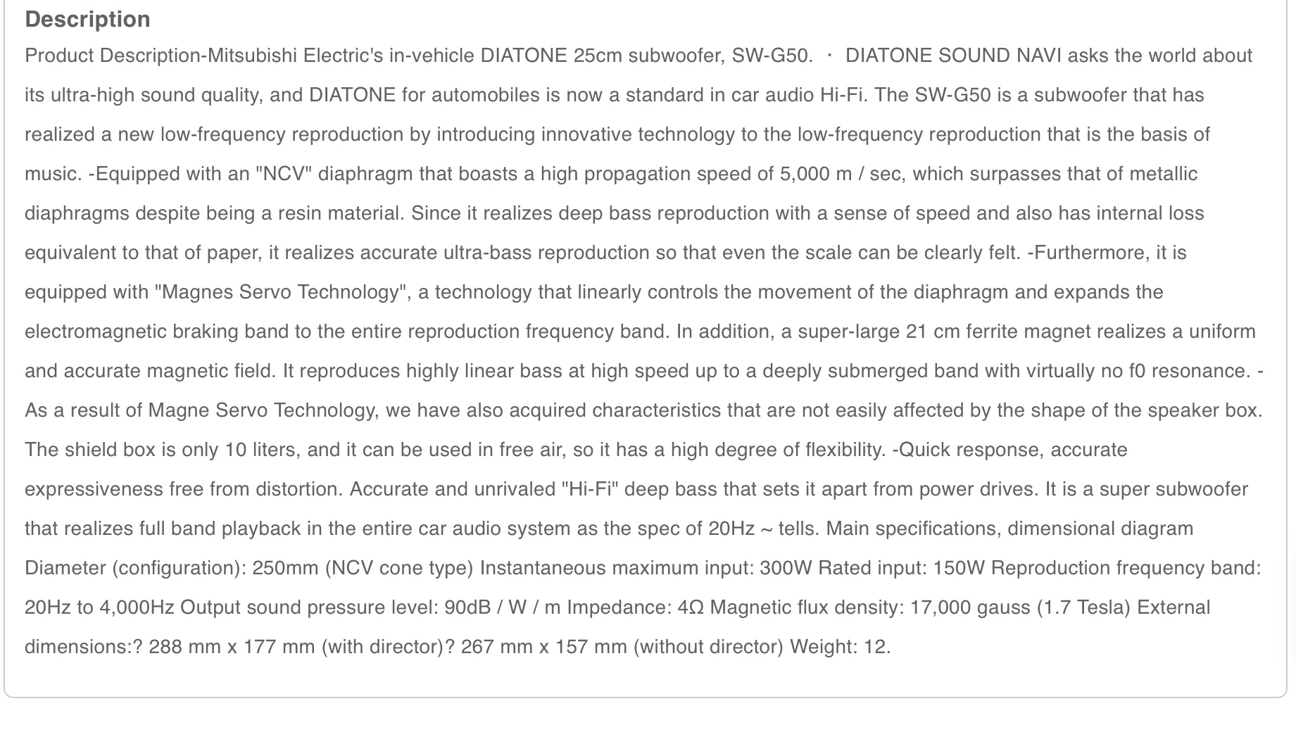

I have attached a couple of pictures of the sub and info as they are Japan only. 7F5CB40D-1BF4-4C30-8BC1-C14F4469C2DD.jpeg

Well, what little info they give indicates it only is useful to 20 Hz and implies 90 dB/W, which normally is spec'd midband, but no T/S specs to figure ~the frequency where it is, but says the driver is suitable for free air apps, so probably will be at > 80 Hz.
Regardless, servo control subs are normally designed for a specific box and the 'free air' implies sealed and further indicates it only needs 10 L, so without any vehicle cabin gain, doesn't sound like it's of any use to you in the home. Bet it's quite a performer in car, which is.....?
Really need the T/S specs and any manufacturer's manual, etc., to know for sure.
