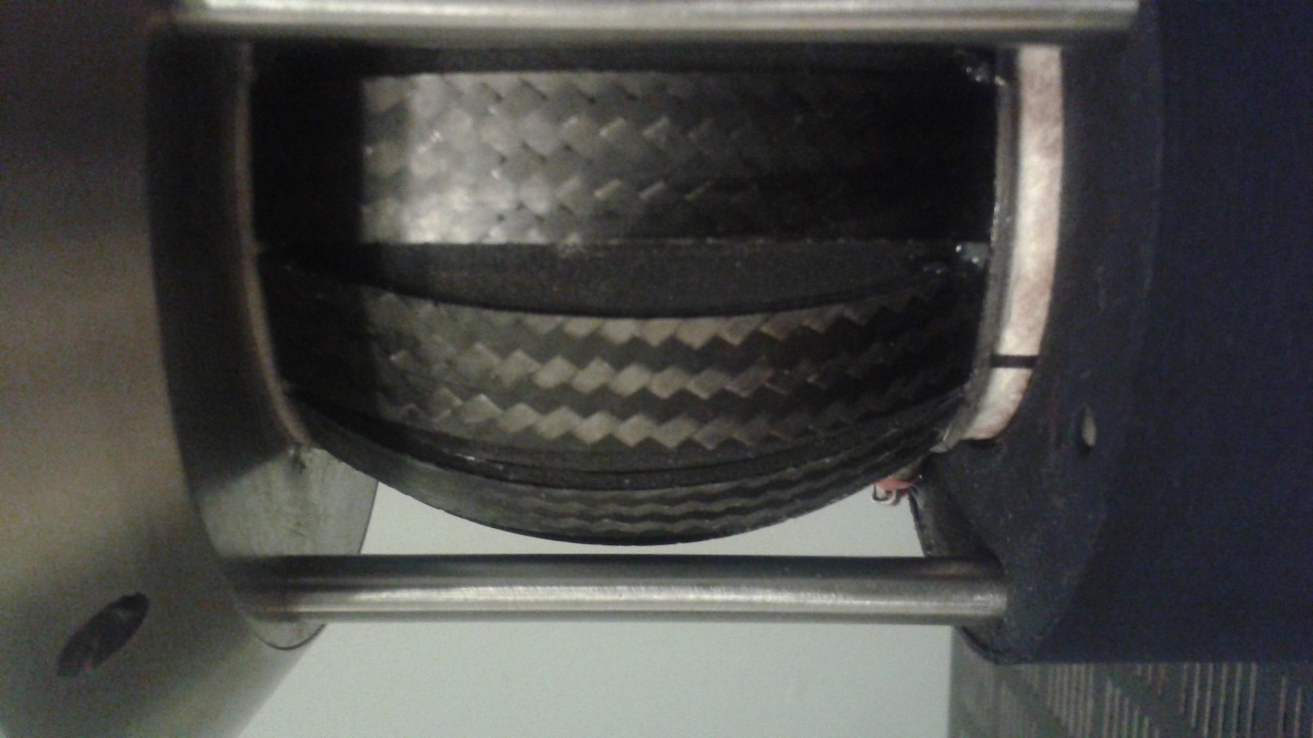

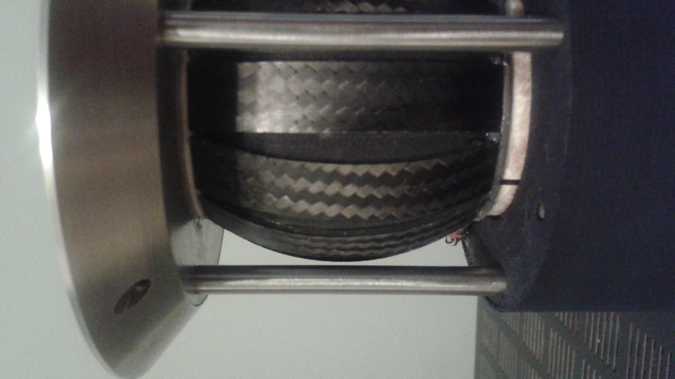

The air leak will be simple, the mechanical vibration could be a much greater concern and problem to solve. Do you have any idea what is making the noise, is it from the lamellas themselves or some other source? I'm still not a fan of the epoxy resin carbon fiber combination but we will see. A few air entrapments in the laminate would be all it takes to cause a problem with an internal noise in the lamella.
And degassing + vacuum infusion should prevent that from happening :)
Gubrin/Steve
Gubrin I am sure it would A diy degassing chamber isnt too difficult it would probably cost around 120$ for both and a little learning curve. Steve my laminates aren't too bad. The air leak is pretty simple the mechanical vibrations is actually just a lamella hitting a support rod on large excursions For some reason the rod sits closer than all the others it may not be plumb. I am open to any ideas. Degassing and infusion is a good one.

Took the time to play with my creation seems I was right. The thing is absolutely clean I adjusted the support rod and their is nothing no noise just music. I really only have to put the stand back together and purchase a new microphone to make an update worthwhile. New images will be taken.
how do you guys feel about this construction quality?

...and as for success following a little 'playing around'...EXCELLENT! Good for you, David. That a careful 'tweek' or two makes all your work and commitment jell is, as is said, Priceless... ;)
Enjoy...and contemplate where to go next... *S*
(...and BTB, it still looks first rate...)
