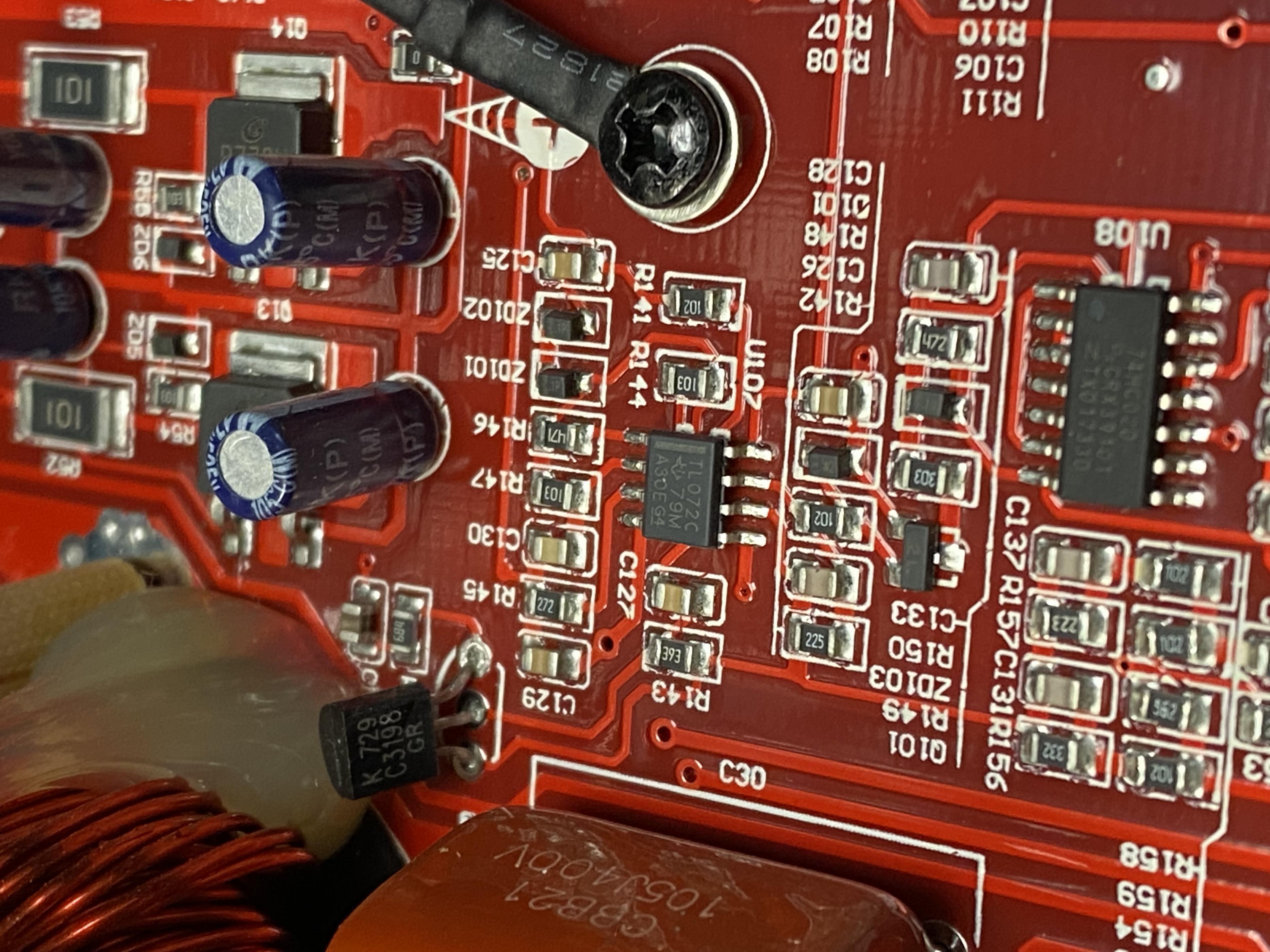

Amp is producing rail and regulated voltages .
Amp has output but it’s very distorted like someone is farting through the test speaker .
Any idea on where to start looking since everything I’ve checked so far tests fine

Is the audio out of all of the preamp ICs clean?
Does it ever lose r-r oscillation when it's doing what you described?
U1 and Q1?

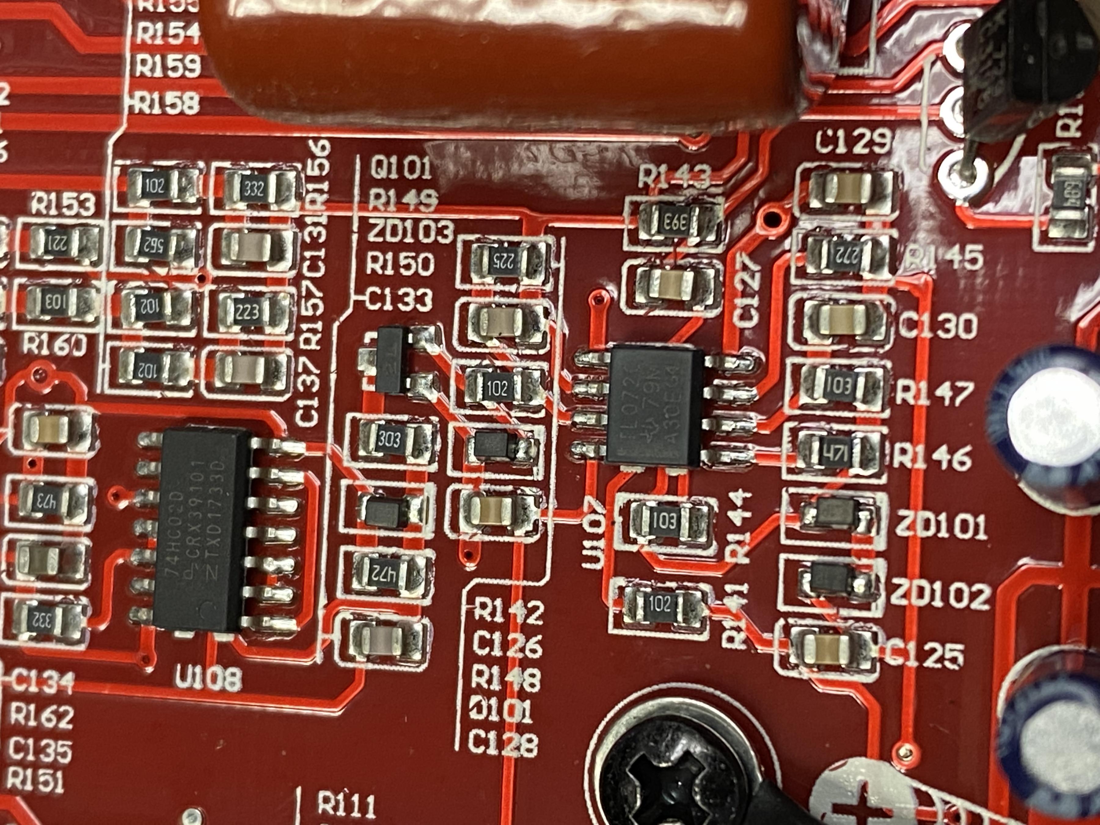

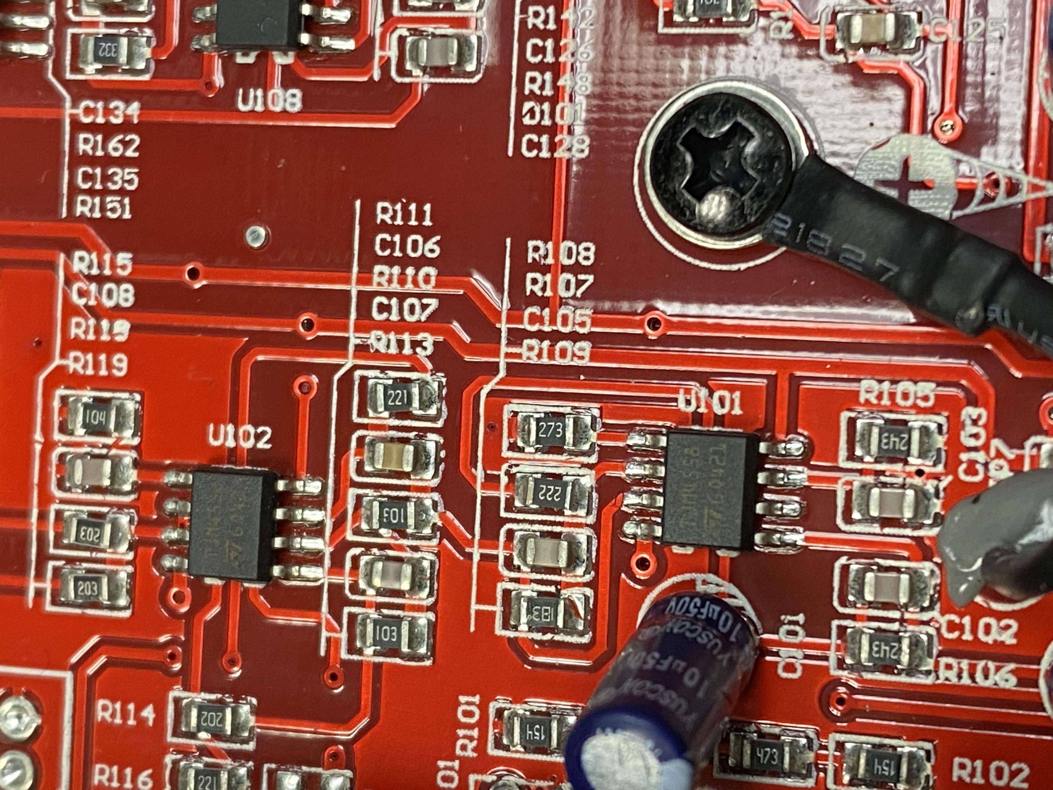

Here’s some more pics of the opamps and the transistor

Do you happen to know what driver ic they are using ?
The one in the amp is defaced .
So I know which pins are the input pins

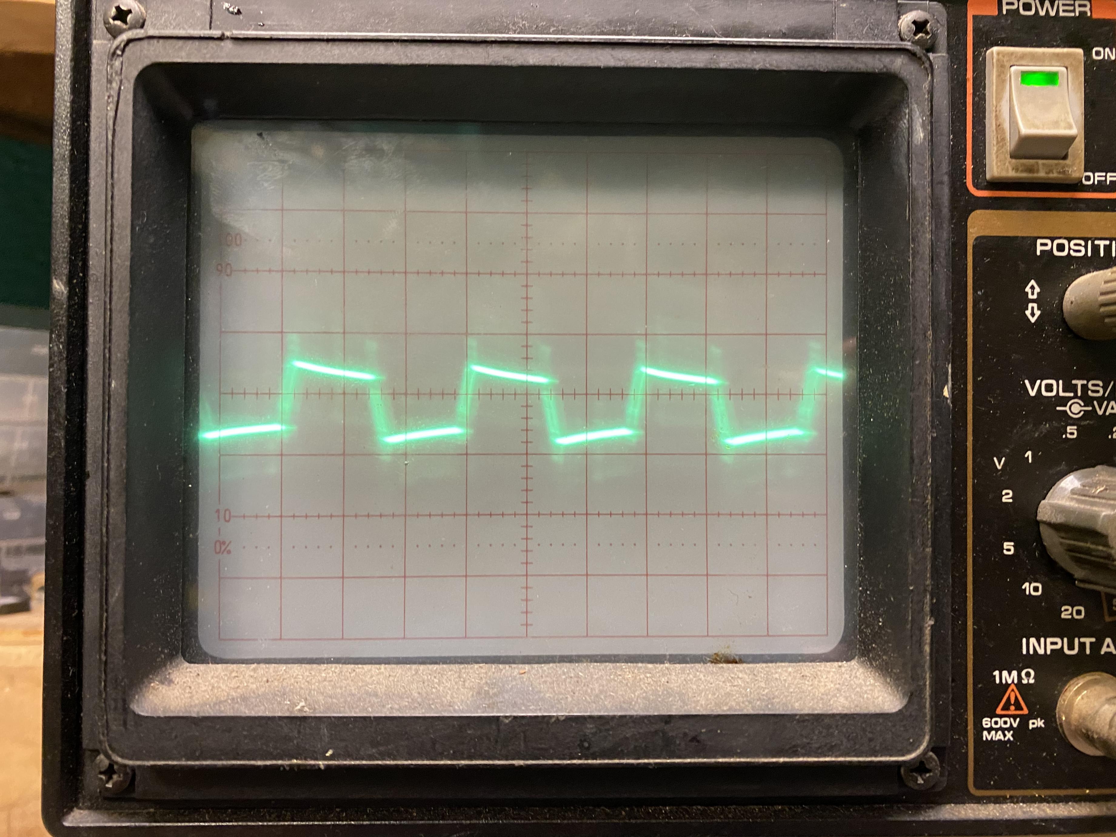

You're using the wrong ground to be using such a low vertical amplifier setting. Use the negative speaker terminal.
Vertical amplifier setting that low are rarely useful on class D amplifiers. They all pass carrier noise to the output, some more than others.
So I should ground the probe to the negative speaker terminal and set scope to 10us 2 or 5 volts div?
I’m just wondering if it’s normal to have a square wave on the output terminals with no signal .
With just power ground remote hooked up I bet a square wave on the output terminals was wondering if that’s normal ?
Trying to track down the issue with this amp
