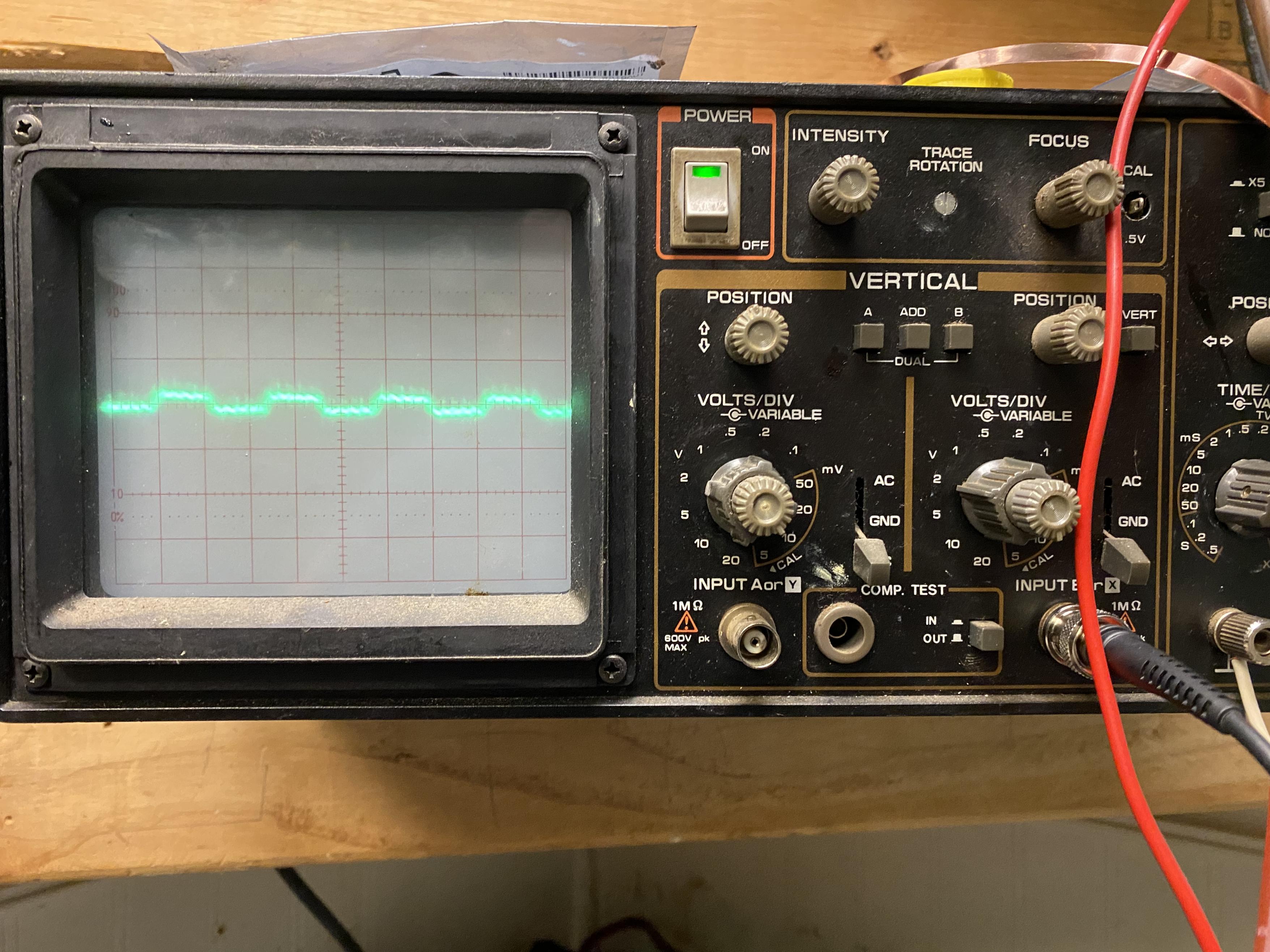

For amps that have a bridged output, you may see a small square or triangle wave on both output terminals. For amps with a negative speaker terminal connected to the secondary ground (this amp), if you see noise on the ground (negative speaker terminal), it means that you aren't using the right ground reference.
For 99%+ of the time, using the 12v supply ground for the scope ground is perfectly fine. When you're using very high sensitivity (low vertical amp settings), you have to use the correct reference. That's the secondary ground/the negative speaker terminal.
I wouldn't worry about the noise. It's common on most amps. Personally, I never worried about carrier frequency noise unless it caused a normally well focused trace to become significantly wider (2-3x wider)when the scope was set to 2ms and 5v/div.
If you're still concerned, go back with your original scope settings and look at the output with a load and the scope grounded to the negative speaker terminal.

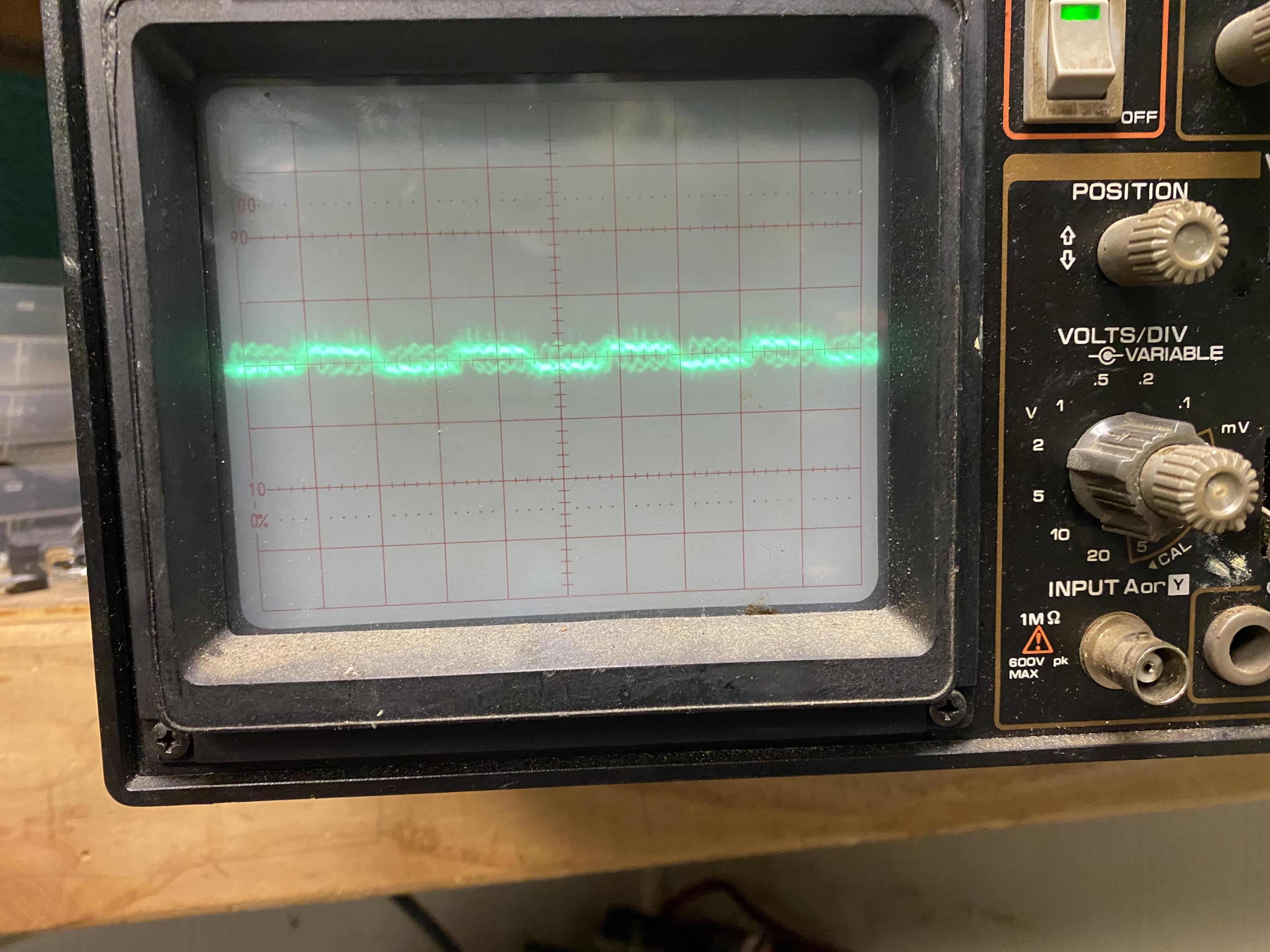

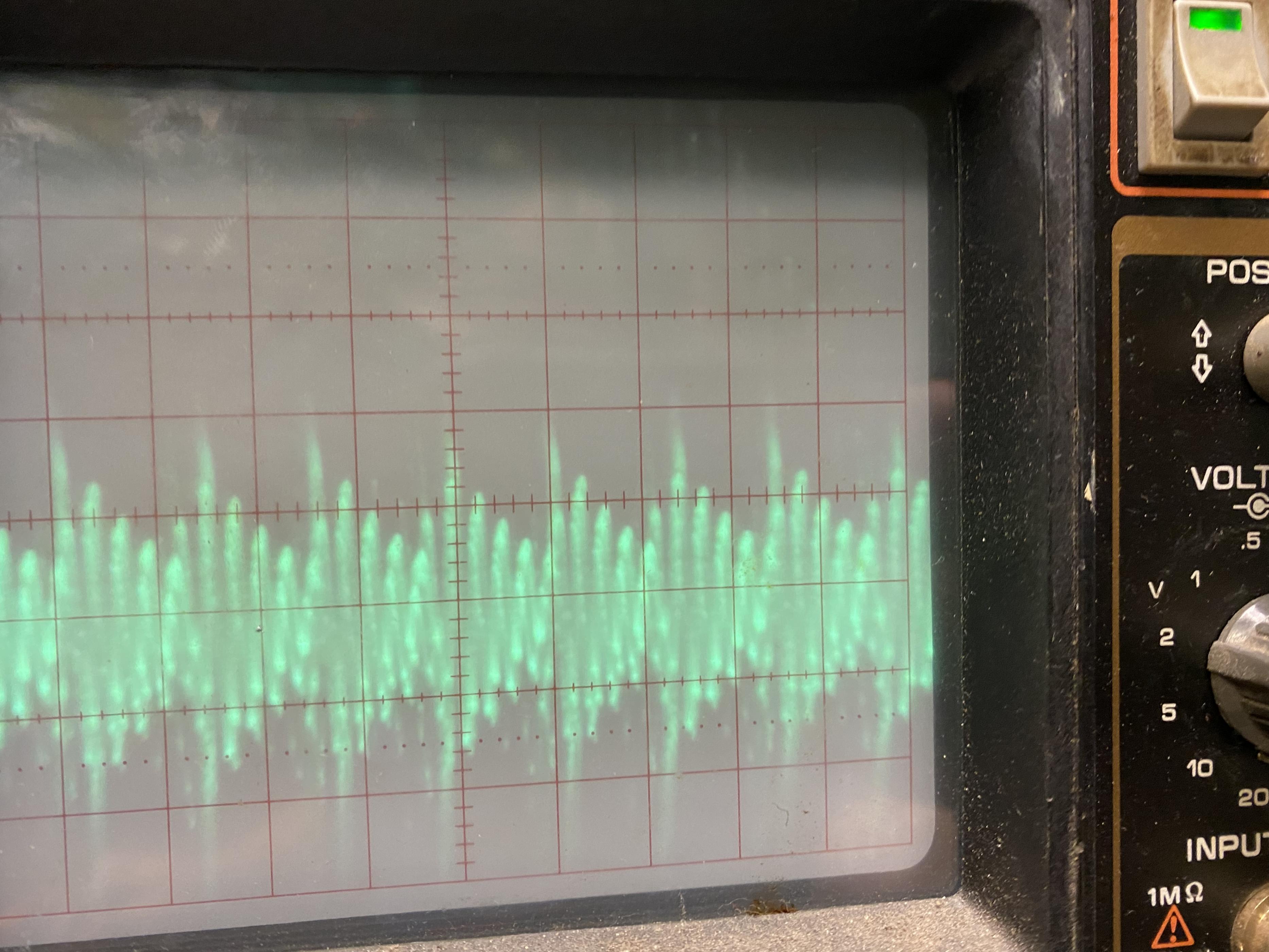

Ok I’m going to back track a lil on this amp .
Here is what I get on the gate leg for both high and low side fets .
Scope is set to 10us 2volts/div
This is with no signal
Do theses appear correct or what’s the next step ?
To me the square waves look very noisy on the scope .

If your meter has a frequency mode you could use it. That would be very accurate but I'm just looking for a ballpark.
What's the timebase setting that will show about 3 full cycles of the waveform.
Do you know what the scope settings were?
Was it locked on the signal to show just a few cycles?
