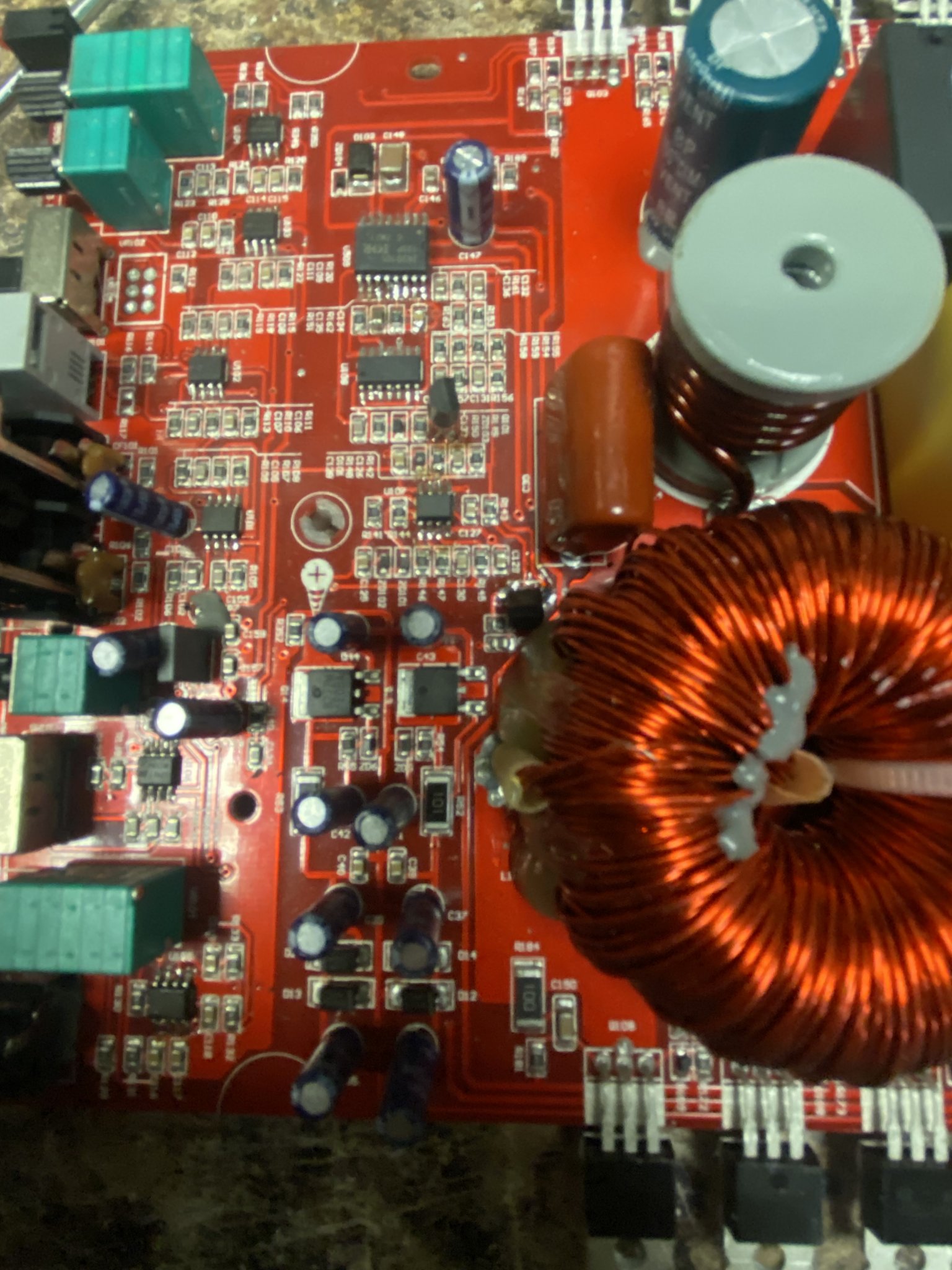

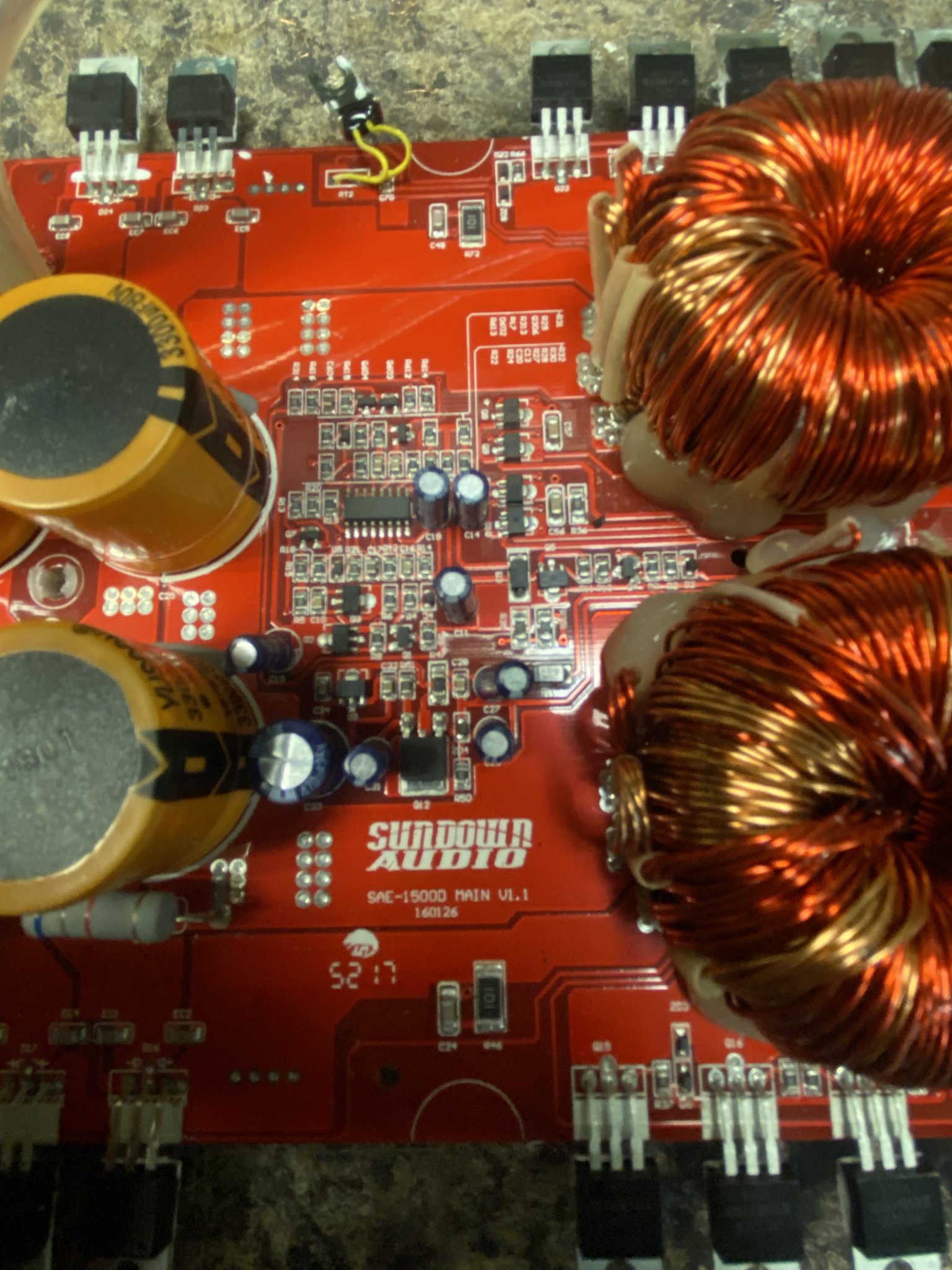

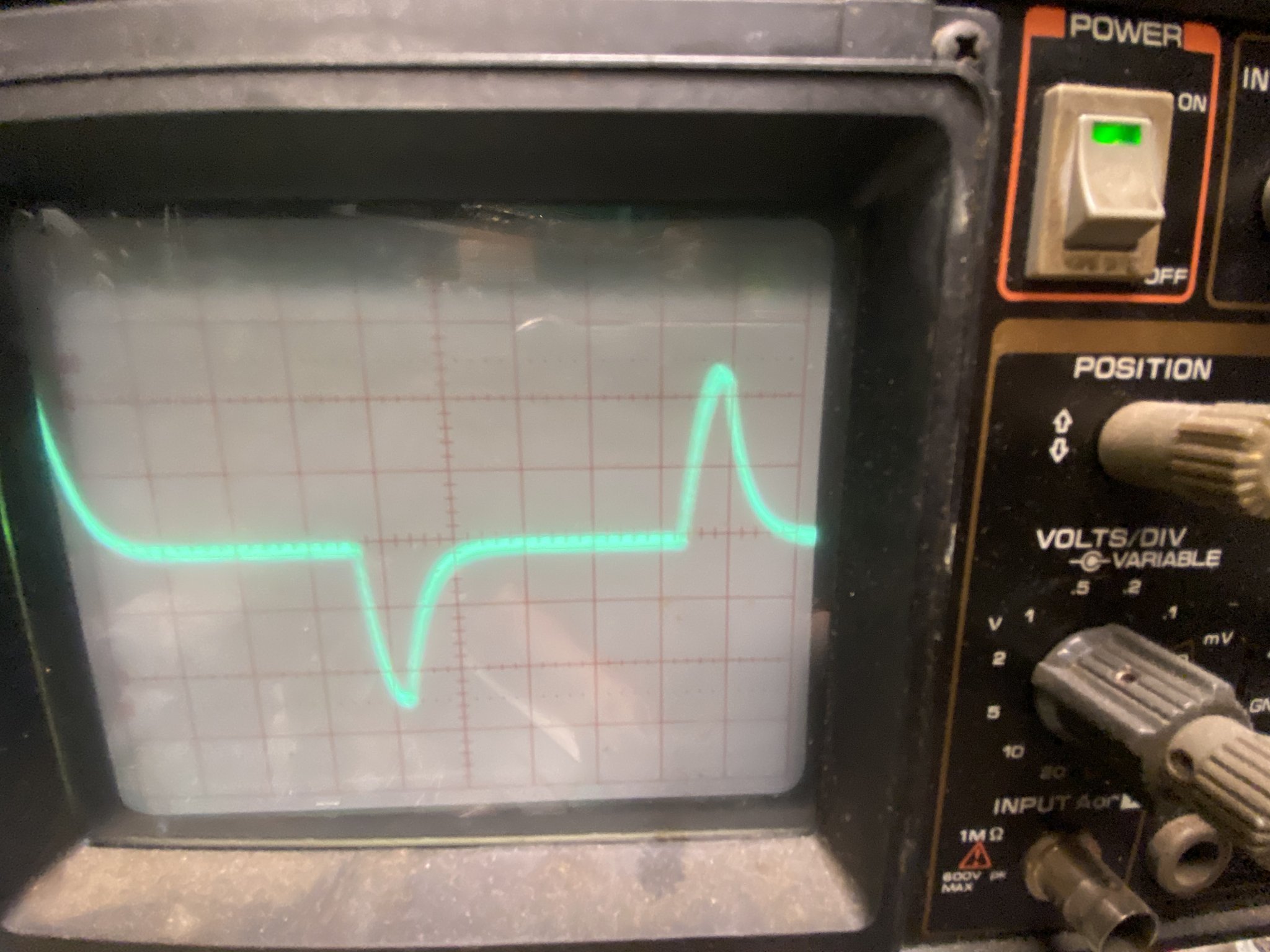

Amp has very distorted output . If I only hook up power ground and remote to the amp nothing else this is what I get on both positive and negative speaker terminals .
Is this normal ?
The 2nd picture is with power ground and remote hooked up only no rca jacks and a test speaker hooked to the amp .
Is this normal ?
What were the scope settings?
Probe on 1x or 10x?
Resistance from negative speaker terminal to the secondary center-tap of the transformer?
Probe on 1x or 10x?
Scope settings were
2us 1volt/div
Probe was on 1 x
And I get 0.1 ohms from negative speaker terminal to secondary center tap . Unless I have the wrong winding if I do then it’s 1k ohms
2us 1volt/div
Probe was on 1 x
This appears to simply be a transient from the startup of the amp and the second photo is simply noise.
If you drive the amp hard, do you see a lot of noise on the B+ terminal? Connect the scope's ground clip to the primary ground and probe the positive terminal (scope set to 20v/div and 2us).
I don’t see any noise on the battery terminal .
If I drive the amp hard it goes into protection .
Also with no rcas connected I can hear the noise through the test speaker even at idle sounds like an airplane through the test speaker

The noise is still present with the rcas plugged in .
Nothing seems to change the noise when I adjust various switches or pots
I drive the output to high power
And the voltage remains the same at 13.7 volts
Output is very noisy all the time .
