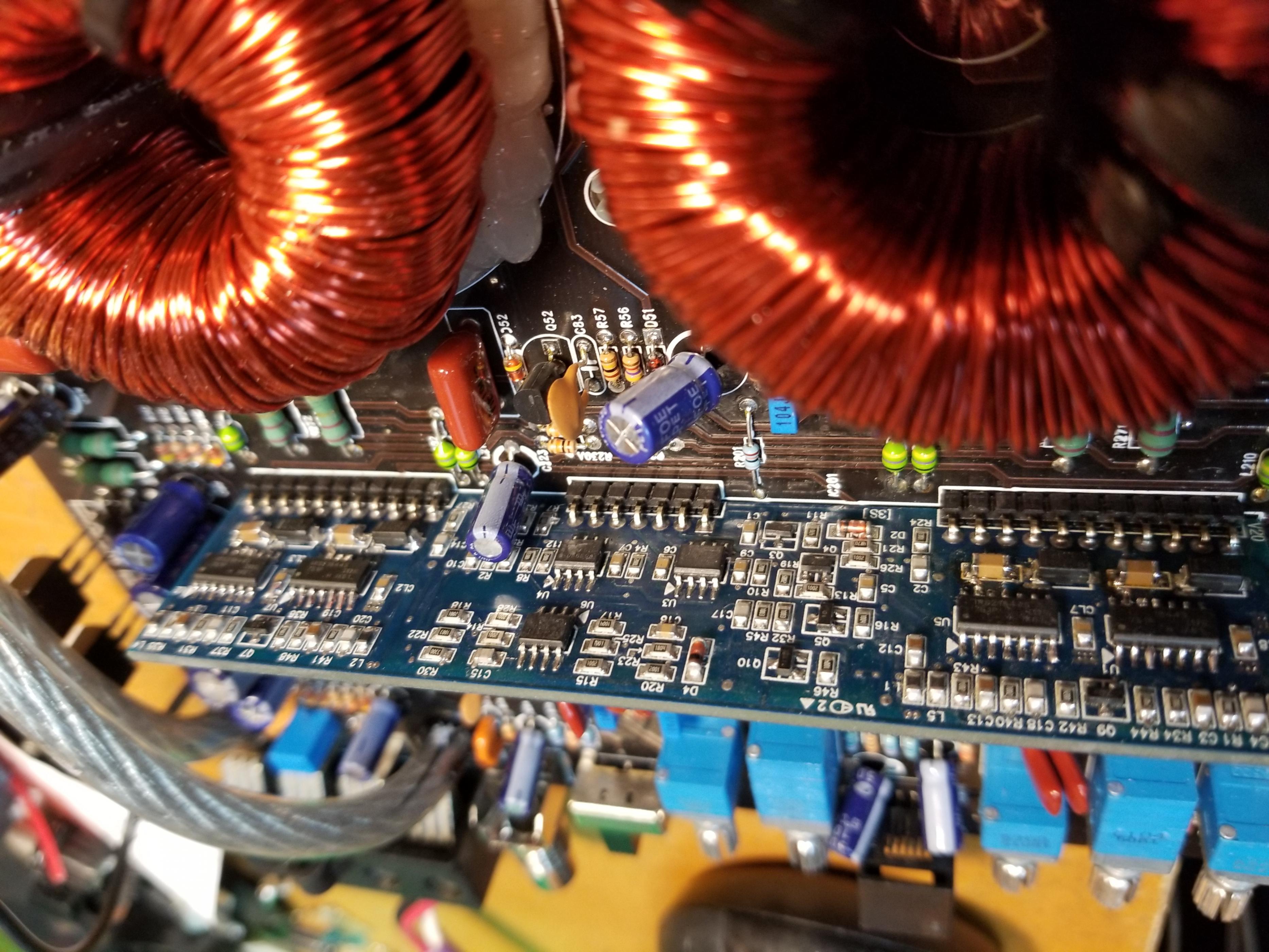

I've got the board out going over it again. I'm 65 and turn 66 tomorrow so my eye sight isn't what it once was but I use magnifiers to check it. I'll let you know.
Walmart has them for about $20 (pharmacy section). It's the best small lighted magnifier that I've ever found.
I don't see anything. I did an ohm check between legs of the chip. Nothing shorted. All I changed on the board was the drivers and one diode.

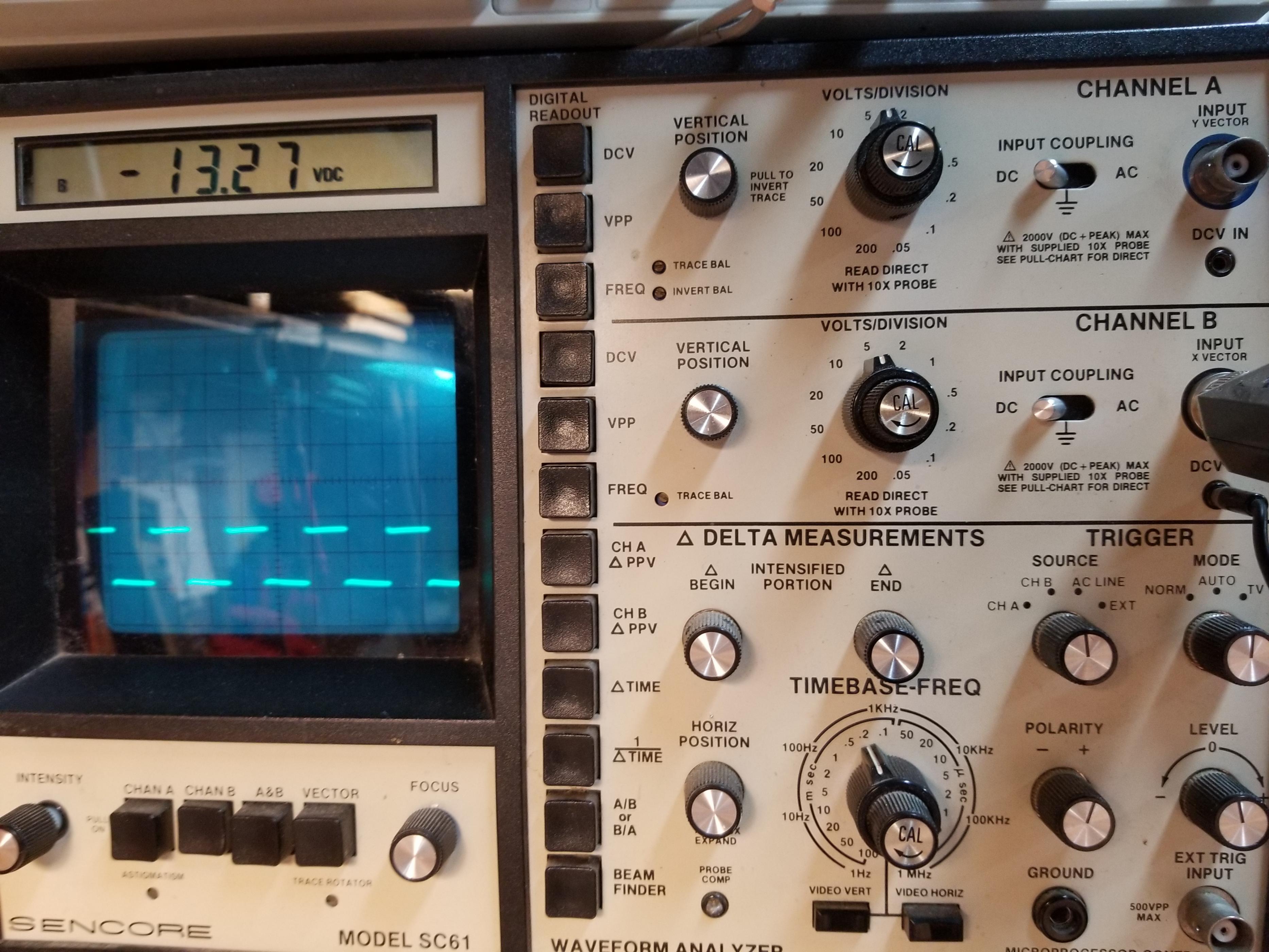

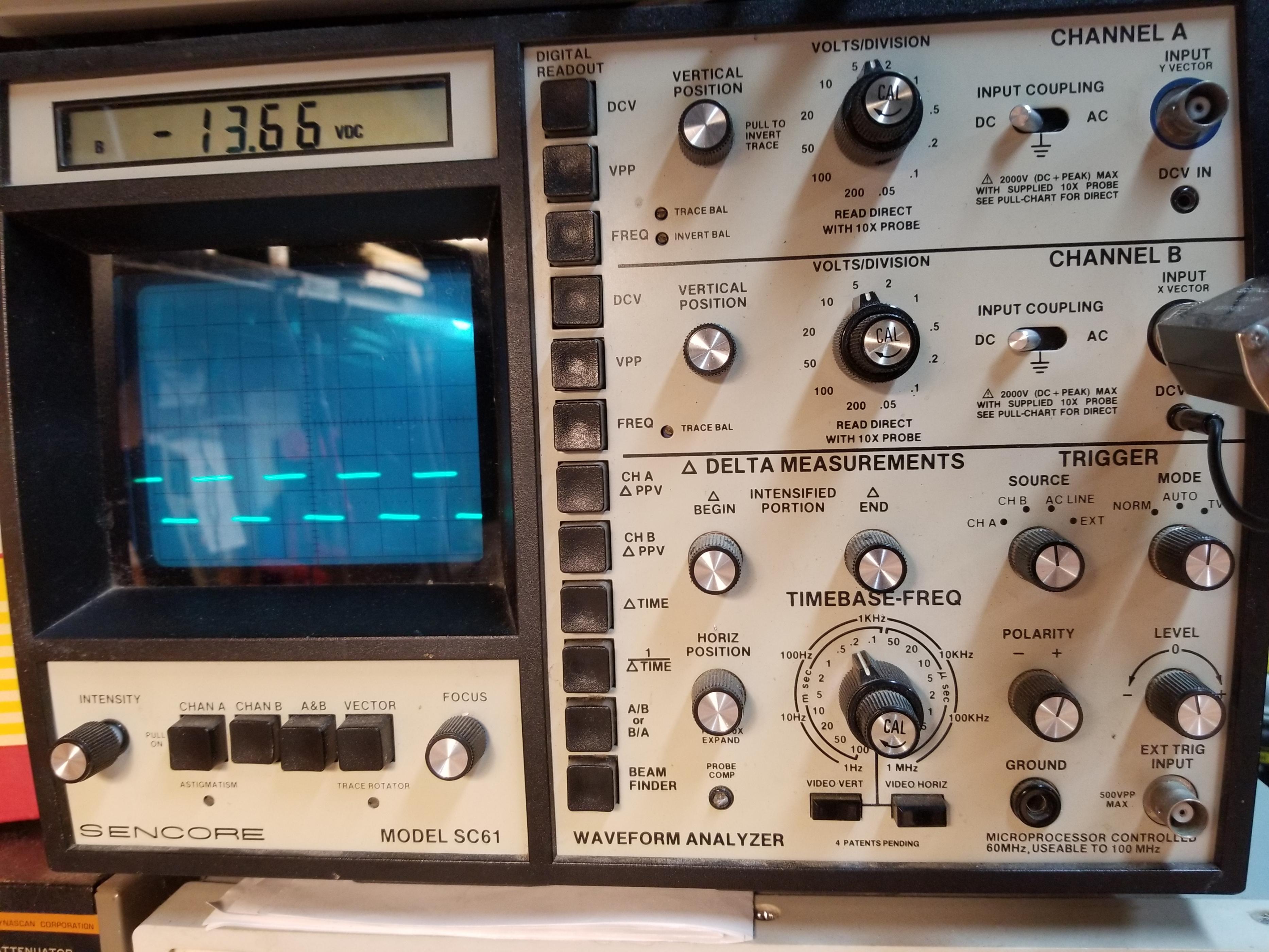

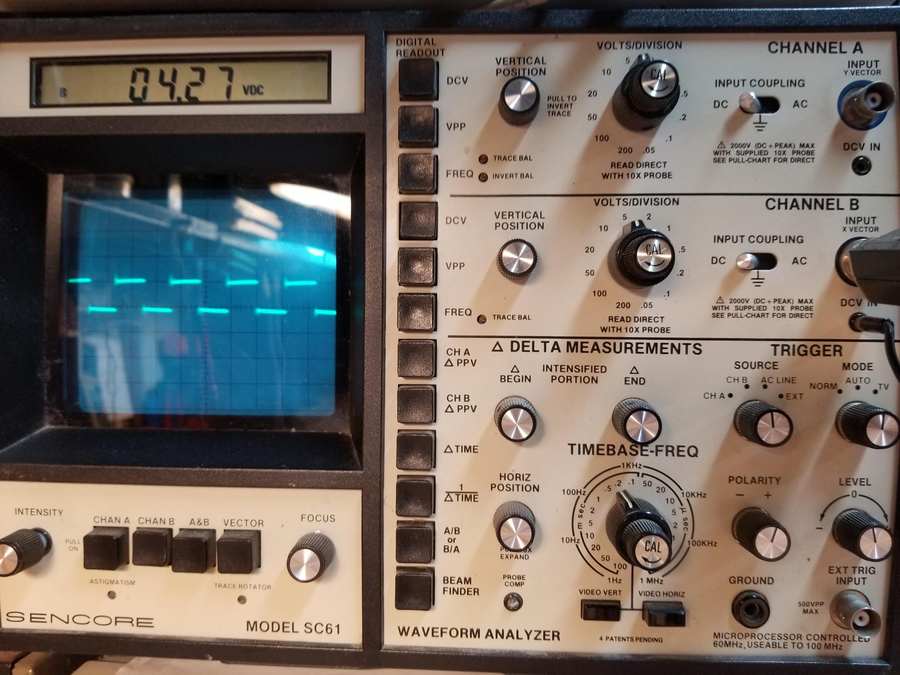

Another day. Another try. Checked the output driver board. Did not find any bridged joints. Removed the driver giving the erroneous wave forms on the high and low-side drives. Installed the driver board. Checked all inputs. Looked good. Checked the low-side drives. All looked good. Checked the high-side drives. All looked good. Put a pair of outputs only in the amp. The amp powered up and bulb did not burn bright. Did not have sound so I powered it down. Tried it a second time and the bulb glows bright. Any ideas?
First pic is input signals. Next two high and low drive.
