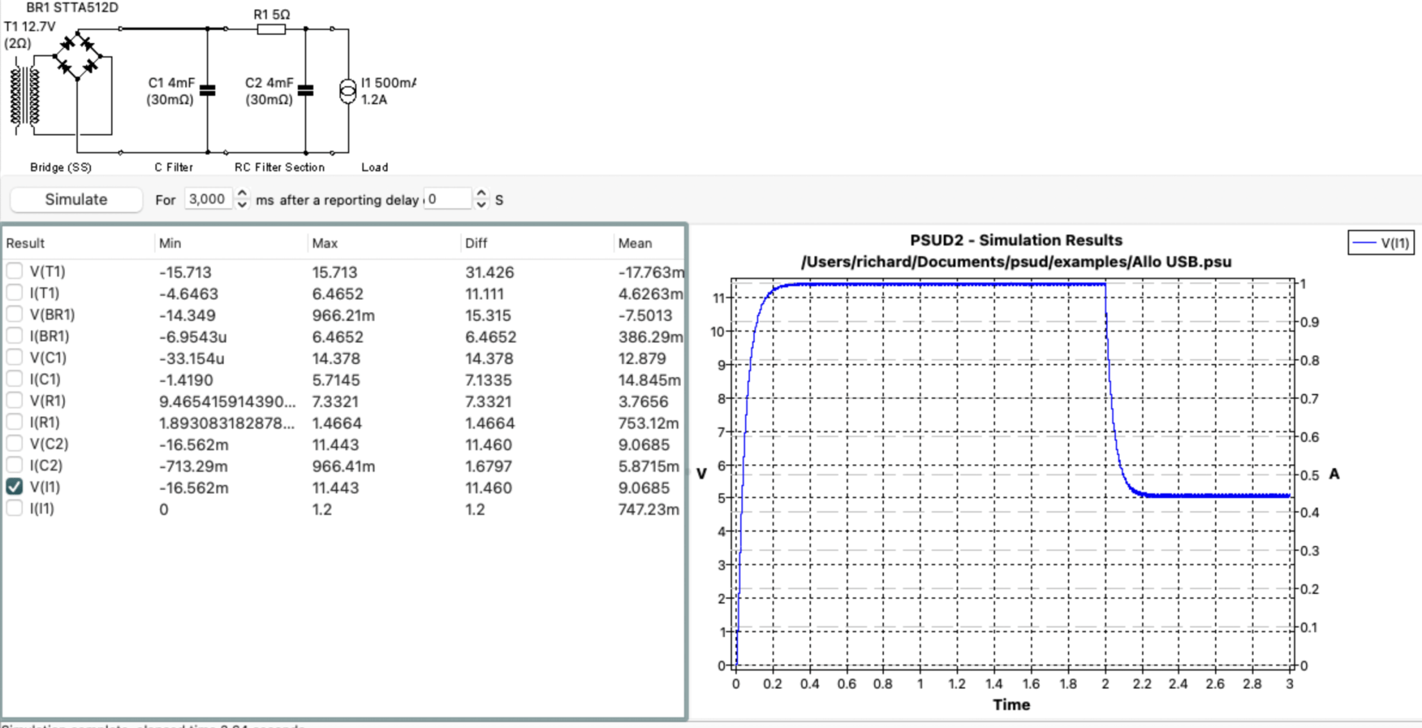

You should have a few volt headroom. 8v would be a good number to aim for but it isn't critical. 100,000 uF is insane and will cause other issues. 10k is enough.Ok - well I have no figure in mind, I am purchasing it for improved sound quality reasons over an above an ifi SMPS wall wart device.

I was looking at this as I have small start up where there is very temporary 1.3A transients. (100,00 was regarding the ripple rejecton)
Is this a crazy idea?

Jan,
Thanks for super quick reply 🙂
I have absolutely no experience of regulators and so I want to ensure that the normal steady state is not overloading the regulator and that the start up sequence is not going to fail due to a short voltage drop (even if that is a thing!)
I can keep changing R to make it work on the transient start but I don't want to overload the regulator in normal use if this ends up being too much voltage

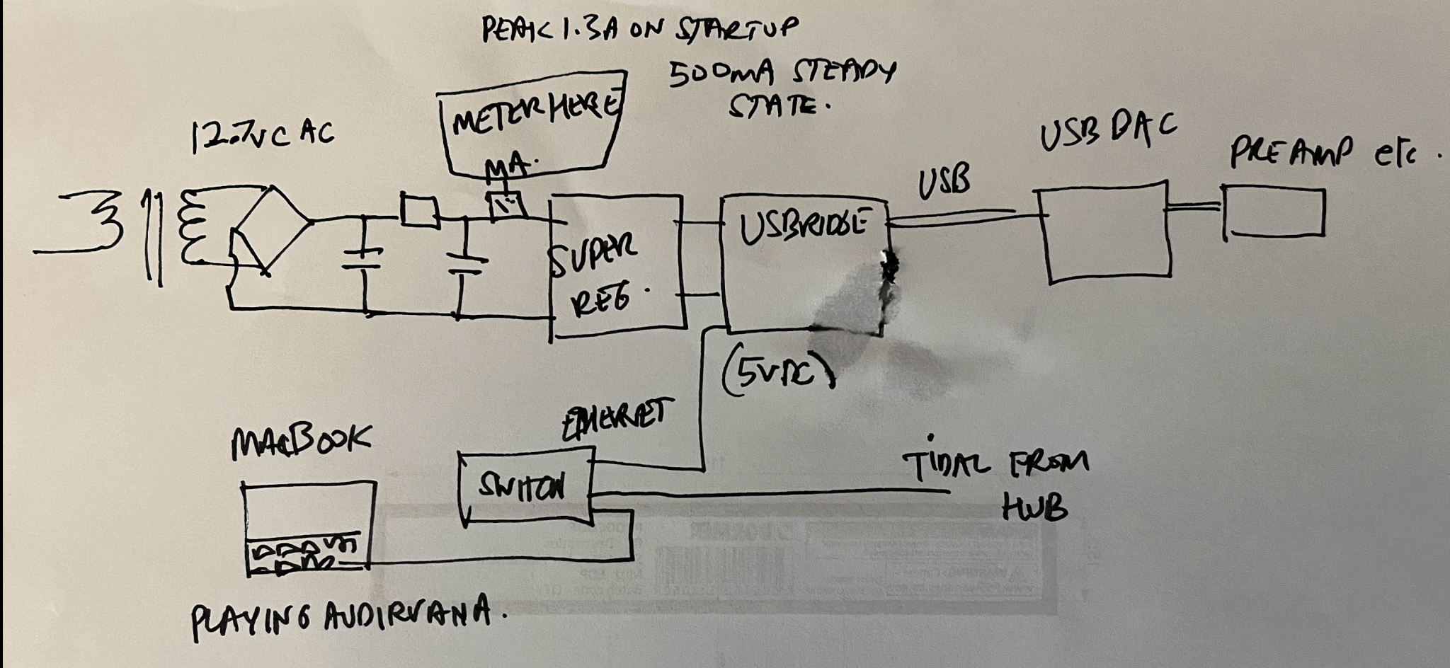

What are you measuring here?
And if you say: start up current, my next question will be, of what and where?

Thanks for the reply again 😀
I am using an Allo USBridge as an end point running Roipeee and current demand is as the system boots up on switch on to load the software from a micro sd card
The device receives music via internet protocols with the music files coming from a MacBook playing audirvana
But what does the superreg feed? I have trouble to understand what feeds what. Do you have a block diagram?

I think it should not be an issue, if the steady state is indeed 500mA.
What is the pass device on the superreg, and at what current is the current source set?
Do not trust the mechanical moving iron meter with no info on the ballistics.
It is normally too slow to indicate a peak, or if the peak is very short it may indicate too much due to mechanical overshoot.
Get a real digital multimeter.
Maybe gift the meter to a friend for his preamp ;-)

I had assumed I would just run the super reg into the USBridge, do I need a local capacitor here?Forgot to ask: what is the capacitance at the output of the duperreg?
