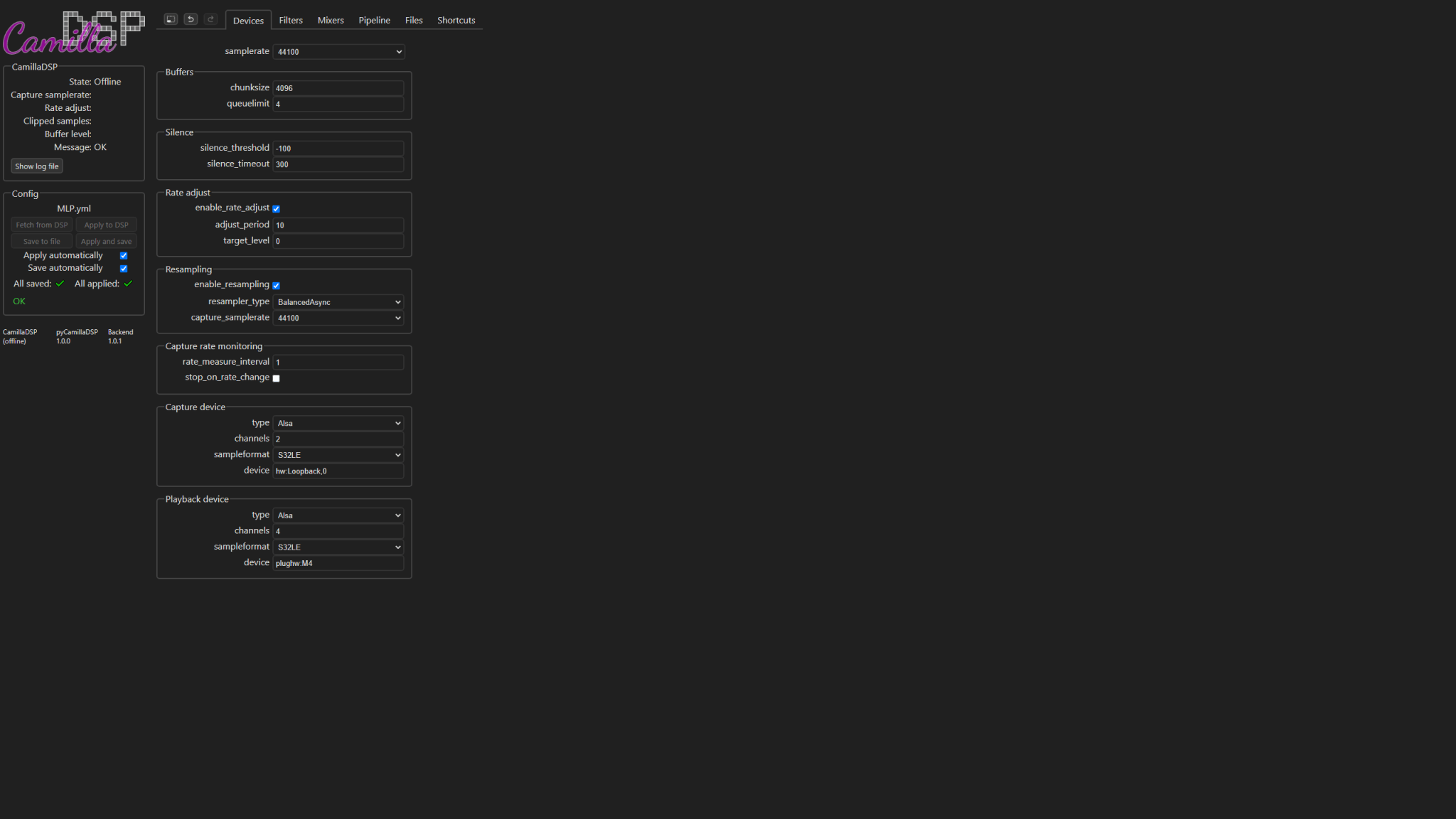

Hi Jesper! What do I use and how to edit ( cdsp_template.yml ) the file we must edit to our need's (filter's, EQ's, gain, volume etc...)Ohh.... okay...
Try to follow my guide here : Link!

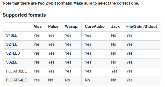

Depending on the DAC you use which is the playback device aka' "sound_out", try to adjust the "sound_out" format.
This can be tricky, as it's depending on the DAC hardware!
E.g. i use this for a little Chineese streamer i have
device: "sound_out"
format: S24LE3
There are a lot of options for output setting see here : Link!
Jesper.

Just use nano editor, as also used in the guide.

I installed Superplayer-Gamechanger and CamillaGUI on a Raspberry Pi 3 running piCorePlayer 8.2.0 32-bit. The audio output device is a DAC hat based on AK4493.
I cannot get camilladsp to work, as it always remains in the INACTIVE state. I have tried with a python script to read the current configuration (get_config()), it is always None, while the previous configuration (get_previous_config()) seems fine. The function get_stop_reason() returns StopReason.PLAYBACKERROR.
Note: I installed superplayer and camillagui on a Raspberry Pi 4 with piCorePlayer 8.2.0 32-bit with an external USB DAC, and everything works as expected.
I need some help. thank you.
