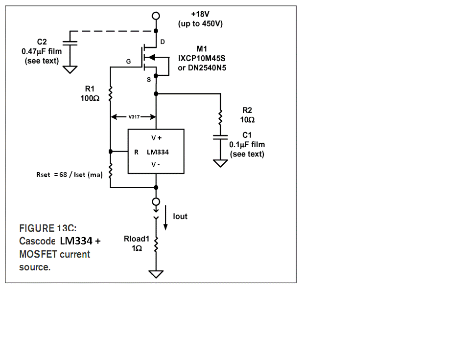

I've used the Figure 13C current source (post 21) and it works like a champ.
Wasn't the original (in the Walt Jung article) a 10M45S with an LM317, not an LM334?
Did you use the LM317 or the LF334 and it worked like a champ? I've used a DN2540 with an LM317 in the bottom position and it works fine, but I've never tried an LM334 with a DN2540, and I'd like to.

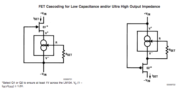

I would make the gate connection to the V pin of the LM334 as shown on the device manufacturer's datasheet, not the R pin. This is where the difference between the LM334 and the LM317 shows up.
It would probably work either way though...
Excuse a dumb *** but as far as I see the gate goes to V- in both examples (and to Rset). The difference is where the Rset resistor is placed as I can spot it. Either between Gate/V- and R or between Gate/R and V-
Or what is it I dont get?

I just finished assembling 10 of the lm334/dn2540 cascodes. 6 are for backup and 4 will load the final stage in my build.
Added a trimpot (200r) for fine tuning and used Fenris's suggestion to find Rset. I'll keep you all informed.
Best
Staffan
The Rset goes between V and R. The cascode gate in both of the datasheet examples is connected to V, which is the recommended connection.
It's an earlier post I was referring to which has the gate connection through gate stopper to the R pin.
In this case it won't likely affect the operation as the Rset is so small compared with the impedance of the MOSFET gate.
Personally, I would go with the cascode gate connected to the V pin as the manufacturer recommends.
