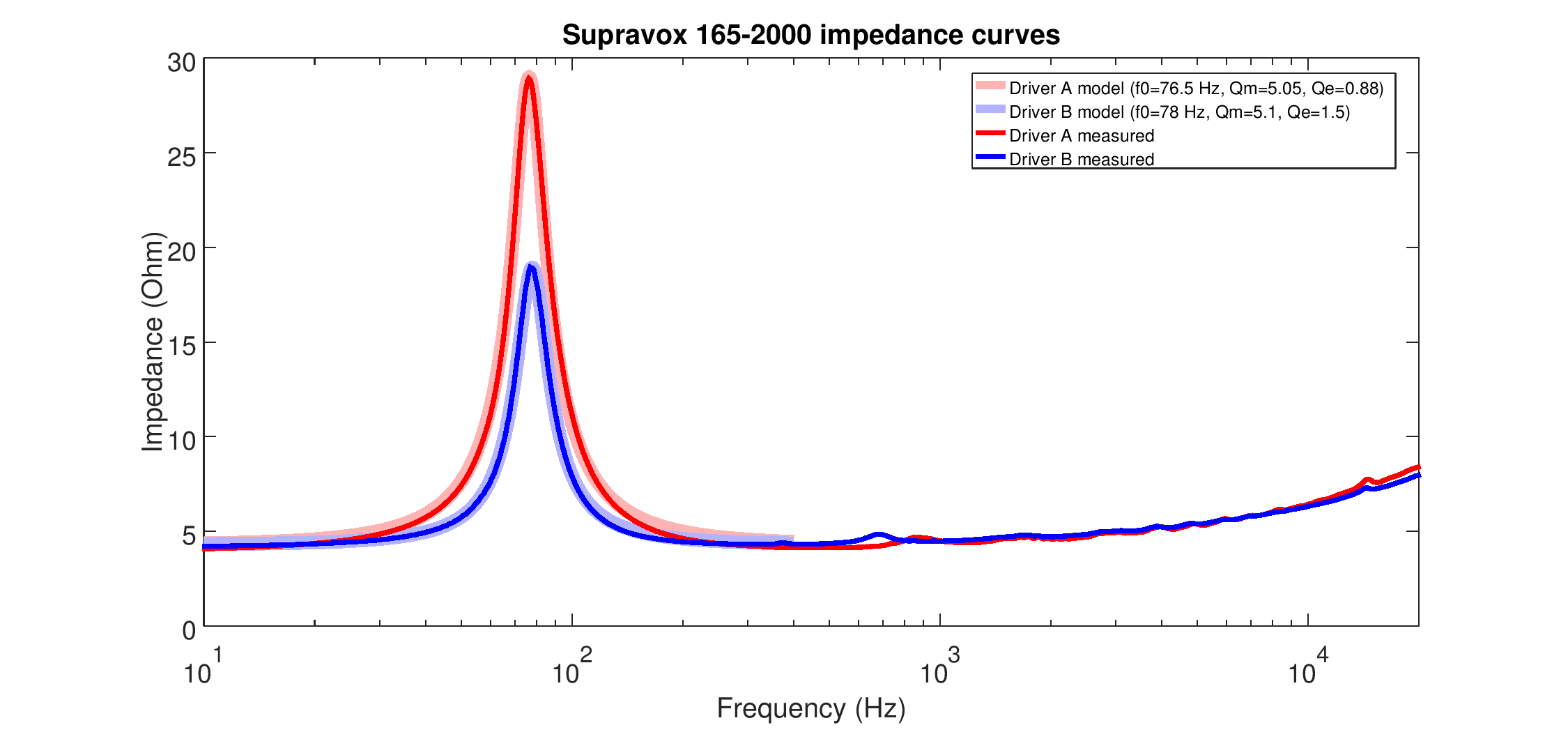

Received the drivers and measured impedance curves (attached). Looks much better, but not "perfect". fs and Qes are nicely matched, but Qms are different by almost 60%. Some of the small wiggles in the impedance curve occur at different frequencies. What do you guys think?

Makes a minor difference when coupled to a high output impedance, though can be negated with extra stuffing in the high Qms cab if audible.
GM
Not sure what you mean. In any case, I am not concerned with the system tuning at the (main) resonance, as the Qts are dominated by the Qe and are therefore almost identical for both drivers. My question is more about "how different" the drivers are, and if you think this is typical/expected for such drivers (strong motors, light membranes+coils, etc.).
