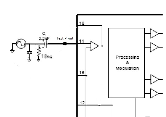

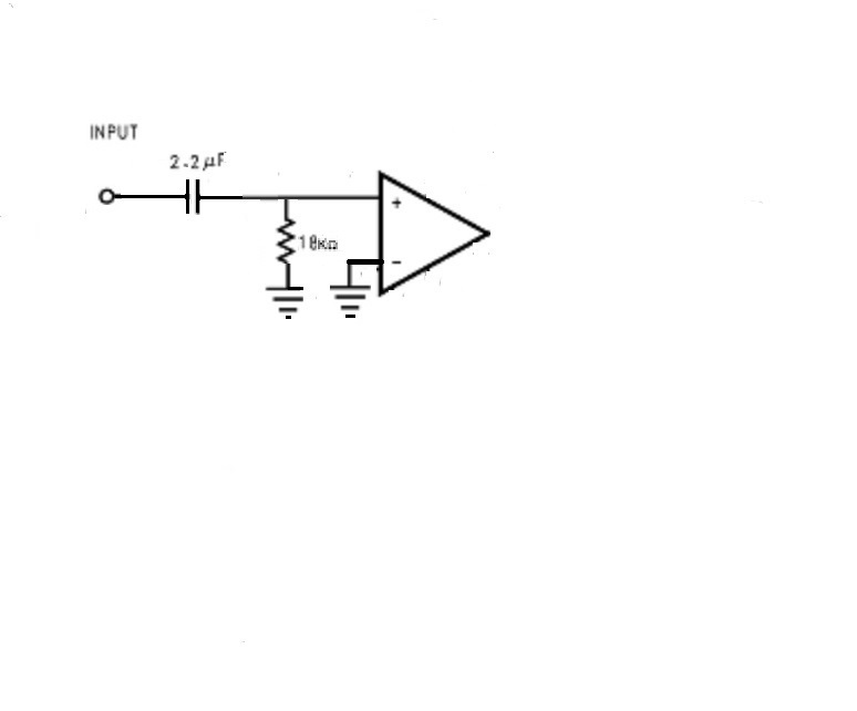

Input impedance for coupling cap calculation?
As mentioned above, on my Sure model AA-AB32186 board, I noticed that the input coupling cap is in series with the input after the 22k shunt resistor[first image]. The resistance from shown test point to ground is 76k ohms.
BTW, I've replaced the damaged 22k shunt resistor with an 18k 1/8w 1%metal film resistor, since it was the nearest value small resistor I had on hand).
In most input circuits the shunt resistor is after the series cap, making input filter frequency calculation easy[second image].
How does one determine the low frequency cutoff in the first case(i.e. using the 76k or the 22k as the input impedance)?
