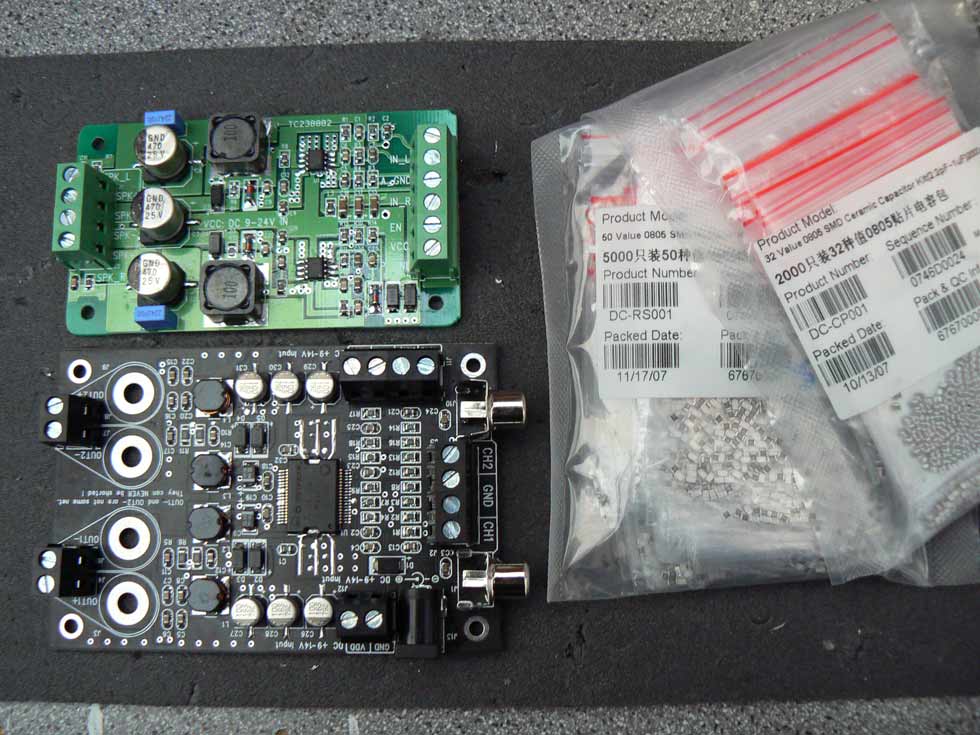

I bought a bag full of SMD resistors and capacitors from Sure, but they Sure haven't arrived yet!
The bag of SMD's (fleas), arrived today with 2 of their 8watt amps (only asked for one). Thought they might be suitable for headphones or pre amp? (they have a single speaker ground)..
Only ordered Boxing Day😀
The photo is to show a comparison to the Tripath board, inductors are a lot bigger..
Cheap Toys, good service..
