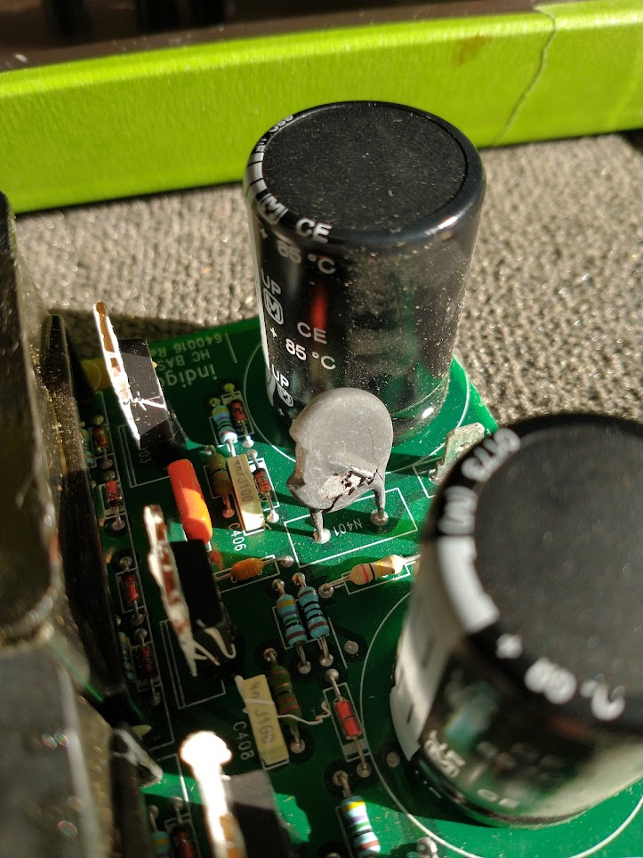

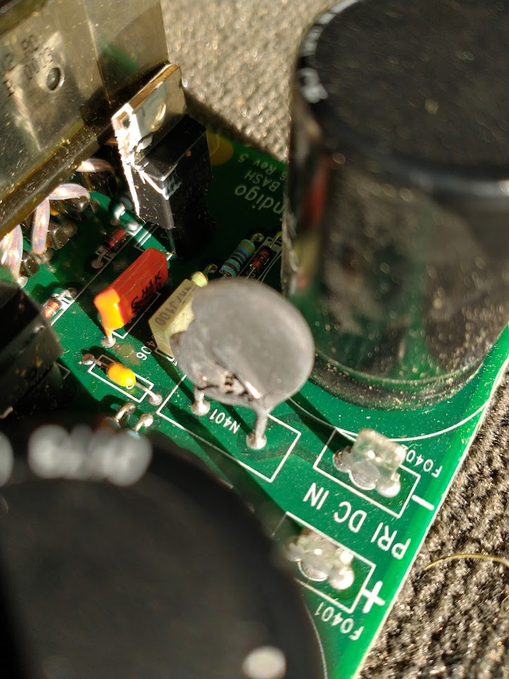

I took the amp out just to take a look see and I found this - see pics.
I have the service manual and they call it a "Surgistor" 4R 8A 70JSL154R008. It is located on the main power supply board (with the big caps) and it is directly next to the DC IN leads.
It looks bad and pitted but does it look like it failed? Do you think this could be the cause of the issue?

Measure it with an ohm meter, if it measures open it is bad. If you found the part at Digikey look at the data sheet for the cold temperature resistance. This is what it should measure.
For sure its blown, but the real question is, why?
Even if you replace it, this may not be the only problem.

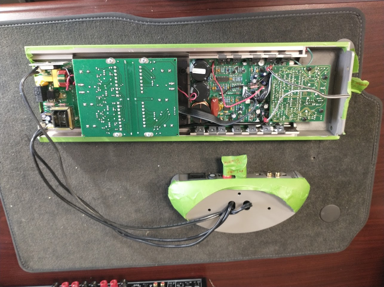

I couldn't get a consistent reading with my ohm meter so I went ahead and ordered a few of these from Mouser.
As far as there being another problem that caused this, I don't see anything on the board that feeds this one that is obviously damaged so I will probably just swap a new one in and test it before putting it all back together.

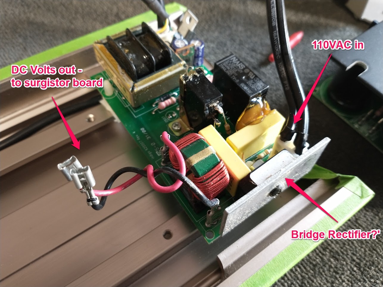

I'm not following you here - put it before the surgistor board? There are a couple of leads that go to that board and if I am not mistaken, they are low voltage DC coming from a small torroidal type transformer so not sure if a 110v light bulb will work??? See pic.Use incadescent bulb in line for the start.

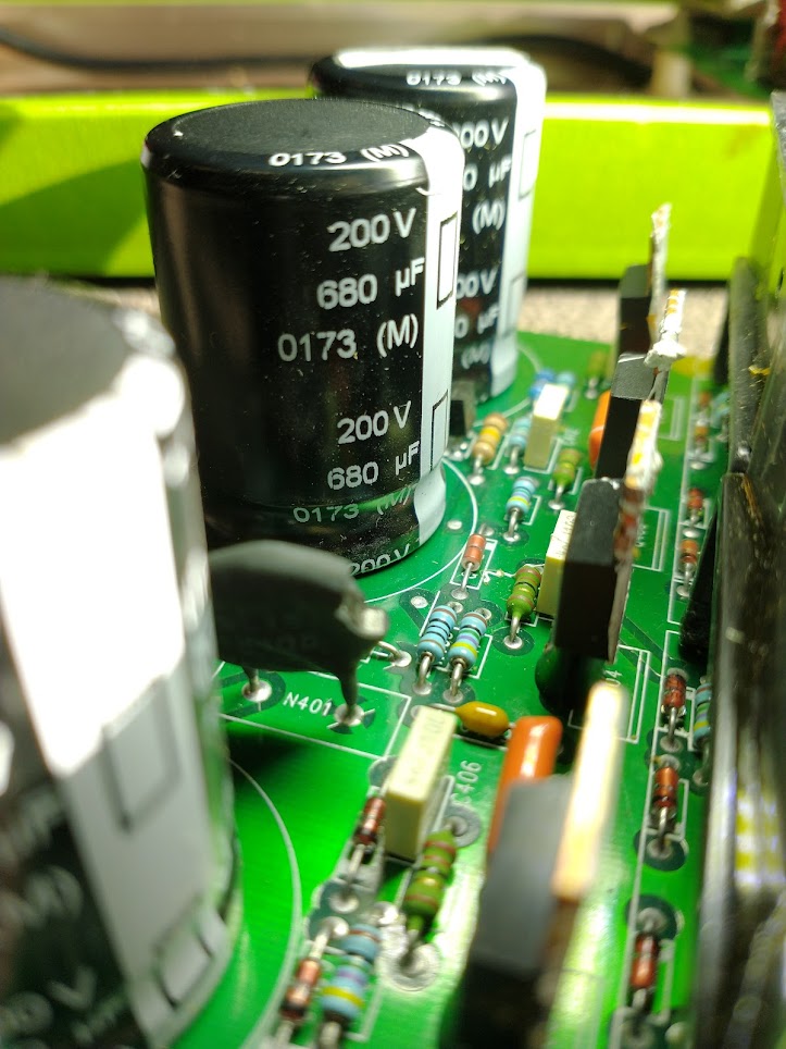

If something further down the chain shorted, a fuse should have blown before the inrush current limiter (NTC thermistor) went bad. They run hot when operating so failure is not uncommon.
True, fuse should be enough.If something further down the chain shorted, a fuse should have blown before the inrush current limiter (NTC thermistor) went bad. They run hot when operating so failure is not uncommon.
The fuse was the 1st thing I checked and it is good.
No telling how long ago this happened; It may have been something that damaged it but not fatally, and then it only completely failed now or it just failed due to age. I have 2 of these subs that I bought new in 2007 and they were close-outs back then. The dates on the PCBs are 2000 so that gives you an indication of age ....
