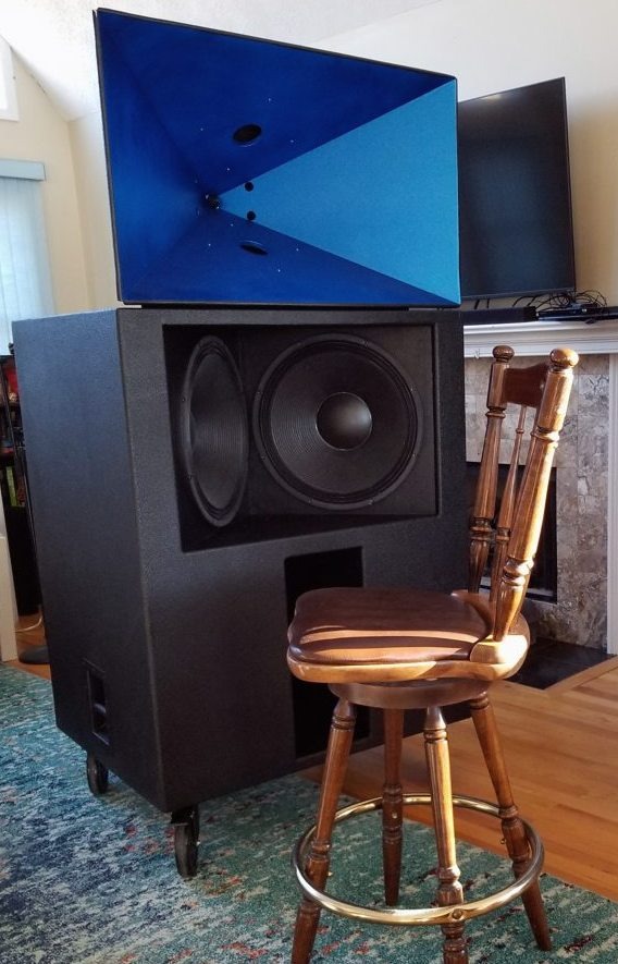

Well.....3 months later and I did it.....made new sub carts.
Not exactly a PPSL, but a hybrid as described here..https://www.diyaudio.com/community/threads/v-twin-double-18-bass-reflex-build.410229/#post-7627233
I've listened to syn11 and the older subcarts for long enough to know it is the clearest, most dynamic, sound I've achieved yet.
The only problem I've had with it, is the tonal balance varies more due to distance than any other syn version I've built. Sub bass is much stronger up close than only 10 ft further. I think the very large baffles of the older sub carts, and they way the interact with the room is the culprit. But dunno, cause it's been winter and no outdoor listening.
Anyway, now I have a syn11 on one of each type sub, and the birds are starting to sing....so I'm about to find out what the tonal shift with distance is about.
But all the other versions used my double 18" PPSL subs.
Only one of the new subs is built. Will listen outdoors, make syn11 measurements, while finishing two more subs.
Planning on revisiting syn10 in LCR mode when all 3 subs are finished.
The new sub was built to match up with syn10, blue horn on left below.

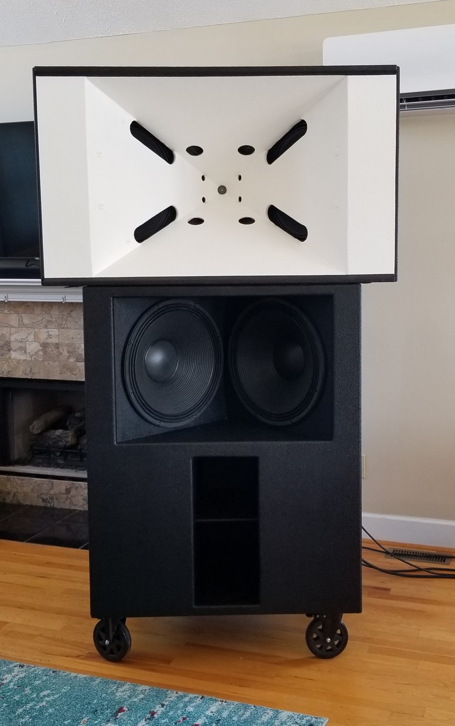

Hey, you know what was half scary just now....this 71 year old dude moving the big white 240 lb syn11 from the old subcart to the new.
One of these days I'm gonna really screw the pooch lol

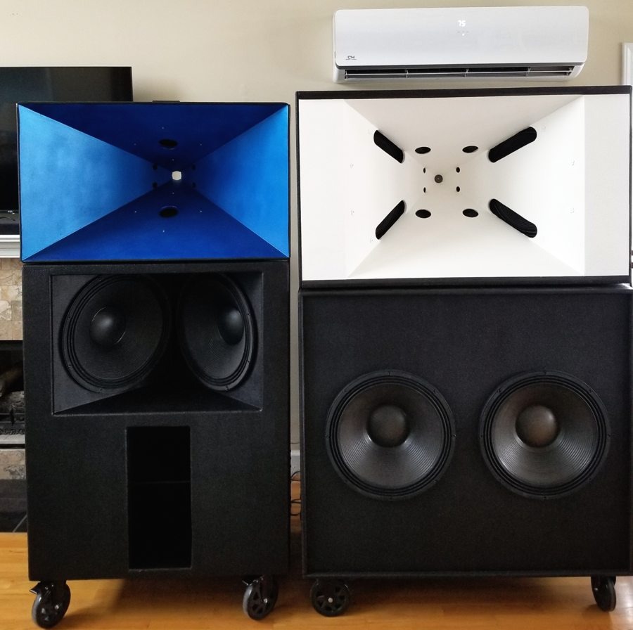

They look absolutely spot on. Love the finish too!Only one of the new subs is built. Will listen outdoors, make syn11 measurements, while finishing two more subs.
Can only imagine how incredible they sound!
Thx SpeedySteve, everyone...

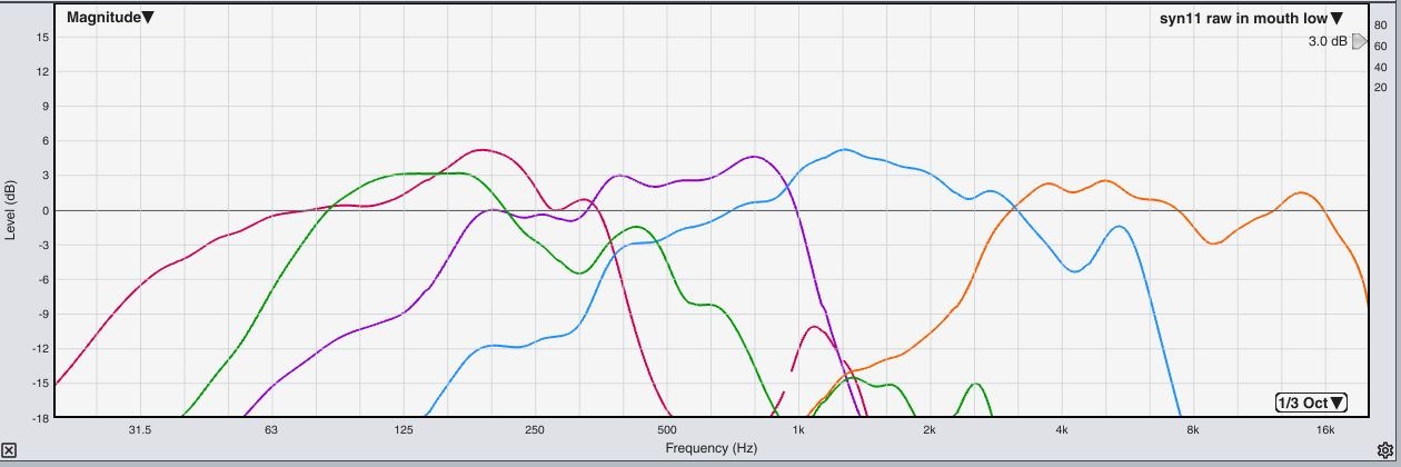

@yys310, the syn11 has a pair of 12"s that reach down to 80Hz. It's the green trace below.
All my unity/syn build prior to syn11 have been design to cross to a sub somewhere around 100Hz.
But I've always wondered how it would sound to try to get the entire spectrum into one horn, and then use subs only for extra bass support.
So syn11 has a pair of 18"s in it, the red trace below.
The 18"s only reach down to 40Hz easily, so not what I was looking for. I tried adding reflex ports along with the primary ports, but the box volume was way to low for them to work.
I'd never put 18"s in one again... I think 15" is the limit, and I'd do some real modeling first.

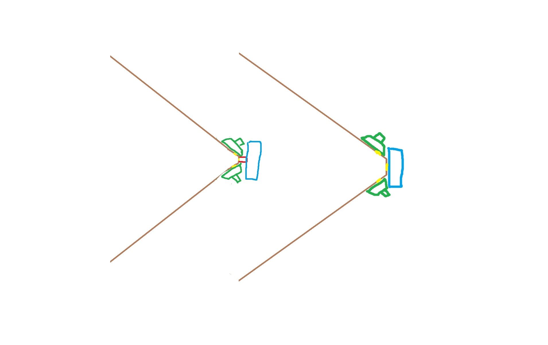

Is it possible to use an additional adapter tube to push the compression driver away? In this case, it may be possible to place the midrange drivers more compactly.
I dunno....lot of trade-offs going on with that idea. Not something I'd try....I'd leave that to smarter horn folks like Mabat and gang
