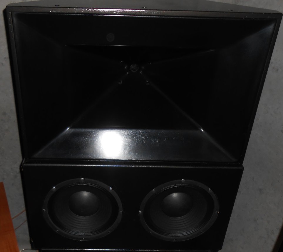

Some tinkering around with the Unity horns (attached a slightly better picture). After spending a few hours measuring and trying to get a grasp of what REW is interpreting on the impulse responses of the four channels, I arrived with the following:

I am really curious how the Dayton 6.5" woofers will do in the new horn when I get around to this "upgrade". I originally was going to build a 2 channel Unity type horn but realized with the dimensions I had just enough room to squeeze a 6.5" woofer in. Hornresp simulated nicely to around 90hz without too much cone displacement. I am hoping the cones won't slap the back horn wall as as they appeared to be inset far enough, otherwise I'll have to make some ring spacers to put under them, which will increase the back chamber volume.
I am hoping there is adequate low mid response out of the 6.5" woofers due to what seems to be slightly forward spacing of the ports (3/4"x4" oval centered around 9" from the throat) and approximating port size and back chamber volume with relation to what I entered into hornresp as this was difficult to determine. From what I understand the 1/4 wave of 350hz is around 9.6" so would this mean it should work without a null?

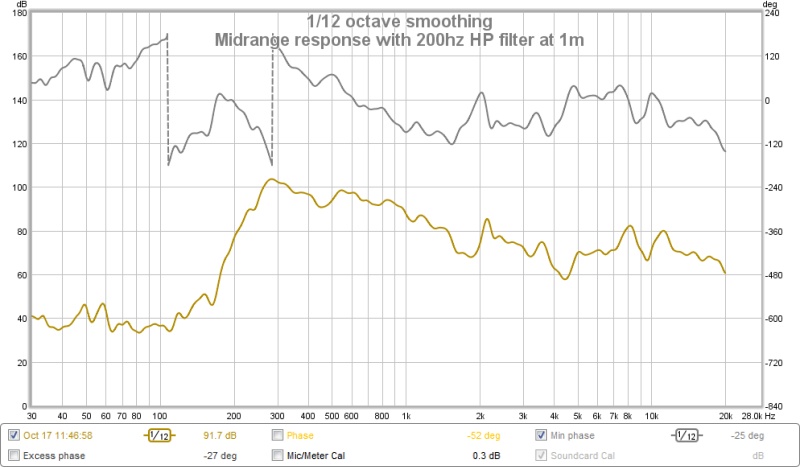

Can you show a fullrange sweep of your mids? I would be interested to see how high it is and how deep the null is.
Here is the raw response with a high pass filter at 200hz:

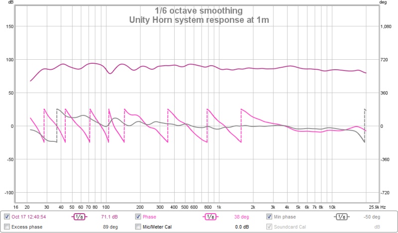

system response
Here is the overall measured response at 1m, right channel after correcting the delays and adding minimal eq. The phase plot (which seems to be all over) vs minimum phase calculation - how is this interpreted?
Shorten the time window from 500ms to ~5-10ms (IR Windows button in REW), it will clean up the phase response. You can also scale the view so vertical lines are in 5dB or 10dB steps.
You made it to 1.5kHz before the 10dB null - so that means the distance from your mid cone to the CD diaphragm is 4.49in (half wave distance based on 342m/sec speed of sound) or a 0.33ms delay.
Not bad actually, but means you need a fairly steep XO at about 1.2k tops.

Legis is right, use gate of less than distance to mic in time of flight. I sometimes place mic at 0.5m to avoid a floor bounce and set gate to 5ms.
Look at regular phase not minimum. If you do your crossovers right and transient perfect, you get what Bwaslo gets on his Cosyne (a very difficult thing to do unless clever low order filters are used).

Thanks, this was very helpful. I went back to the Harsch XO settings and dialed in the delays properly (which I did not have correct the first time). Phase looks much better with a rise to 120 deg. around 1K but with no wrap. 🙂
