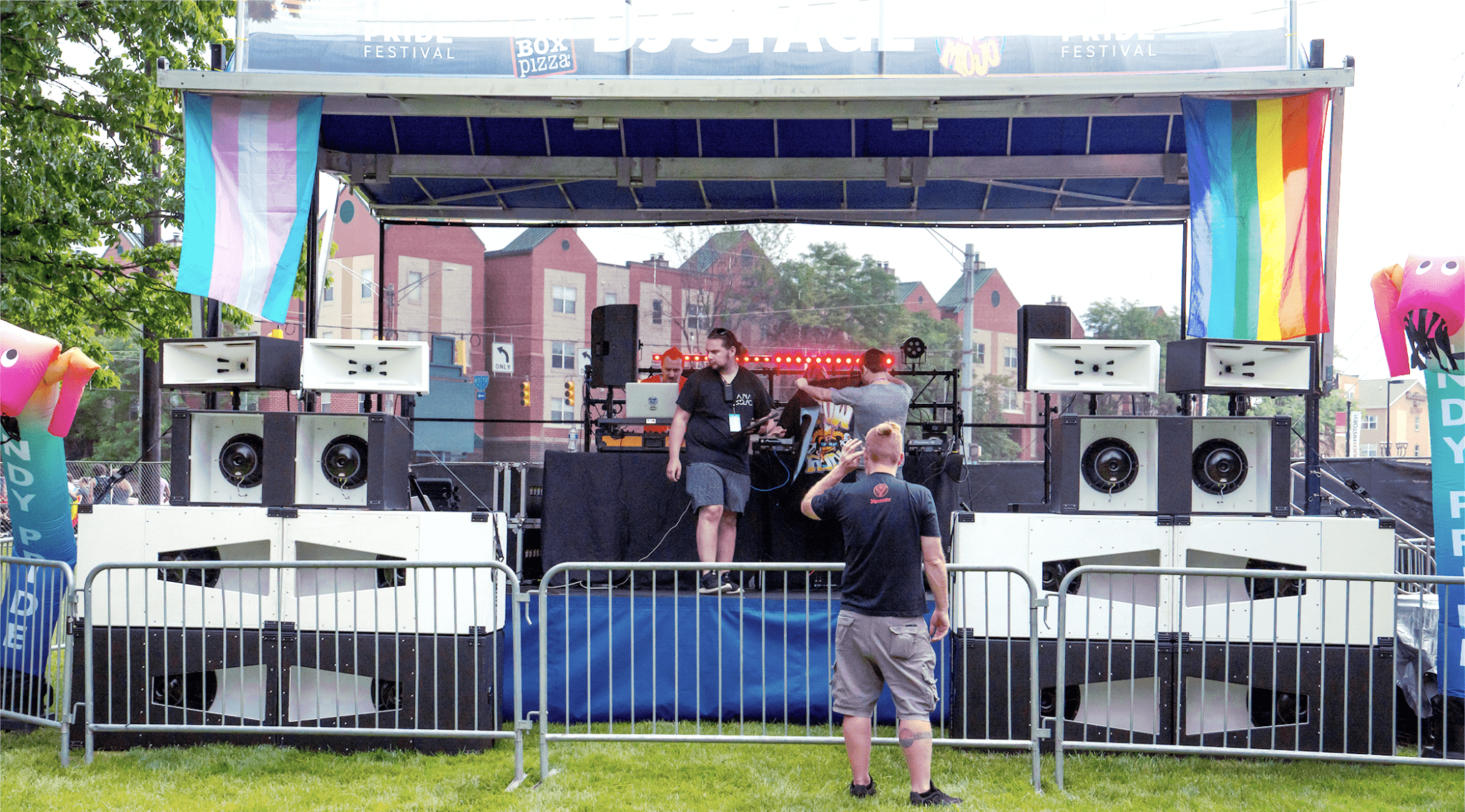

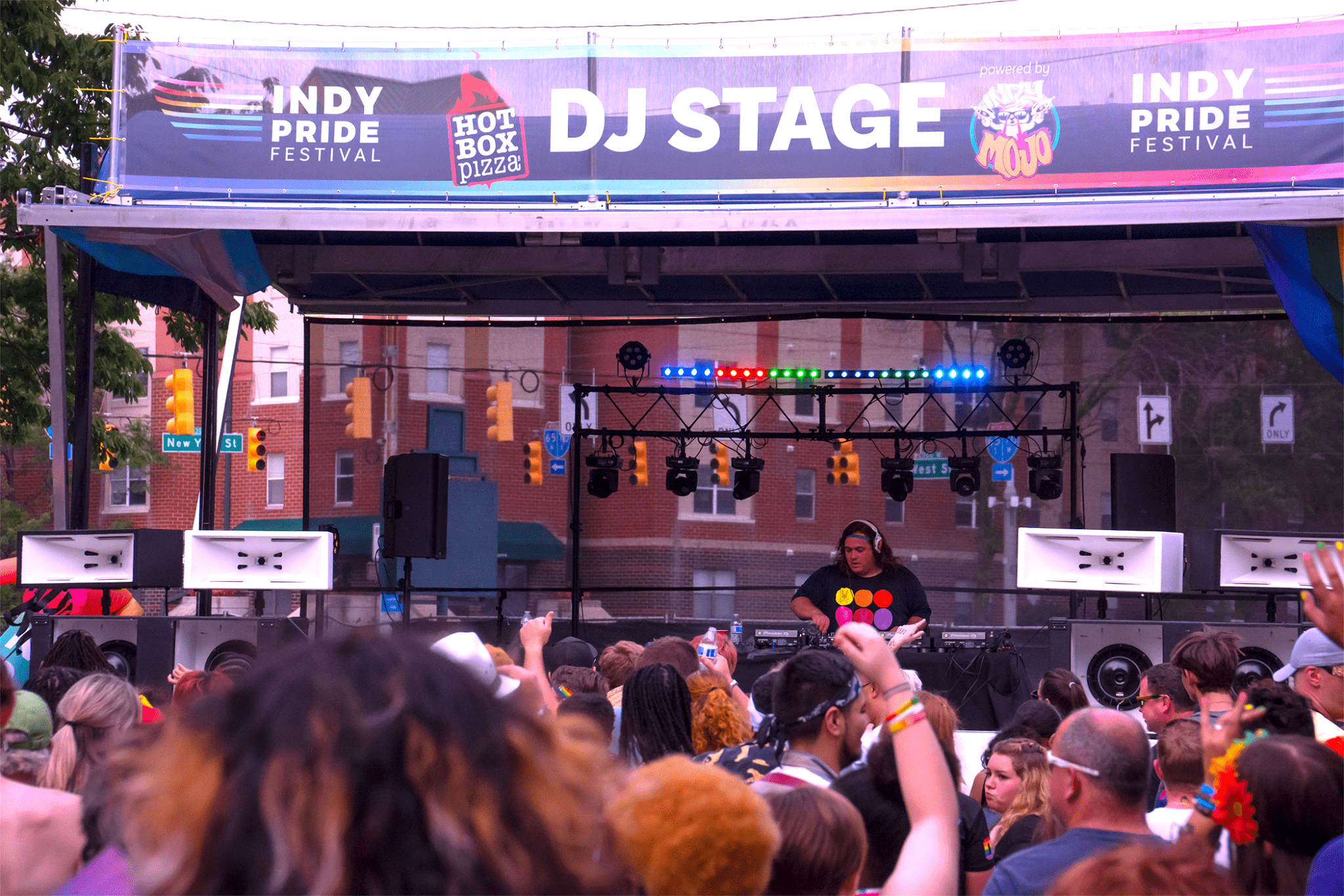

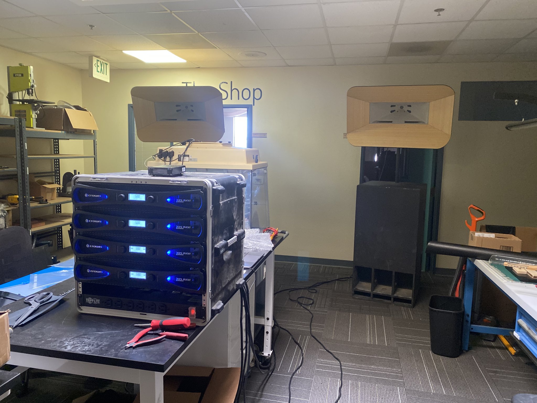

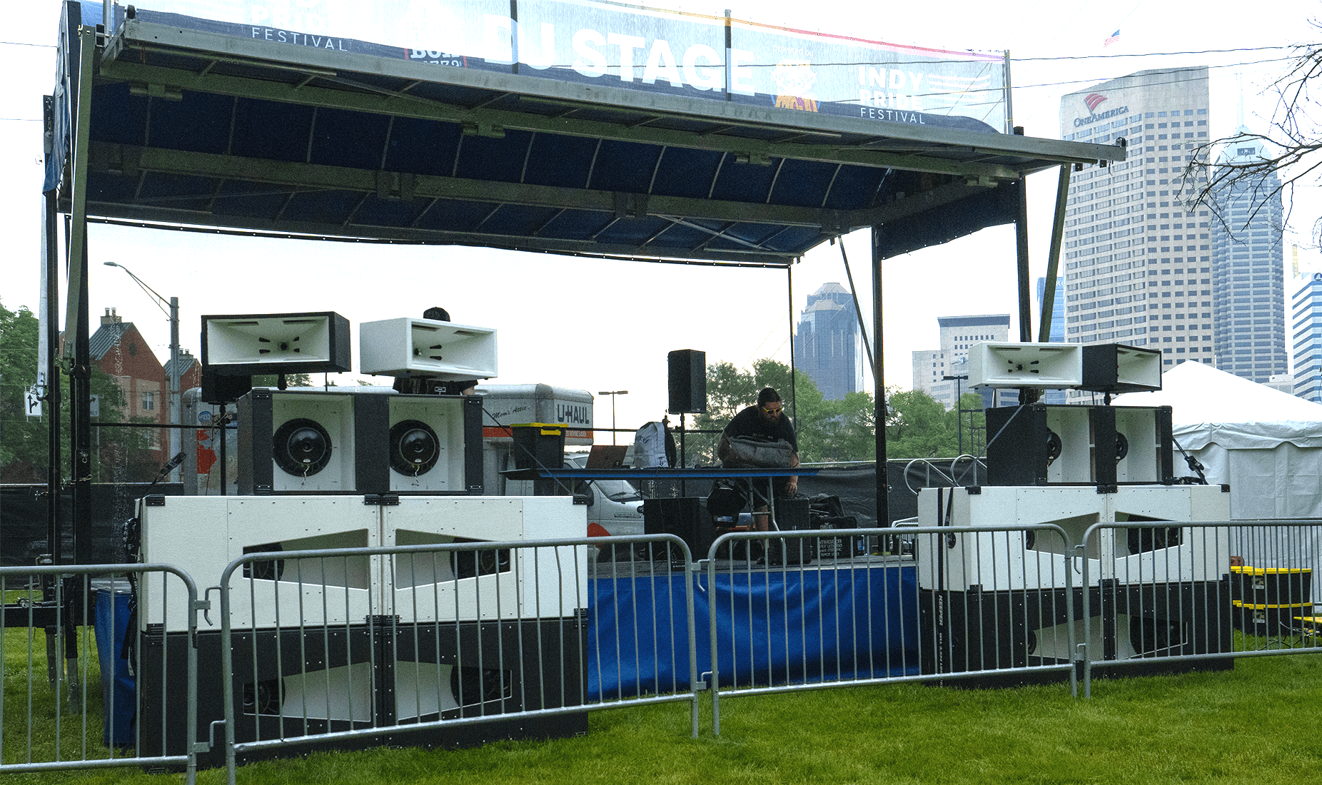

Figured I'd post a couple pics from a show I did this past weekend. This was my first time running 4 SynTripP's and 8 Keystones outside on full power. Results were nothing short of stunning. The SynTripP's splay beautifully. I have the inner ones toed in so there is full coverage up front, and the outer ones about 45 degrees off of the inner ones. When walking from the center of the audience to almost 90 degrees off, there is very little audible change in sound. As soon as you are outside the coverage angle, the sound disappears and you can hold a conversation standing right next to them, it's remarkable. These things truly are impressive.
The keystones are an absolute riot. If you are within 10 feet of them, your clothes are visibly vibrating. Meanwhile the clarity, musicality, and ease of listening to them is something I have yet to hear in any other sub. They also do this cool thing where you feel surrounded in bass and can't locate where it's coming from. Kinda feels like being wrapped in a blanket of bass. I've sort of experienced this with some FLH's, but not to this level.
If anyone is curious, the kickbins are C2-D paraflex loaded with some B&C 12FW76. I haven't exactly been impressed with these but they do add some fun tactile feeling up to around 140hz. They're mostly just good for getting the SYnTripP's up higher though.

Looks like fun times, good to see people together again!
If you used the secondary SynTripP horns, you'd get another 3-5dB forward gain, and may not feel the need for the additional kick bins.
Longer poles work better to raise the top cabs high enough to minimize hearing damage 😉 .
Art
Yeah I definitely need to get around to making the secondary horns. Another 3-5dB would be very handy to have.
And as far as longer poles, I'm trying to keep the look of a traditional sound system "stack" which is why I don't have them up higher. I know it's silly to put form over function but I really just love the look of a big ol' stack of speakers. I actually have some crank stands that will get them up to 13ft but I only use those when I absolutely have to.
I cannot second this enough. The kick with the secondary horns on is unreal and rivals most kick bins I've heard honestly. Last measurement session we did they were solidly flat right down to 80hz, and I have my subs low passed at 100hz, so the acoustic XO point is high enough kicks just aren't needed.Sam,

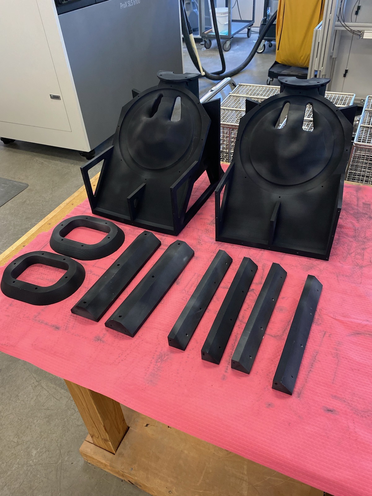

Also, here's a sneak at some of the nylon 3D printed horn parts and cabinet supports

Wow those are looking 10/10 amazing! Try McBride/qcomponents up here in Canada for the emince mounts,
Thanks for the lead @ab01ns that worked out great.

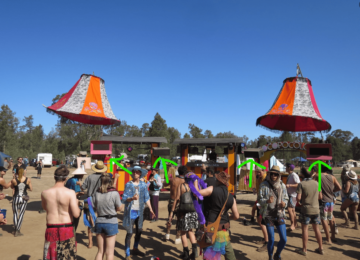

Major elements in the Burning Man Playa Dust (oxide percentages by weight):
SiO2 43.1 % Silicon dioxide
TiO2 00.49% Titanium dioxide
Al2O3 11.8% Aluminium oxide
Fe2O3 05.32% Iron oxide
MnO 00.08% Manganese oxide
MgO 03.46% Magnesium oxide
CaO 04.51% Calcium oxide (quicklime)
Na2O 02.29% Sodium oxide
K2O 02.82% Potassium oxide
P2O5 00.19% Phosphorus pentoxide
LOI 25.4% (organic material)
Total 99.52 %
Most of these dust particles are caustic or abrasive, and Fe2O3 is attracted to magnets.
Magnetic strength in a speaker is highest in the gap, it does not take much iron oxide to cause dragging coils.
Seems a lot of the SynTripP and Keystone users don't install grill material, which would reduce the amount of junk inhaled by the drivers.
Art
Thanks for the heads up, Art. I will definitely make some grills before hauling them out there. Playa dust is powder fine - hopefully I can find something that will make a difference

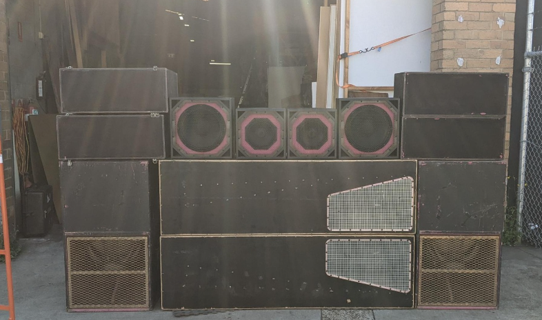

We now find ourselves usually wanting additional output for our mains. Curious if anyone has used these stacked vertically, with or without a splay (without the horn extender) and what worked best. Or even if it would be possible to have them stacked and build a larger horn extender that goes around both speakers.
We also have 4 with orignal specd components.
We just did this. Not ideal in theory, but we are limited for space on the artcar, and this works fine.
We run 4 tapped horns two XOC1 TH18 and two tapped horns that I refolded to fit in a tight space that actually work ok.
A member called Finbot used 4 Syntripp and 2 tapped horns for bass to provide sound for 3000 people outdoor. It raised alot of concern, but he was adamant it was 3000 people. Its the bass he complained about. You should find his comments if you search for his comments under his username. I will post the video link and description for you.
4 Syntripp + 2 TH for 3000 outdoor
At the distance the two were at, they were 180 out of phase around 40hz. So bass was dead at the sides. But when that many people were packed in like sardines the bass from each speaker didnt reach the other, and the bass was way louder everywhere. It took me a while to work out why they hell there was so much more bass compared to an empty dancefloor. Fun times.
Hi Fin,At the distance the two were at, they were 180 out of phase around 40hz. So bass was dead at the sides. But when that many people were packed in like sardines the bass from each speaker didnt reach the other, and the bass was way louder everywhere. It took me a while to work out why they hell there was so much more bass compared to an empty dancefloor. Fun times.
Might have been the acoustic path length between the two was altered by having to snake through and around the sardines 🙂.
Your description reminded me of a scaled up version of the concept used in the Electro-Voice X-line array's "Pin Diffraction Hydra" to diffract and delay the wavefront in the center of the horn.
I also have read an article about the affect of the audience increasing the delay time of floor subwoofer arrays compared to the direct path of the top cabinets, but can't find it...

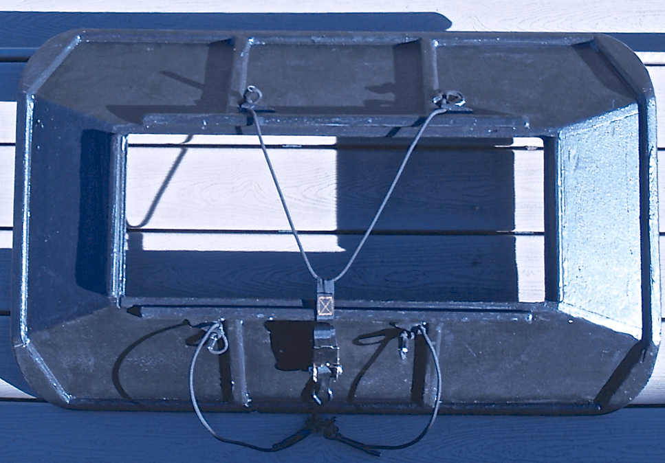

Want to build the secondary horns now, can someone please post some more detailed pictures from the side/back and/or has plans? I'm still a newbie on building speakers and have a hard time to really get Arts plans for the secondary horn.
Other than that had the luck to listen to Danley synergy horns in germany and absolutely could not tell much difference to the syntripps soundwise. Both perfectly clear and extremely fast. Easily the best sounding speakers at fusion festival where i could compare them directly to almost anything big out there.
Here you go:Want to build the secondary horns now, can someone please post some more detailed pictures from the side/back and/or has plans?

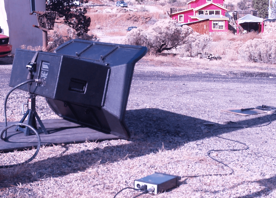

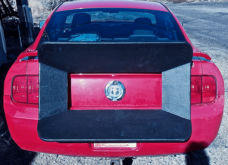

Sold the SynTripP cabinets, still have the Mustang:
Art
- SynTripP: 2-way 2-part Virtual Single Point Source Horn
