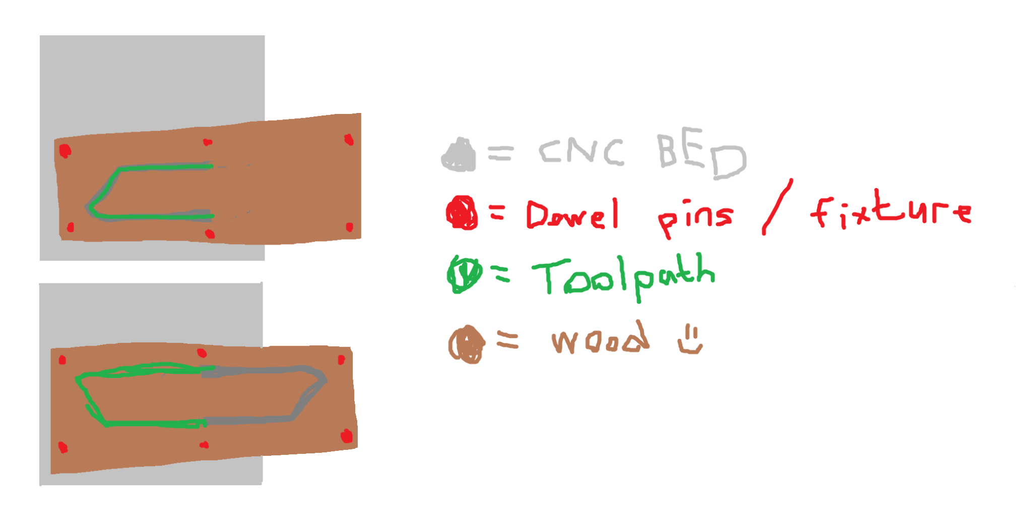

3. The outline of the secondaries were cut by CNC and all the angles were done by hand, correct. You could absolutely do the angles using CNC as well, we just didn't have the appropriate mill for it. Yeah, both the angles at the mouth of the horn and the overall slightly oval curve is purely for looks and deviates from the original plans.

Thanks for the quick reply Leo!
Problem with the horizontal wing of the secondary horn is that it is quite large and I haven't found a cnc big enough that we can use. Contractig someone is way too expensive for us, it's like 10 times the cost of the wood. I think we'll try making them by hand.

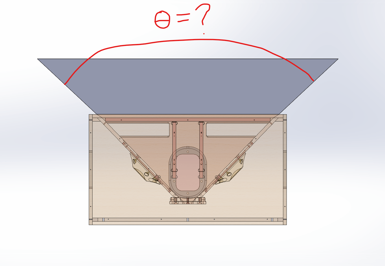

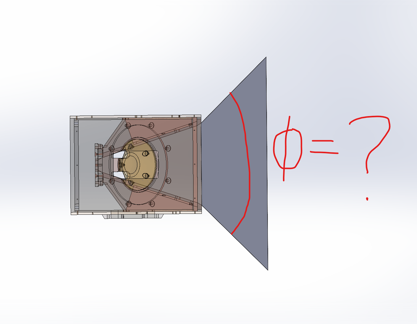

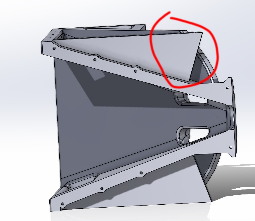

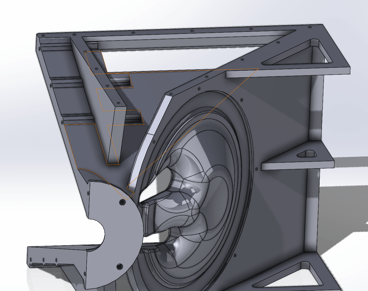

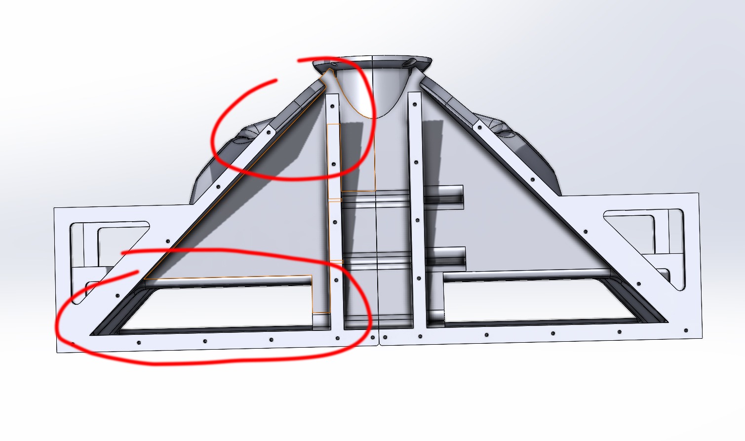

New to speaker design, love the community effort here and the plethora of build documentation. I have been picking apart mrspeakers' solidworks file to understand the geometry better and had a question about the reflex ports.

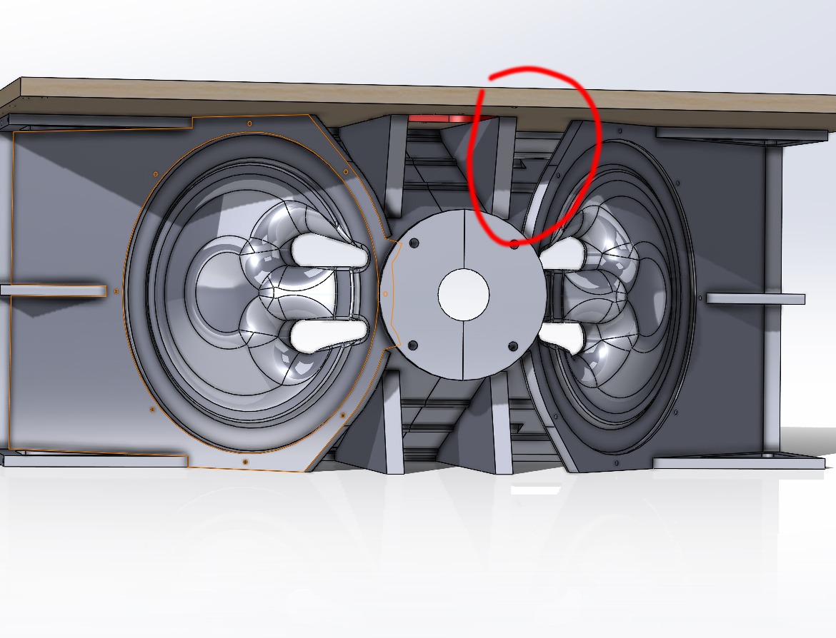

Am I crazy for thinking the reflex ports are either too big, or are being throttled in performance by the interior bracing geometry? I definitely haven't read every post in this thread but I have read a lot of it, and searched a bit for an explanation. Sorry if this is a basic question but if the air being pushed in/out of the reflex ports is being driven by the 10" drivers, through the interior bracing geometry, is that a consideration when designing the reflex port size? The holes created by the top/bottom braces are way smaller than the actual holes in the horn.
The shape of the triangle that braces the top and bottom of the horn against the cabinet differs from build to build, and I am referencing the onshape from finbot and the mrspeakers' solidworks file as well as the large folder someone assembled of everyone's build pictures. It seems changing the size and shape of this single piece would affect the amount of air that can squeeze through that opening. In the last image highlighted in blue there is a fillet on an interior edge almost like this was a consideration. The images are all from mrspeakers' file.
Is this sort of feature a negligible consideration?

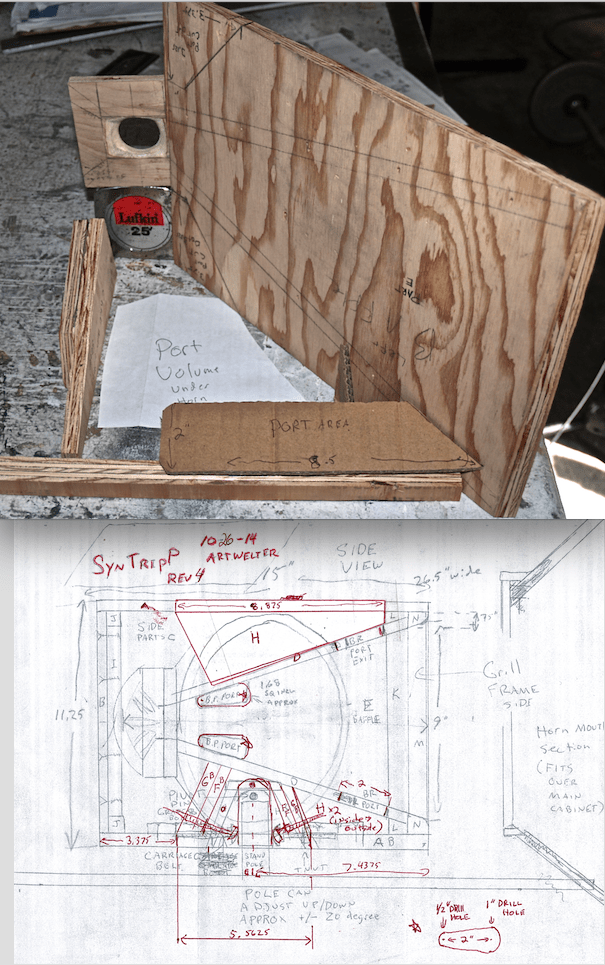

No, you are not crazy thinking the reflex ports are too bigAm I crazy for thinking the reflex ports are either too big, or are being throttled in performance by the interior bracing geometry? Sorry if this is a basic question but if the air being pushed in/out of the reflex ports is being driven by the 10" drivers, through the interior bracing geometry, is that a consideration when designing the reflex port size? Is this sort of feature a negligible consideration?
The triangular inner port sides are the left and right sides of the adjustable pole mount, missing in the pictures you posted. On the top, those port sides you referred to as braces, are duplicated, the volume between them left open to the box interior. The left and right horn walls make the outer port sides. The horn sides are cut down close to the 10” drivers.
The port entrance cross sectional area and exit are roughly similar.

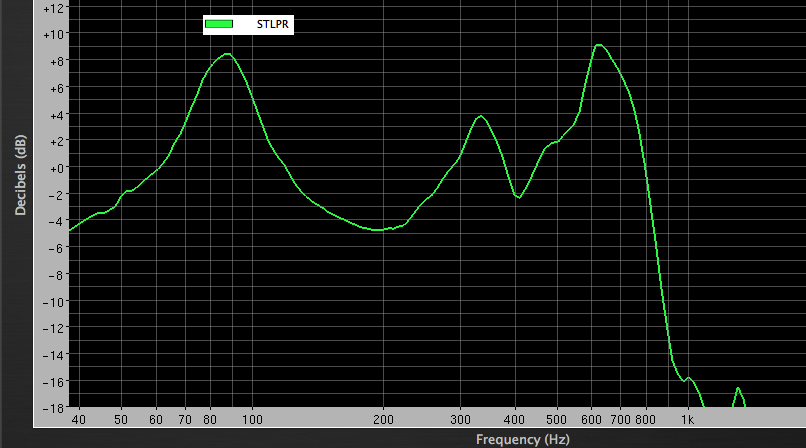

The large enclosed port volume and length required a very large port exit to achieve the Fb (box tuning frequency) of ~81 Hz (the low E on a guitar).

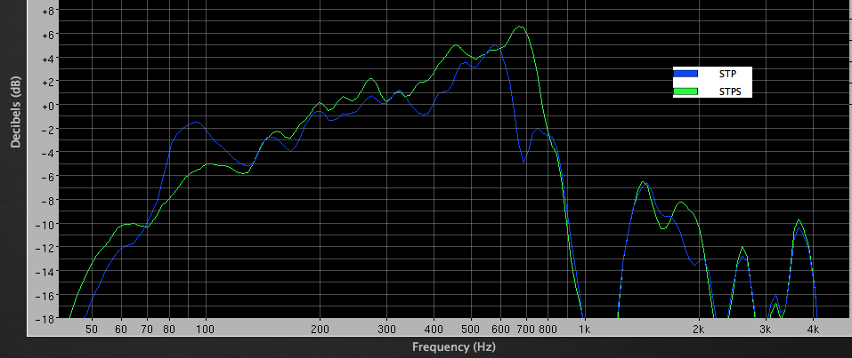

The large port volume and cross sectional area also results in large port resonant peaks (pipe resonance) at 335Hz and 634 Hz seen in this port exit trace:
The upper pipe resonance is out of phase with the 10” horn output, causing a narrow cancellation at 700Hz. Ground plane test at two meters from the secondary horn mouth, green trace is the sealed response, blue ported:
In retrospect, the 3dB gain the ports provide around Fb are probably not worth the -3dB 350 to 475Hz and-10dB cancellation at 700Hz. That upper cancellation requires more output from the HF driver to “fill the hole” in response they cause. Most 3" diaphragm drivers are already excursion challenged in the acoustical crossover range.
To sum up, don’t bother with cutting the port holes, leave the cabinet sealed
