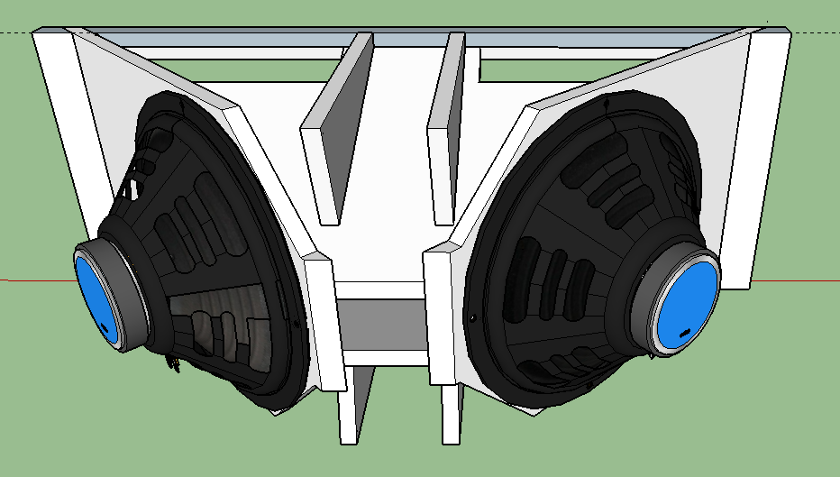

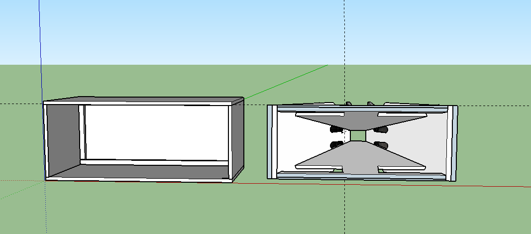

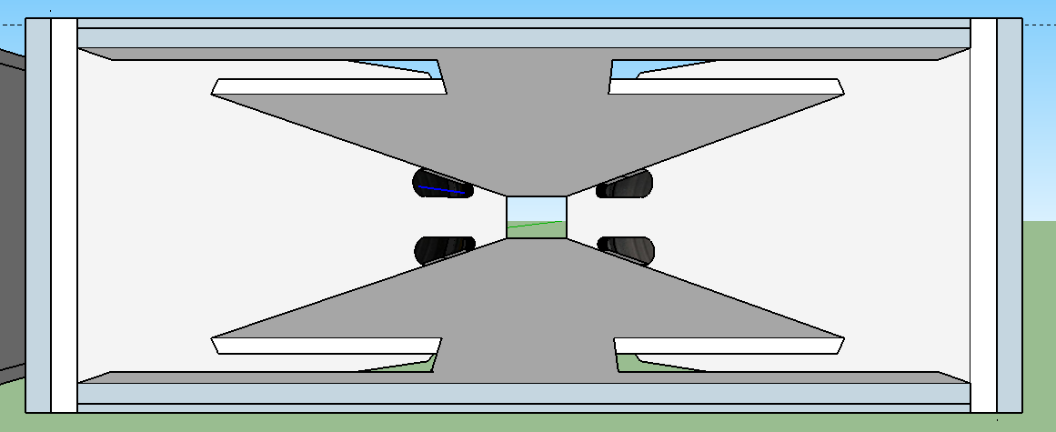

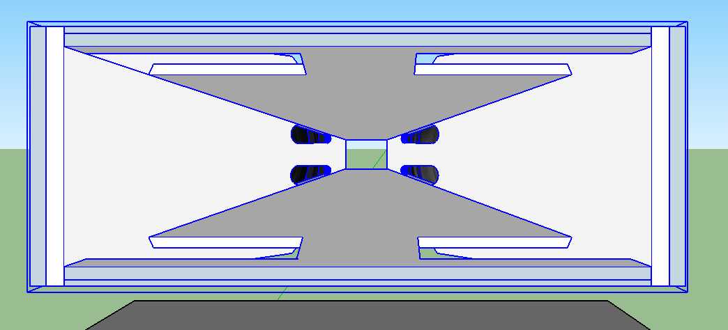

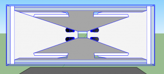

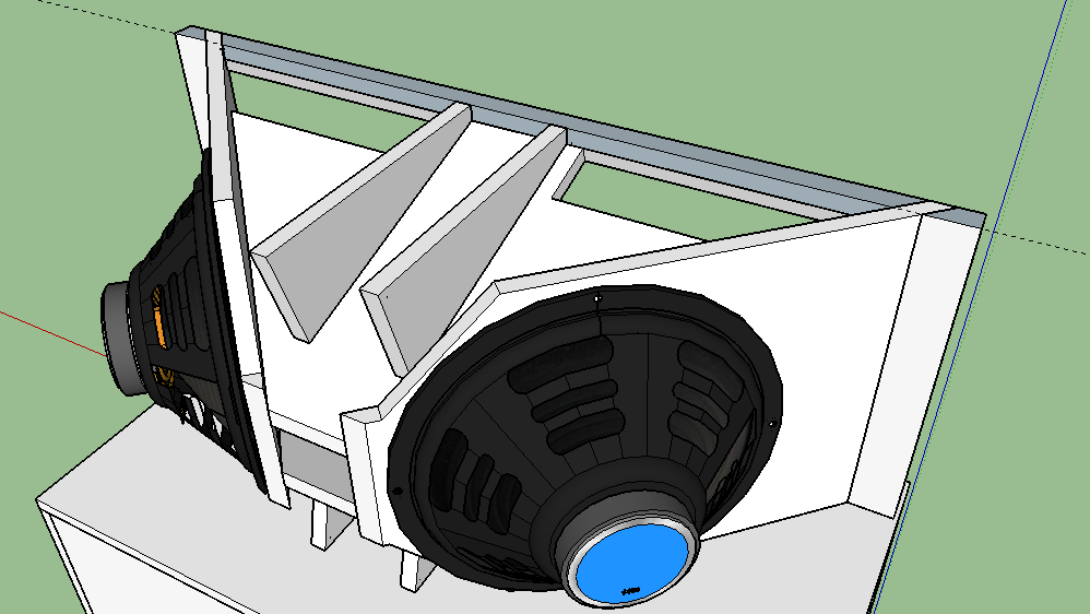

Some correction made to the model, which appears to be measuring up and squaring up just right.

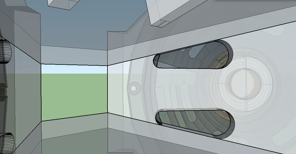

Fin,Corrected the positioning of the injection ports.
The port position now appears right, but is lacking the details of the throat chamber, which would be visible as a thicker depth at the mouth end of the port, and less than 1/2" depth at the throat end.

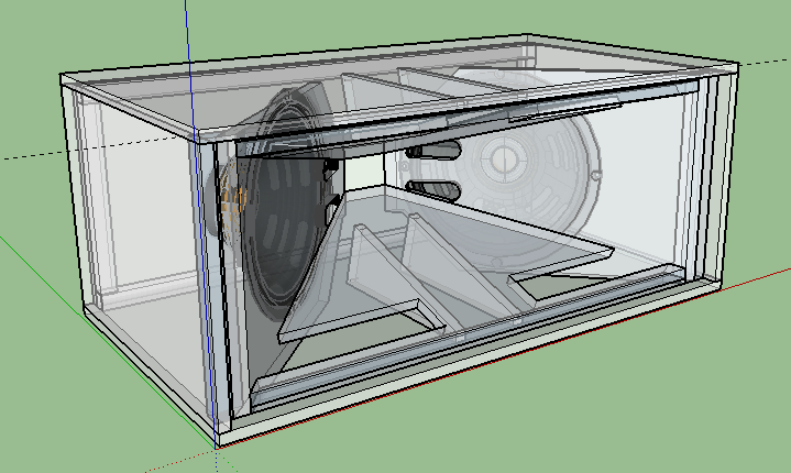

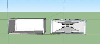

OK here is a link to the model as it currently stands.
https://drive.google.com/file/d/0BwGf5Kb0D758Skl4Sk02a2Zaenc/view
You will need to download sketchup version 15.

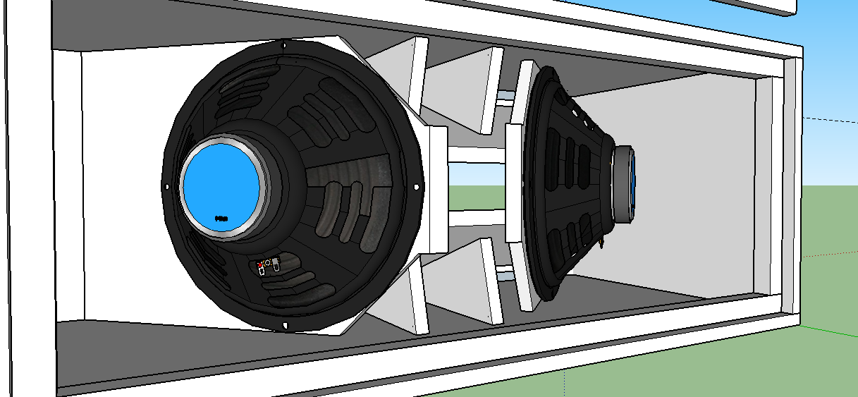

If anyone would like to confirm the current measurements in the model that would be great!
otheriwse, I think its time to get cutting.
I am going to do a build out of 1/2" mdf first, to make some inexpensive templates and keep the cost of mistakes low.
Then I will make a second build out of good solid void free Marine Ply.

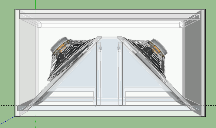

Fin,If anyone would like to confirm the current measurements in the model that would be great!
I don't see any measurements in the model.
Hi Art!
No not yet. I was going to put them in the cut sheet model.
What can be done with sketchup is use the MEASURING TOOL that looks like a measuring tape, and make some measurements.
And also use the PROTRACTOR tool to measure angles.

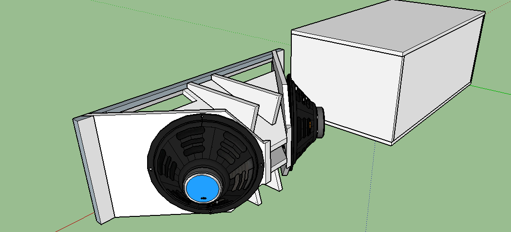

I am currently looking at the plug for the 10" drivers and working out how to manufacture them. Maybe a pivot and a router mounted on an angle.

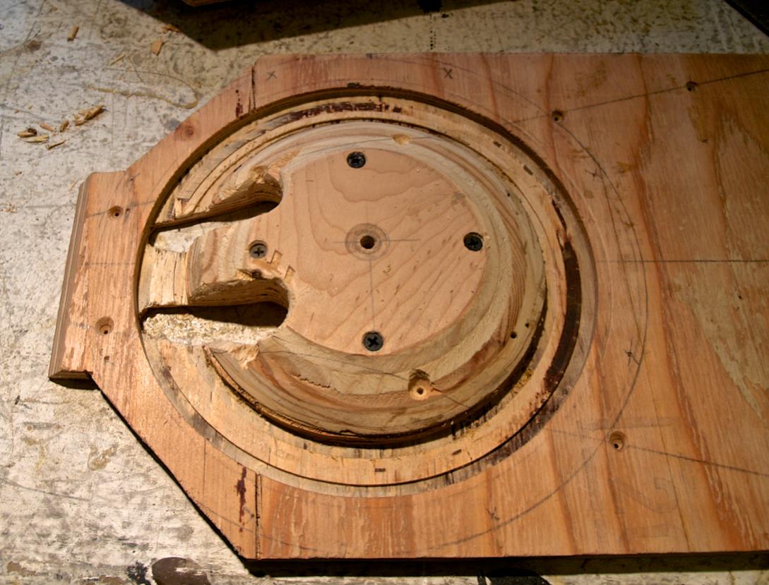

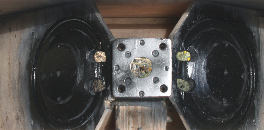

Fin,Also I am looking for a reference point to mount the 10" driver.
Was there a reference point noted anywhere?

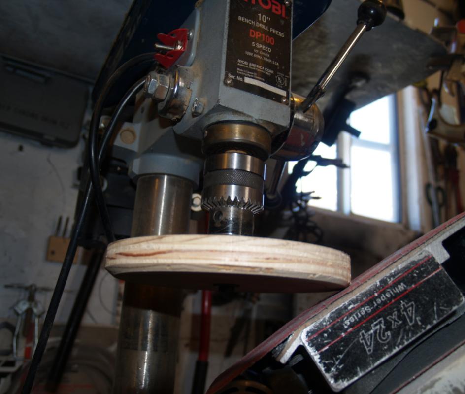

Unfortunately not. The back of 10" mounting ring is almost touching the driver plate (as can be seen in the plans in post #41) from the photo below you can see the location.

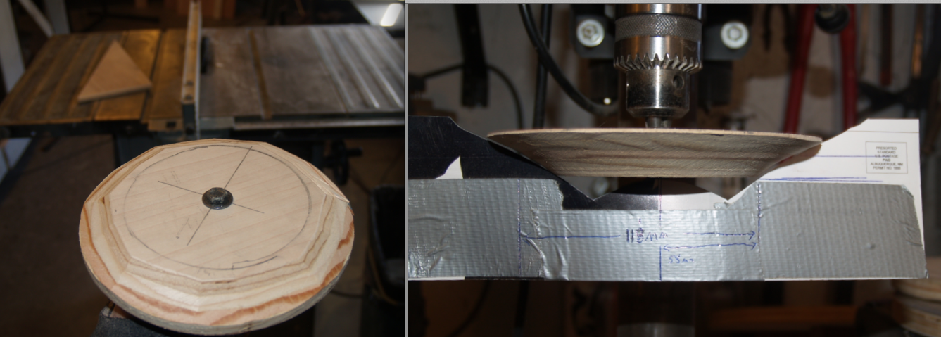

I used a drill press and belt sander to shape the filler cone profile (made from a 3/4" circle cutout), comparing it to a paper template of the cone profile. The first one took a long time, then I realized about 75% of the material that needed to be removed could be cut off with the table saw, minimizing the sanding.
