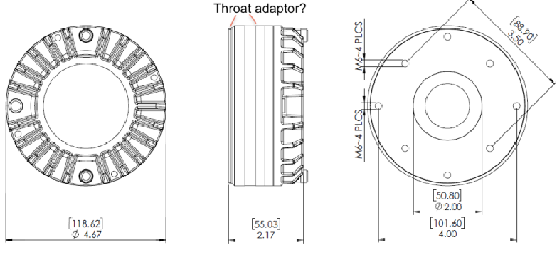

Is it possible to use this 2" driver with a 3" diaphragm in this design? Would the TAP work as a new throat?
Possible, but the 10" drivers would have to be moved forward since the horn would be shortened to accommodate the larger entrance diameter.
The 760NEOPB throat adapter angle is 60.0°, probably will limit the dispersion above ~9000 Hz to that angle.
Looks like the left 2 annular sections comprise it's throat adapter/mounting screw plate.
It is possible they are removable, which would present ~1.25-1.4"" throat.
You could feel (or see) screws under the gasket if the throat adapter is removable.
The screws that install the throat adapter could then be used for be used to mount the SynTripP TAP (throat adapter plate).
If there are screws, they may use Loctite thread lock compound, which requires local heating to remove without snapping them off.
The TAP could be scaled up to a 2" throat entrance.

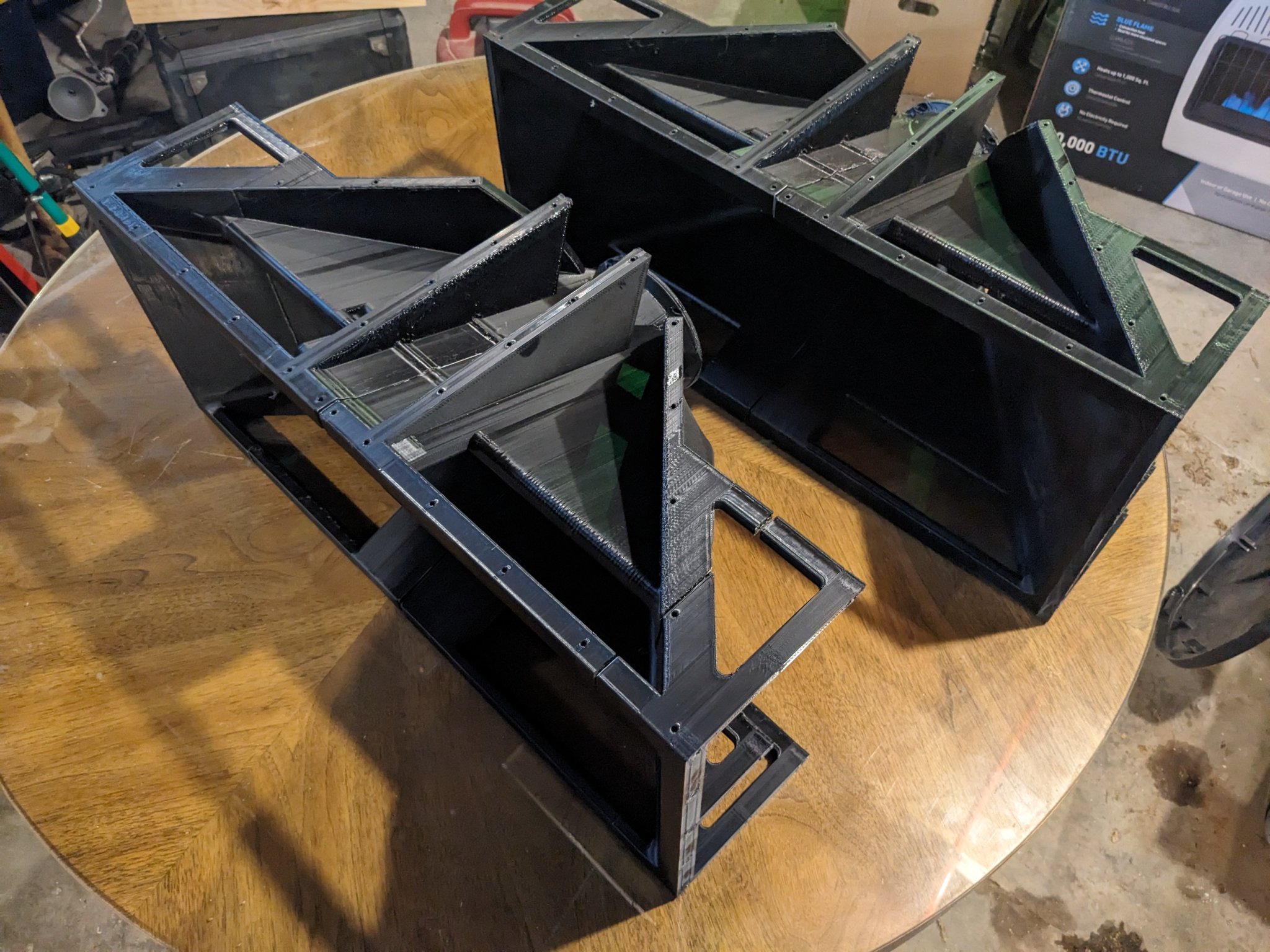

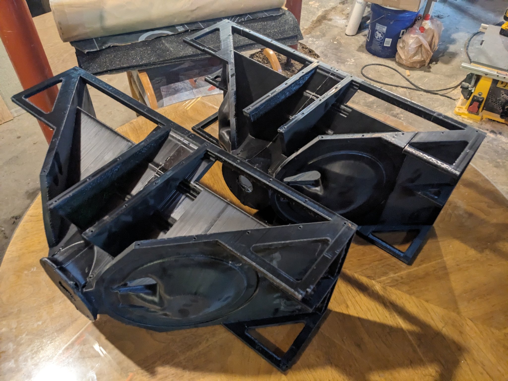

Here they are. Two of them failed right near the end but I managed to print the remaining sections pretty spot on (you can see in the top pic where one of these separations is), and some jb-weld should have everything solid.
Re the printing:
I feel you there. I probably went through 10kg of filament before I got it right.
I recommend using an enclosure for temp stability. Also make sure your z-offset is sufficient to allow for a good squish on the first layer. Try having cooling turned off for the first few layers too. These all worked for me.
I also used a 0.8mm nozzle which made for much faster print times.
Looking further at the design and assuming the entire rear panel is removable, I think accessing the forward screws on the 10s will be ok, if not a bit fiddly.

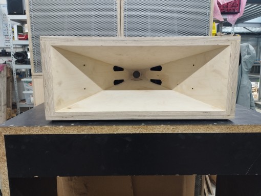

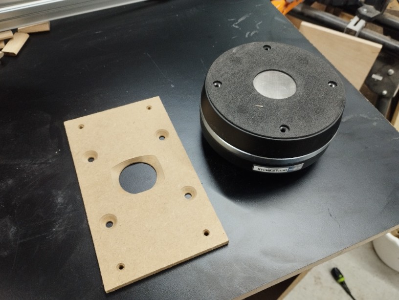

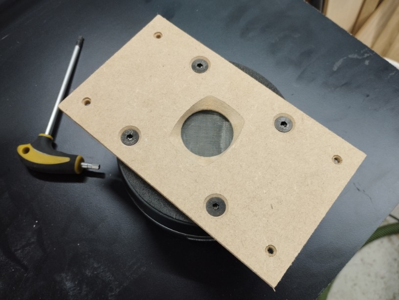

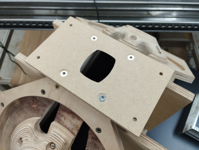

The throat adapter...
I'm trying with MDF cos I had the right thickness on hand. We'll see how it goes
Trying to shape the throat with wood filler. Needs a bit more work to get this nice and smooth

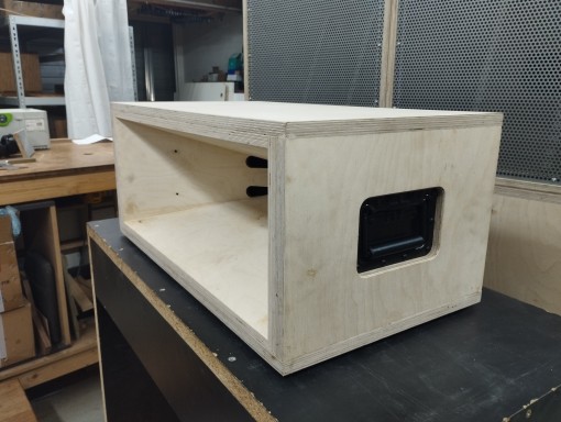

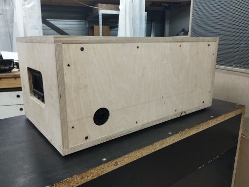

Syntripp #1 of 2 is complete.
10CL51-8 for the mids
DE900TN-8 for the compression drivers
Testing will have to wait until after the holidays, but it's good to finally get it done.
Note that the cabinet is unfinished (and pretty rough looking - no sanding yet) - I plan to complete the build of my whole system before I paint.
I haven't seen many (any?) builds without the ports, so I'm curious to see how it'll perform

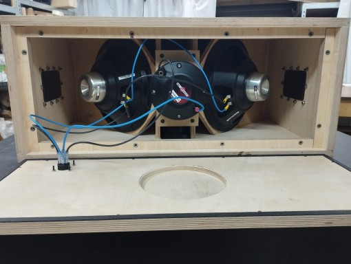

Innards

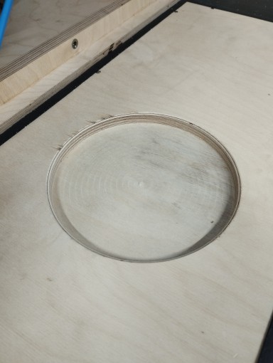

Don't forget to route an extra few millimetres in je rear panel to accommodate the compression driver!

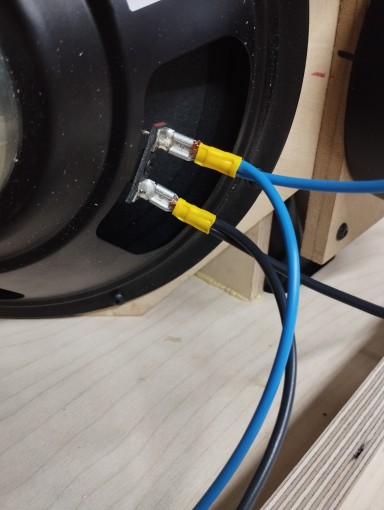

I wasn't sure about doubling up the wires in the spade terminals like this to parallel the drivers, but they seem to be solid.
I will be testing in early January and will report back!

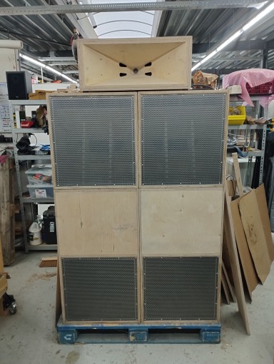

The Syntripps will be pole mounted in the end, but in the meantime here's a shot of my system so far
Syntripp
Cubo kick
Xoc1 TH18
Been looking forward to that update for a while! Great looking stack McFly!
Very keen to see some real world measurements of the non-ported version!
What did you use for grill-covers, & are you planning on adding them to the TripP's? (I prefer the open horn look - especially once the extensions are on!)

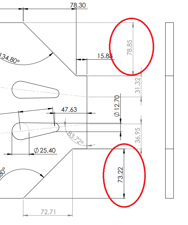

I used the plans from samdboneff. Anoter user suggested that they'd built from these plans, and they were correct (except that did not include the necessary lip for fitting the grille). I think they're a copy / development of the Finbot metric plans.
I am pretty confident that they're not correct as per Art's original design. For example : on the plans I used, this part of the horn is not symetrical, and in the original drawing from Art, it is.
I imported the broad outlines of each part into Fusion360 and then corrected things like the above issue. I didn't refer to Art's original plans to be honest - I found them extremely hard to decipher.
I nested a load of parts for the inner horn together and then cut them in Fusion and then spent a lot of time on the table saw cutting the angled edges as accurately as I could.
I used the plan for a jig also included in the Finbot / samdboneff folders and the inner horn came together reasonably well but not perfectly. You'll see the issues if you browse back through my last few posts. I managed to overcome the stuff that didn't quite fit with some creative woodworking (ie, lots of sanding 🙂 )
I also found that the width of the top and bottom panels did not match the wdth of my inner horn plus width of side panels. - mine needed to be a few mm wider than the plan to accommodate the outer shell.
Basically, with some fettling I was able to get everything fitting well enough. I still haven't actually tested the syntripp so I have no idea how it sounds or measures, but I am fairly confident that it will work well enough for me.
My suspicion is that every version of plans in the Google drive folder is slightly different from Art's, and also slightly different from all the other plans. Despite this, people have overwhelmingly reported being delighted with the sound of their Syntripps, so my feeling is that small variations (a millimetre or a degree) here and there will not have a catastrophically negative effect on the overall performance.
