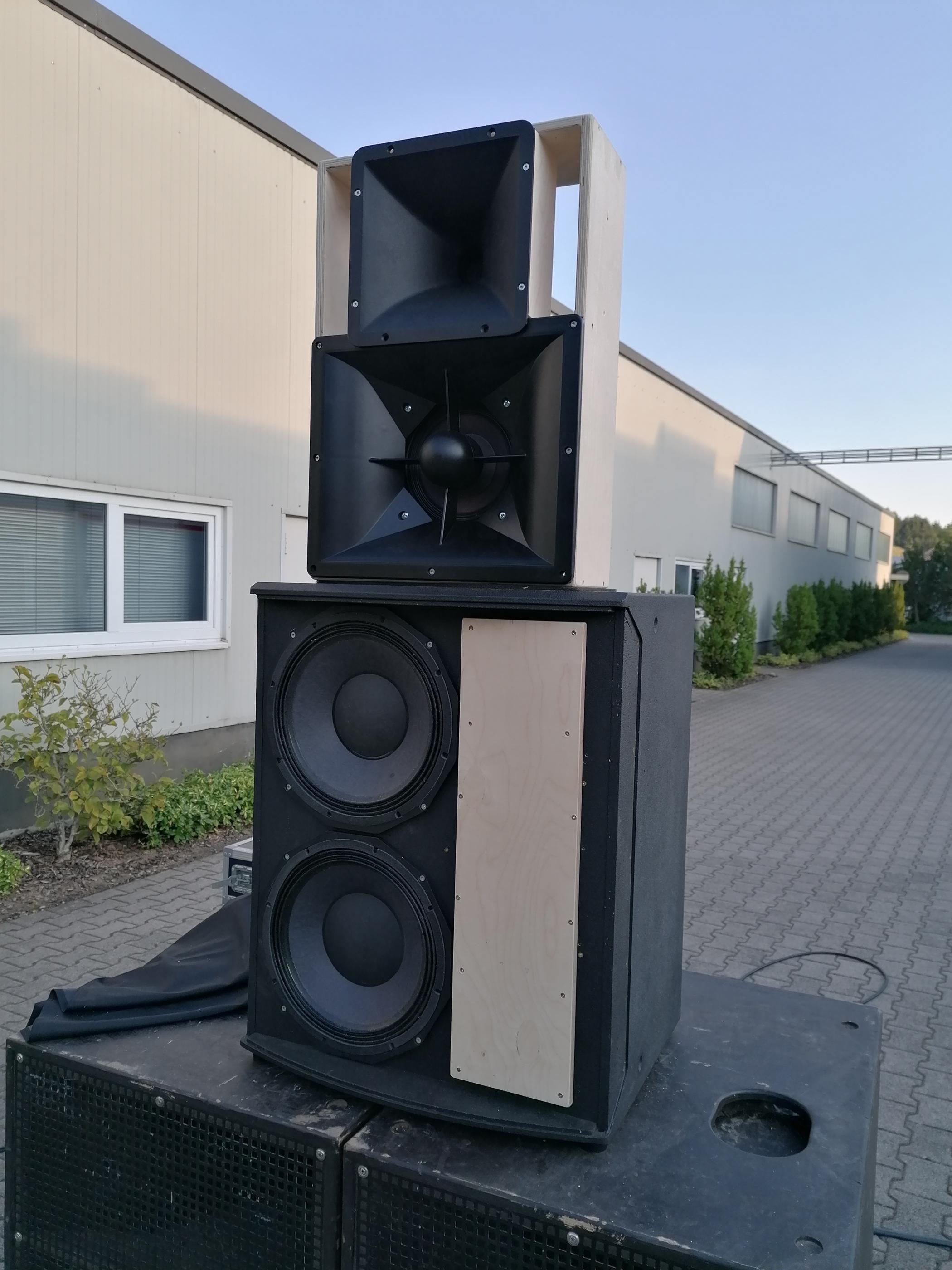

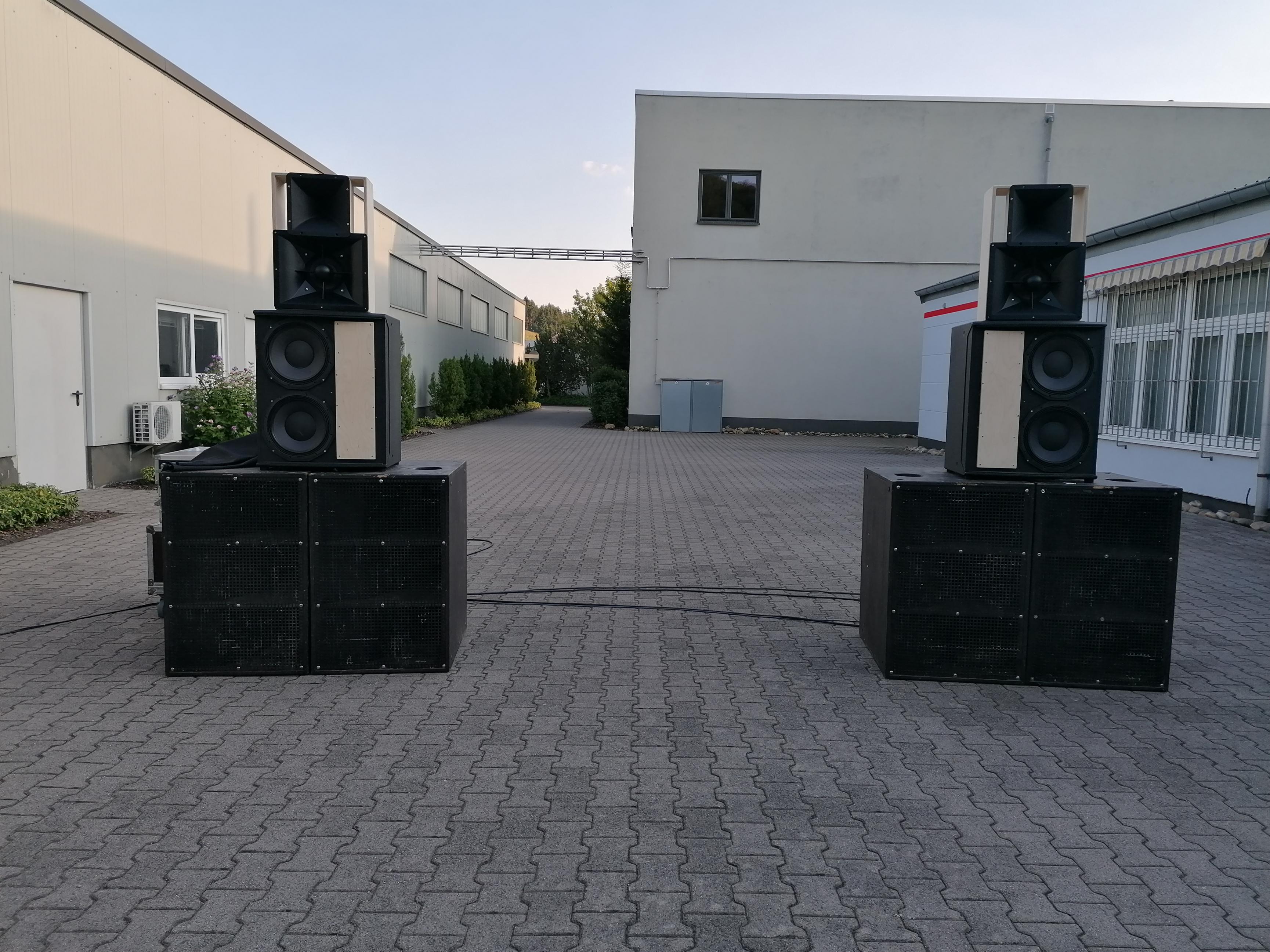

There is my little PA System I use for indoor and outdoor electronic music reproduction.
It's a fully active driven 4 way SYSTEM, equipped with :
8X15"BPH (B&c 15NW100) ,
4X12"CB (PD12SB30) ,
2X8" (RCF H6000, MR8N301) ,
2X1,4". (18SOUND 1480ND@ B&C
ME90)
The PA is driven by Linea Research 44M20 for LF and Digam K3 and LQ2804 for TOP, DSP is a T-racks FIR 4X8
Filters are :
No lowcut
18dB BW @ 90Hz
12dB BW @80 Hz
12db BW @450Hz
12dB LR @480Hz
18dB LR @1.4K
12db LR @2.8K
With this filter settings no eq is required for the whole system.
next step will be to use 16x10"CB instead of 4X12"CB because the 12" part is the weak spot of the system.

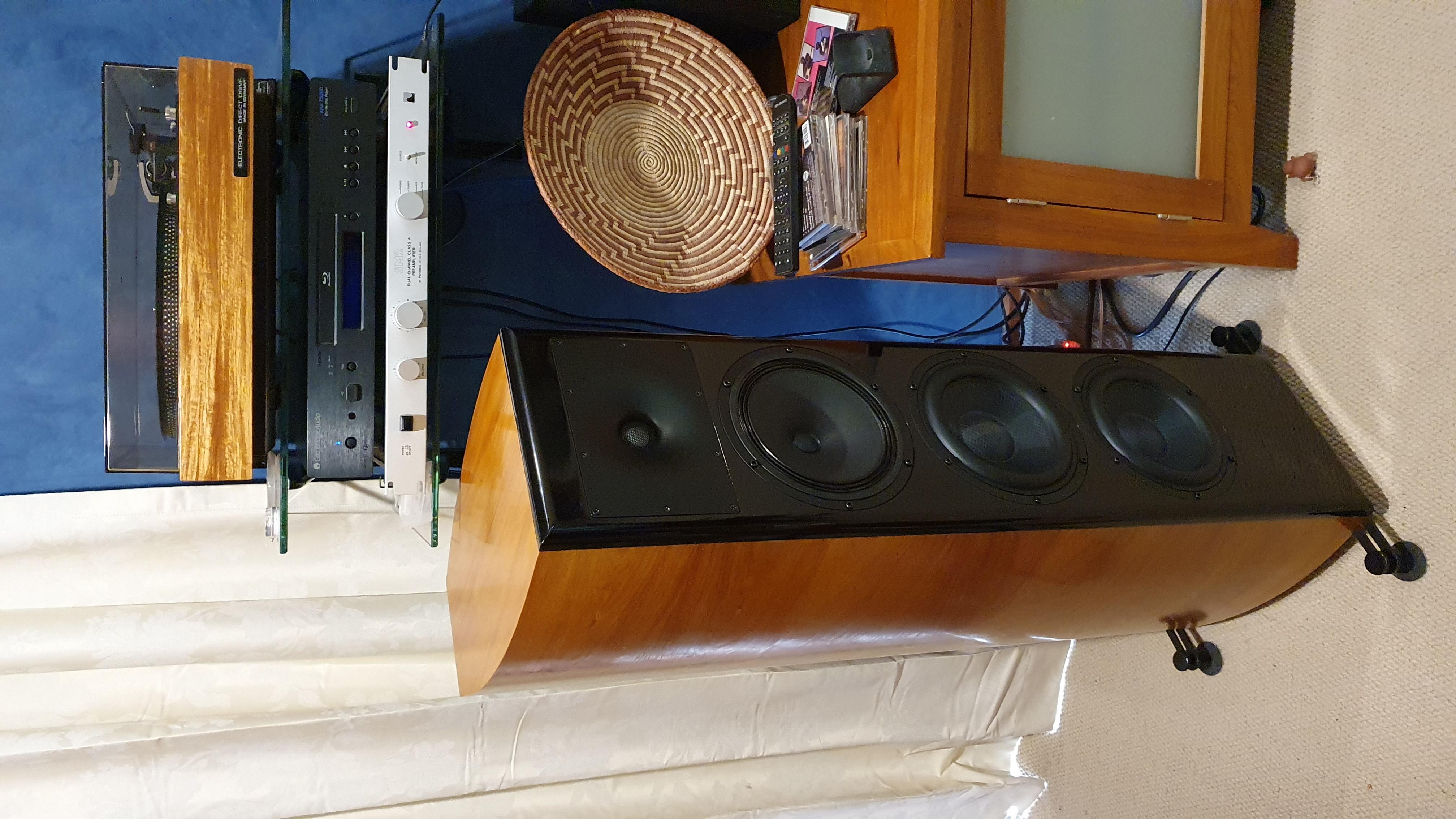

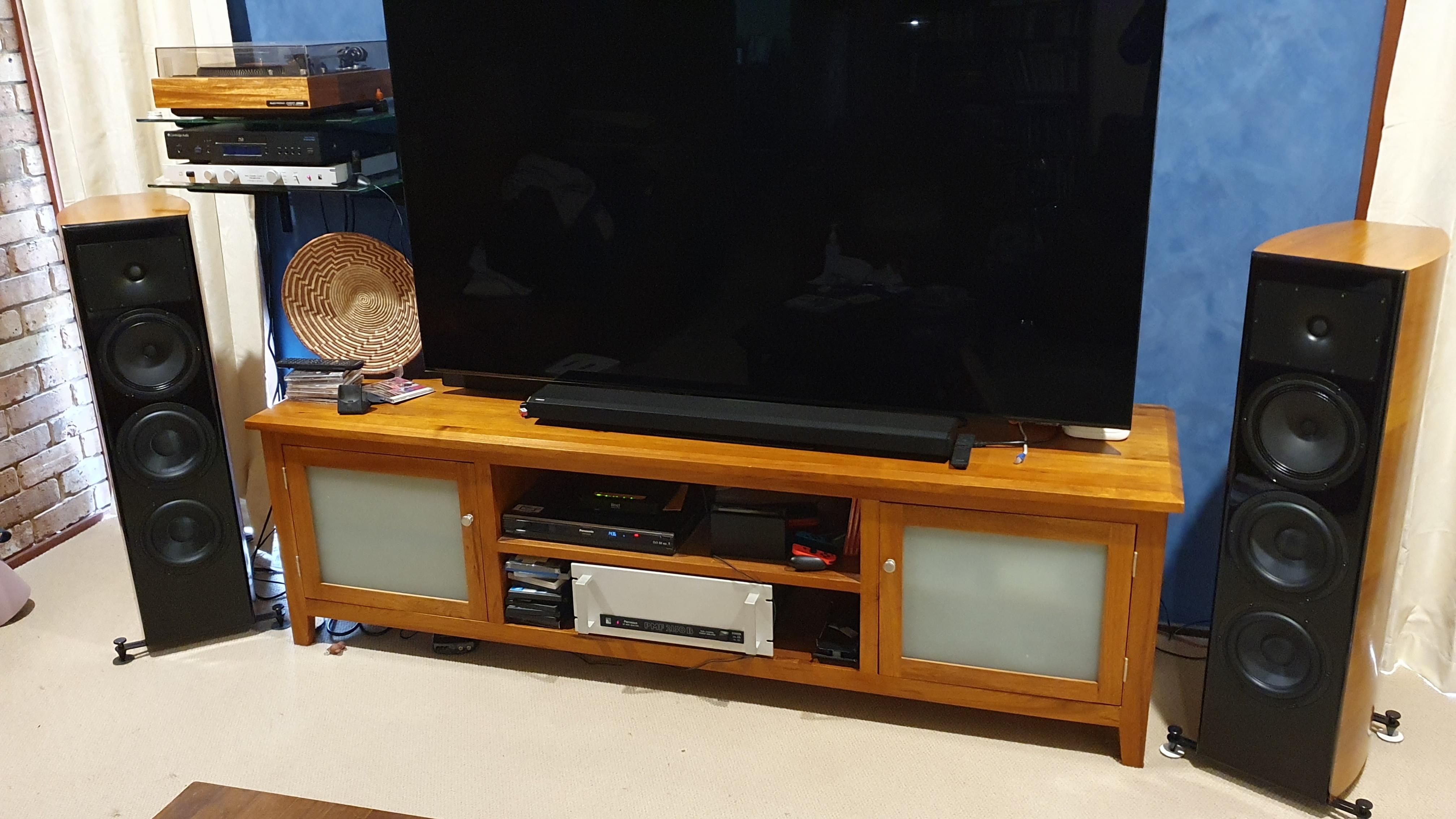

Speakers based on Visaton's "La Belle" kit, recently completed (sliders still under cones for positioning); curved cabinet with Blackwood veneer. Vintage Perreaux SM2 pre+PMF2150B power amp, and Dual 704 TT for which I build a new plinth out of New Guinea Rosewood. I had almost no woodworking experience before this and had never held a soldering iron, so it was a miracle it turned out as well as it did. I'm sure there a better speakers out there and everyone has their opinion, but I love the sound of these.
- System Pictures & Description
