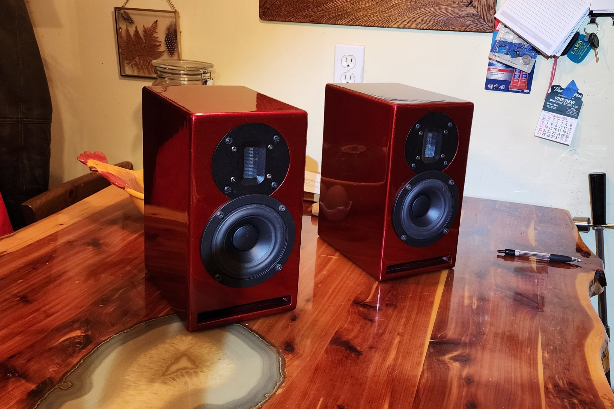

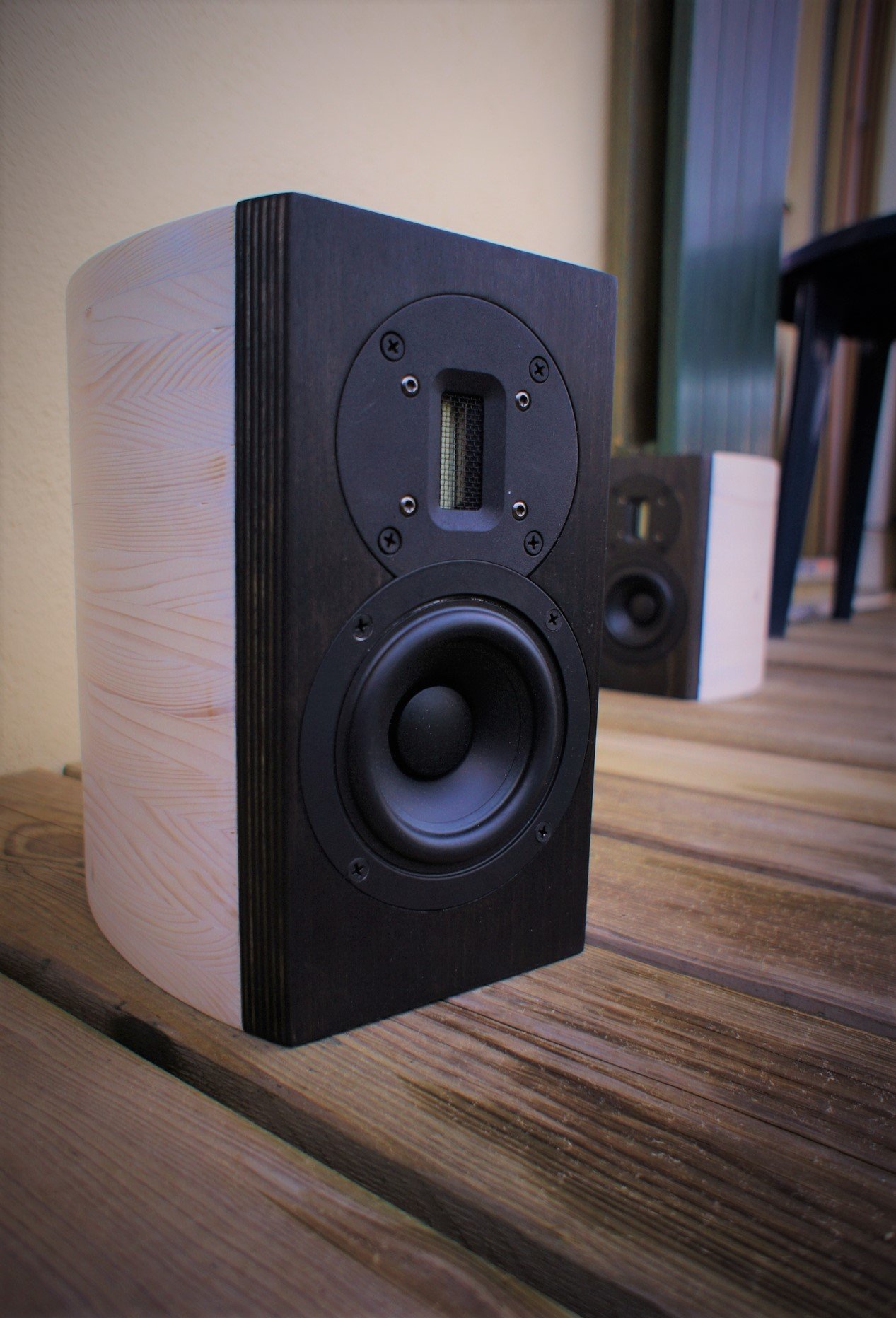

Oh thats part of the fun of this hobby. Figuring out how to hide mistakes so they just look part of the design. I too made a ton of mistakes on my build.I made many mistakes
Your design looks damn nice. I love the unconventional shape.
Not what you need to hear now Byron, but there are people around here with router jigs for that frame.
🤣🤣🤣Not what you need to hear now Byron, but there are people around here with router jigs for that frame.

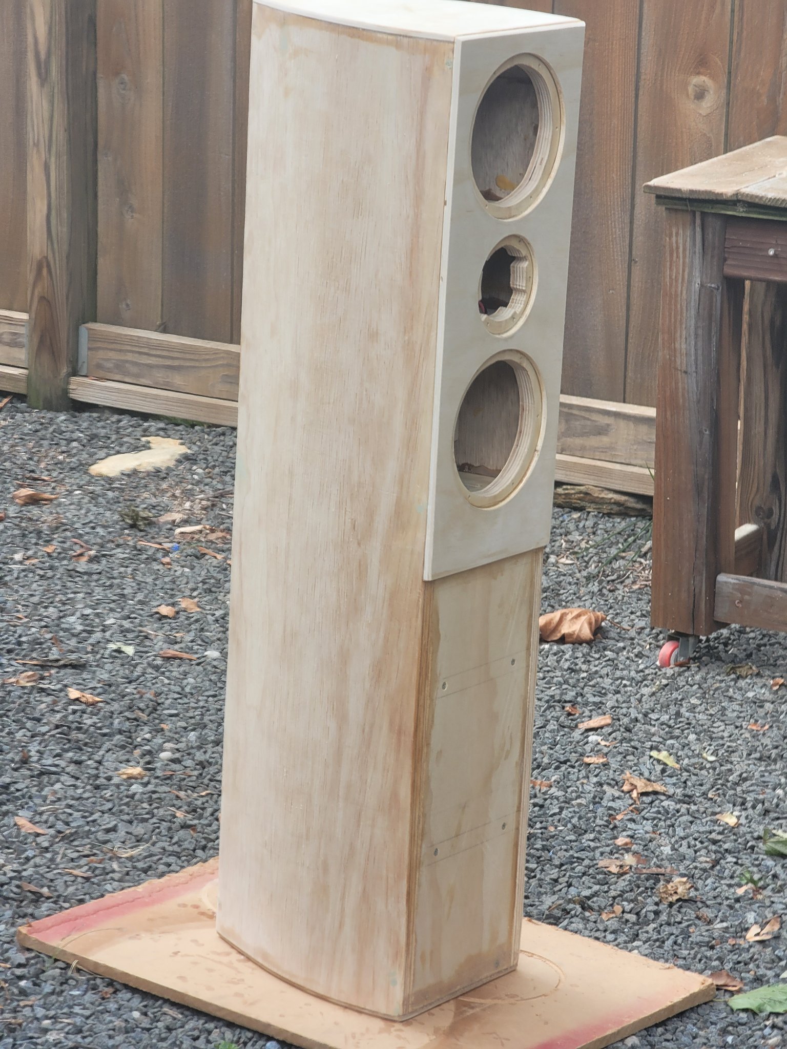

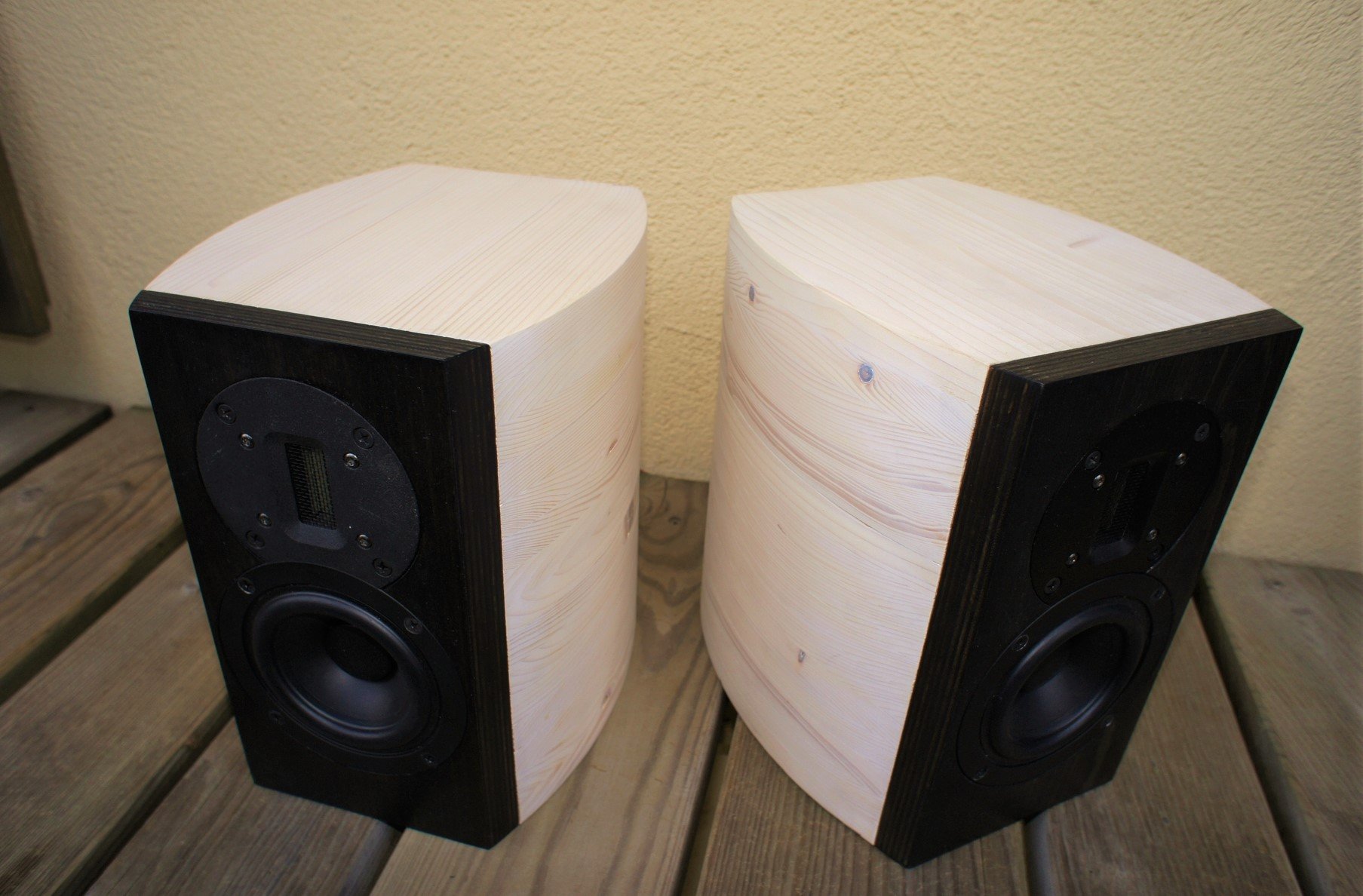

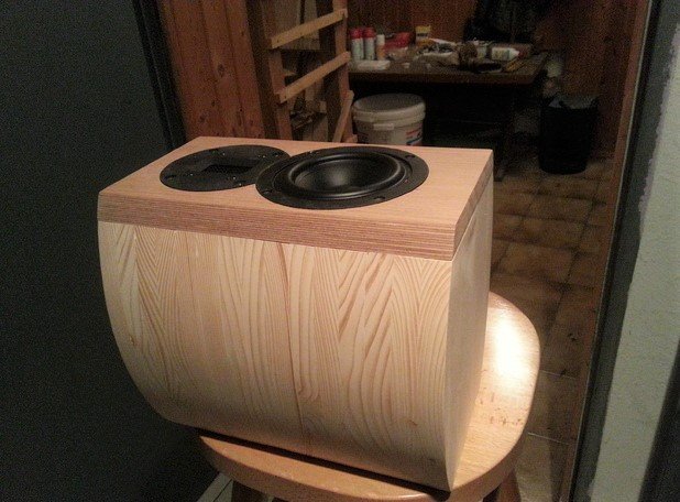

No, that is a very specific edge reflector that was designed to direct some of the top woofer down ward. Why must I think for you.That is a fix for a mistake I made. I made many mistakes. That mistake was: I somehow cut all the baffle holes 3/4 inch too high! I didn't realize the mistake until I found that I couldn't insert the top woofer, because the speaker top was in the way. So I cut out a notch in the top and covered it with leftover wood.

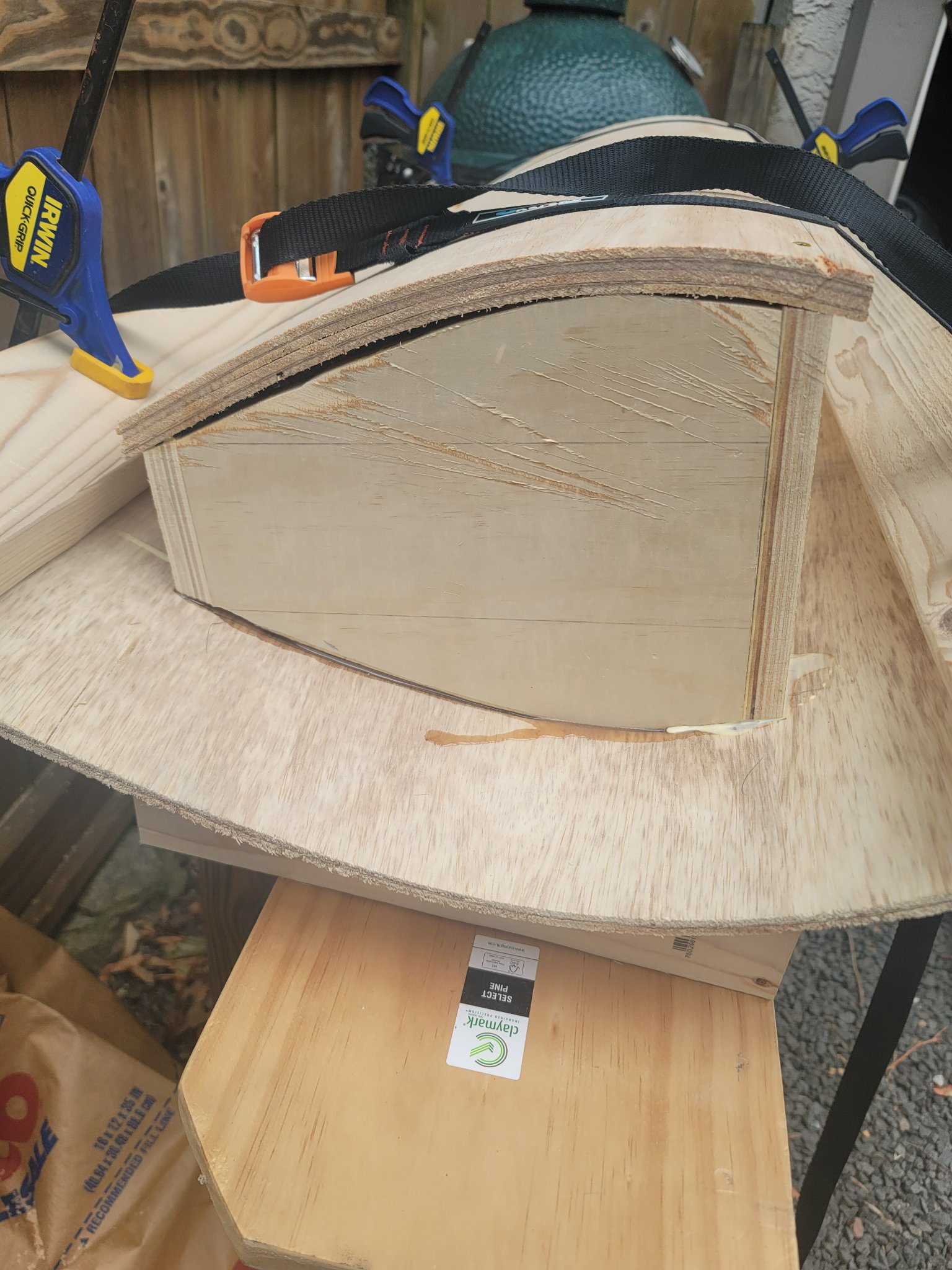

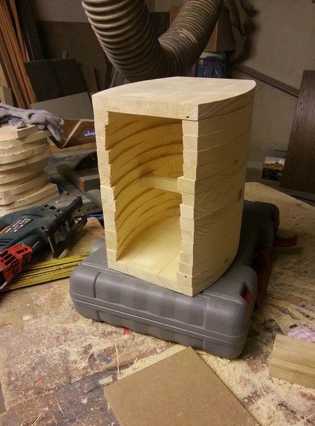

My build. Curved Sides are made from 2 layers of 3/8" birch bending ply. When sandwiched together with half a gallon of Tightbond 3, the curve is extremely strong and rigid.
My first pass at attaching the first layer of the 3/8" birch bending ply left some big gaps. I wanted to throw the whole thing on the firepit, but once I calmed down, it was totally saveable with a bit of modification.
Filled them with epoxy. And epoxyed a 1/4" plywood panel to the top. Oh. And I discovered the arm muscle building joys of working with a japaneses pull saw for flush cuts.

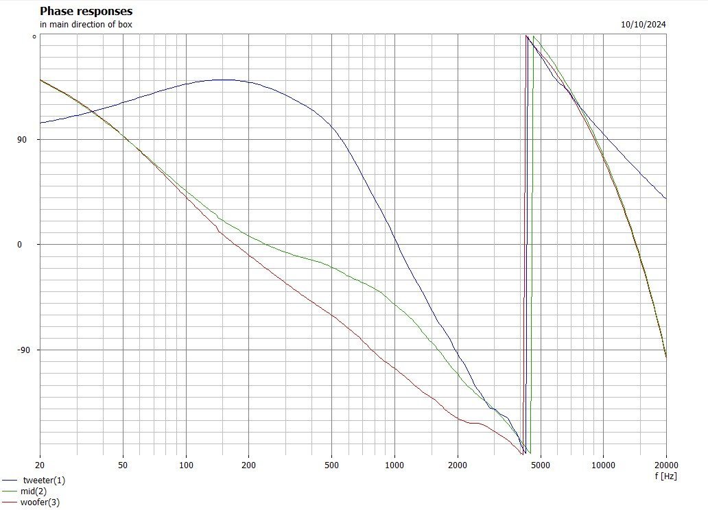

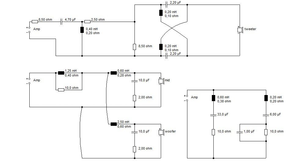

Yep. Definitely worth it. I tested it vs several other variations, and kept coming back to it. I was inspired by an old Dynaudio speaker crossover that had 2 of them. I modeled 1 and it worked perfectly to draw in my 2nd order tweeter crossover to be perfectly in phase with the Satori midbass.Wow, a ladder delay! Went there huh?! Worth it?
Before I used the ladder delay. It was nice but a bit congested in yhe upper freq. After I tried it, it just sounded right.
Also. i tried some combos where I had a 1 to 2 ohm resistor in series with the shunt 0.4mH coil to change the shape of the tweeter rolloff at low freq. In every case I hated it.

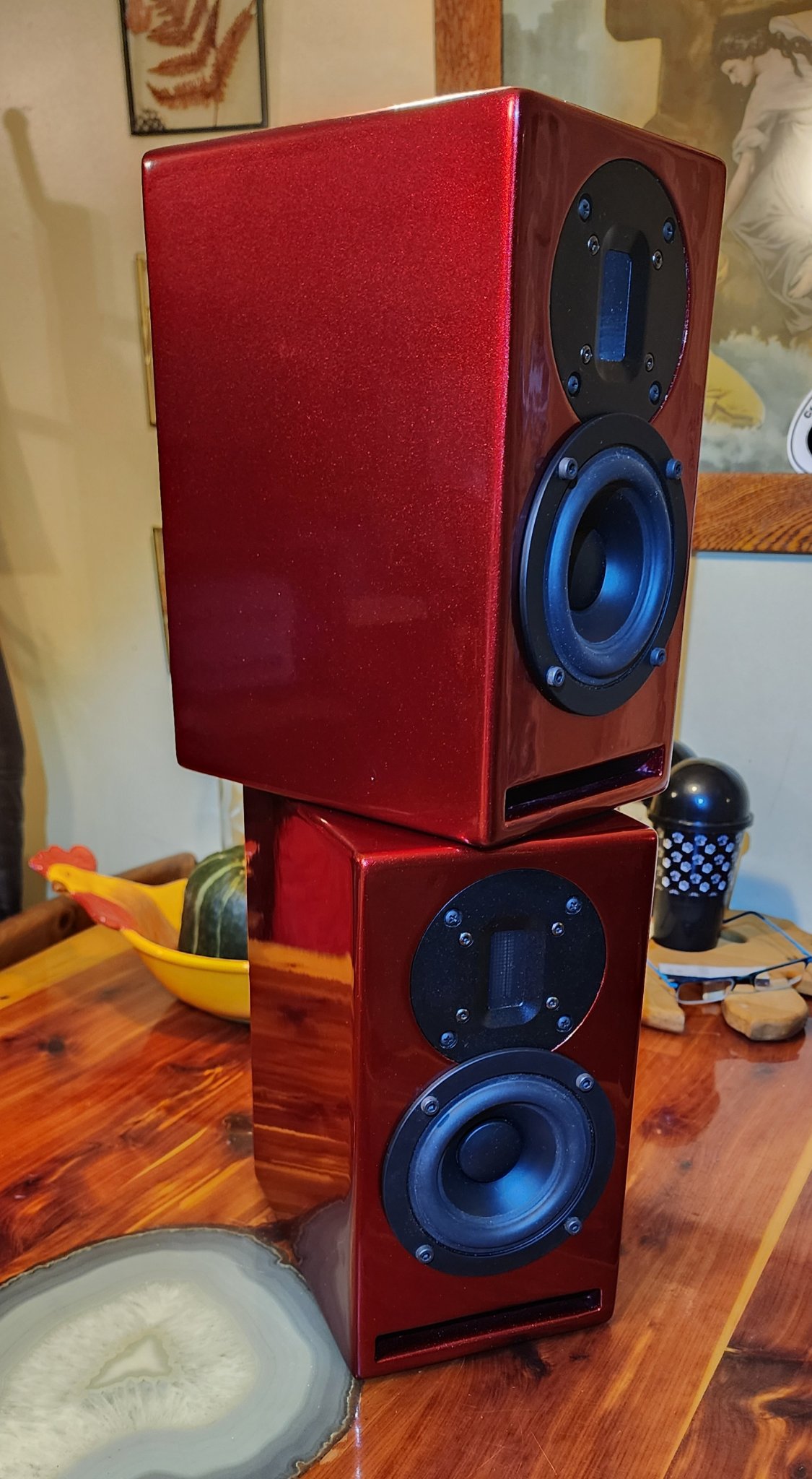

Thanks, I think that's the best I've ever done with a spray can.
Gotta say when I looked at that crossover schematic the letters F, W, T came to mind and not in that order.
S'poze I have some more reading to do.
Hmm... "ladder delay" ...
