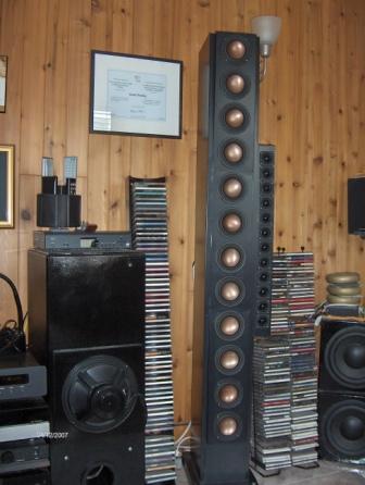

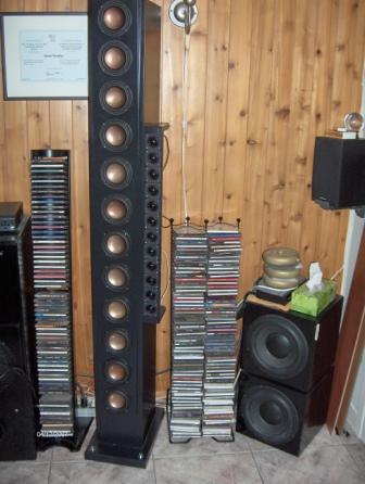

Hi, these are a few pics of my line array I just completed, 12 4inc Hi-Vi and 12 1 inc hi-vi dome tweeters. Open baffle I listen in the near field. 95 db/w sens, they have a really sweet sound and they make cd listening like analog. I also made 2 Iso-barik Peerless 831727 subs I use for music listening -3 db at 20 HZ and 2 peerless XXL with PR for HT -3 db at 30 hz.
Happy listening

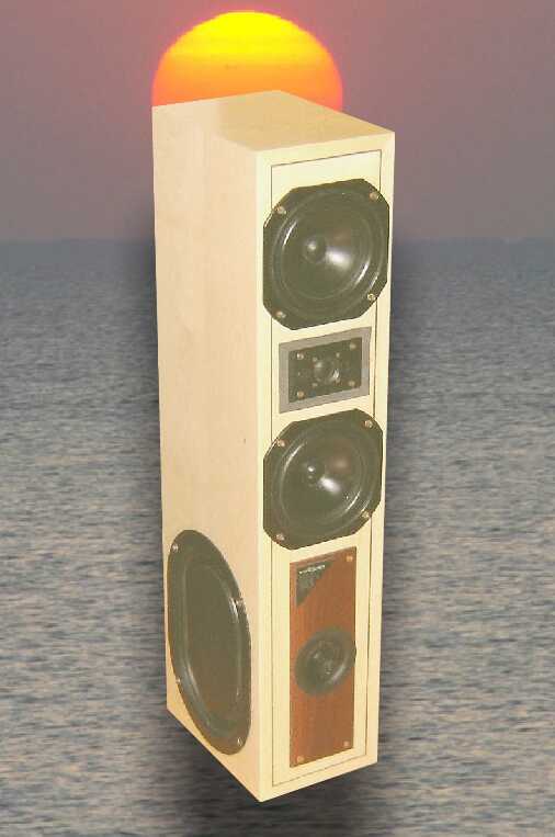

Hi guys, I completed these speakers last December and have been using them since. My objective was that the cabinets be relatively small and that the cabinet contribution to the sound is negligible. The cabinets are made of solid 30 mm thick beechwood and measures 1100 (h) x 350 (w) x 400 (d) mm. Frequency response is very much usable down to 10 Hz.
All drivers are from the KEF stable using the renowned B139 as bass unit. Each unit is driven by its own 70 watt class A amplifier and the tweeter by a 15 watt class A amplifier. Electronic crossover phase adaption provide an almost flat response from 10 Hz to 30kHz.
There are five braces in the cabinet. The exhaust consists of a 9 meter long 100 mm Diam flexible hose fitted into the cabinet and ported out on the front. Cabinet is also lined with combination of wool and polyester fibre.
Cross over frequencies selected are Bass 300 Hz, Mid Bass 300 Hz - 900 Hz, Mid 900 to 2700 Hz and treble up from 2700 Hz

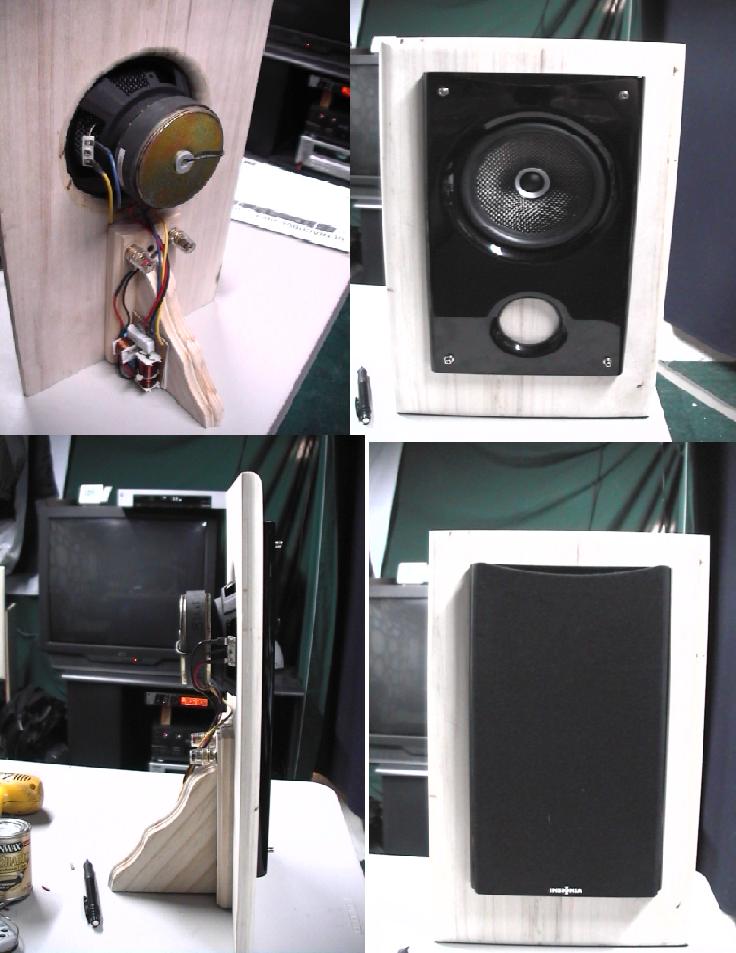

Insignia, cheap enclosure, cheap speakers, embarrassing crossover and yet they sound ok.
But in OB with a DEQ2496 flattening them out and a U-frame Dayton IB 15" filling in below 150 hz they are a whole new level of budget sound quality except for the Daytons of course . For about 35 bucks you can get all of the parts needed for the OB conversion plus the $35 I spent on the speakers themselves, it is pretty sweet.
I have yet to eq the whole range as I am waiting on the ECM8000 to arrive but using an spl meter and a signal generator I manually did the 150-400hz range and wow! W/o eq the rolloff at ~250Hz heavily suppressed male vocals so if you want to try this you need eq or wide baffles I used 11.25" wide since that was the width of the solid wood pieces at home depot (15" tall).
I'll be staining them a dark mahogany tomorrow.

Hi nunayafb,
do you use these babies close to the back wall or coner of the room?
